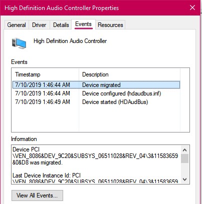

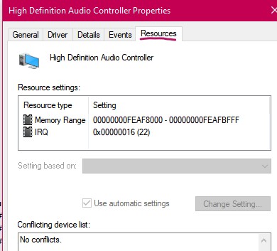

    I really expected to see one of them w/o Resources & hoped it would resolve like Jerome said. I'll look around some more tomorrow. I guess your problem is not with those devices, but...
    (1) Are their drivers the same as mine, especially the one that seems to do nothing?
    (2) What about their Events tabs...?...
    Device PCI\VEN_8086&DEV_9C20&SUBSYS_06511028&REV_04\3&11583659&0&D8 was migrated.
    Last Device Instance Id: PCI\VEN_8086&DEV_9C20&SUBSYS_06511028&REV_04\3&11583659&0&D8
    Class Guid: {4d36e97d-e325-11ce-bfc1-08002be10318}
    Location Path:
    Migration Rank: 0x0
    Present: true

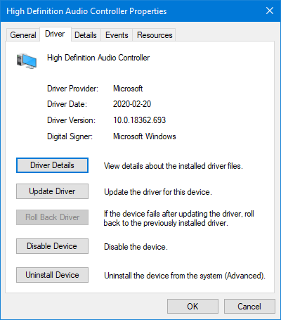

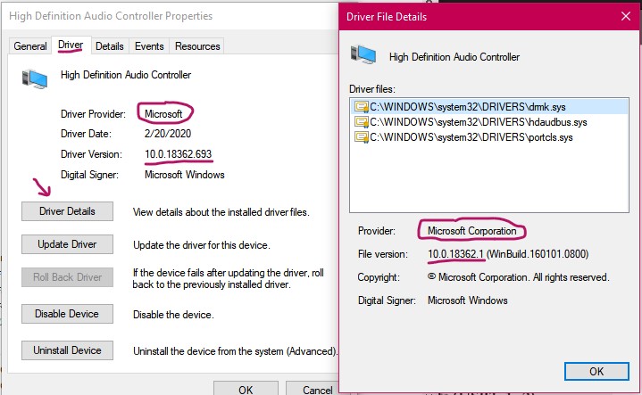

    2020-04-02T00:32:31+00:00
    Bus 0 and 1 System Devices both have identical drivers as shown above.
    For events:
    Bus 0:
    Device PCI\VEN_8086&DEV_A348&SUBSYS_68931849&REV_10\3&11583659&0&FB was configured.
    Driver Name: hdaudbus.inf
    Driver Date: 02/20/2020
    Driver Version: 10.0.18362.693
    Driver Provider: Microsoft
    Driver Section: HDAudio_Device.NT
    Driver Rank: 0xFF2006
    Matching Device Id: PCI\CC_0403
    Outranked Drivers:
    Device Updated: false
    Parent Device: ACPI\PNP0A08\0
    Bus 1:
    Device PCI\VEN_10DE&DEV_0FBA&SUBSYS_8C921462&REV_A1\4&174d0e5f&0&0108 was configured.
    Outranked Drivers:
    Parent Device: PCI\VEN_8086&DEV_1901&SUBSYS_19011849&REV_0A\3&11583659&0&08
    For the actual events it's just a list for both of deleted, started, configured over and over from uninstalling so many times.
    If there's any other information I could provide let me know. Thanks again.

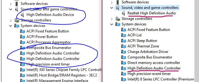

    Neither is what we are looking for: VEN_8086 is Intel and VEN_10DE is nVidia.
    Open the computer case, take out the coin battery and erase the cmos. Boot into bios, and load/save the default setting. Hopefully that will jolt the OS to see the onboard audio chip.
    2020-04-02T04:04:47+00:00
    I don't know whether your suggestion is a cure. But don't expect to see Realtek under System Devices. Mine is also VEN_8086 with the same Microsoft drivers as his & works fine.
  5. JosephT71 9,220 Reputation points
    2020-04-02T04:28:02+00:00
    That device is not an actual audio device. It is the southbridge pathway created by the CPU to transmit the Intel HD Audio Protocol to the actual realtek chip. There used to be a separate southbridge chipset, but Intel put the southbridge functions (now called PCH) inside the CPU as the CPU die shrinks.
    https://devicehunt.com/view/type/pci/vendor/8086/device/A348
    Also after you reset the bios to default setting, "scan for new hardware" in device manager to see if the actual realtek chip would show up in sound, video and game controllers.
