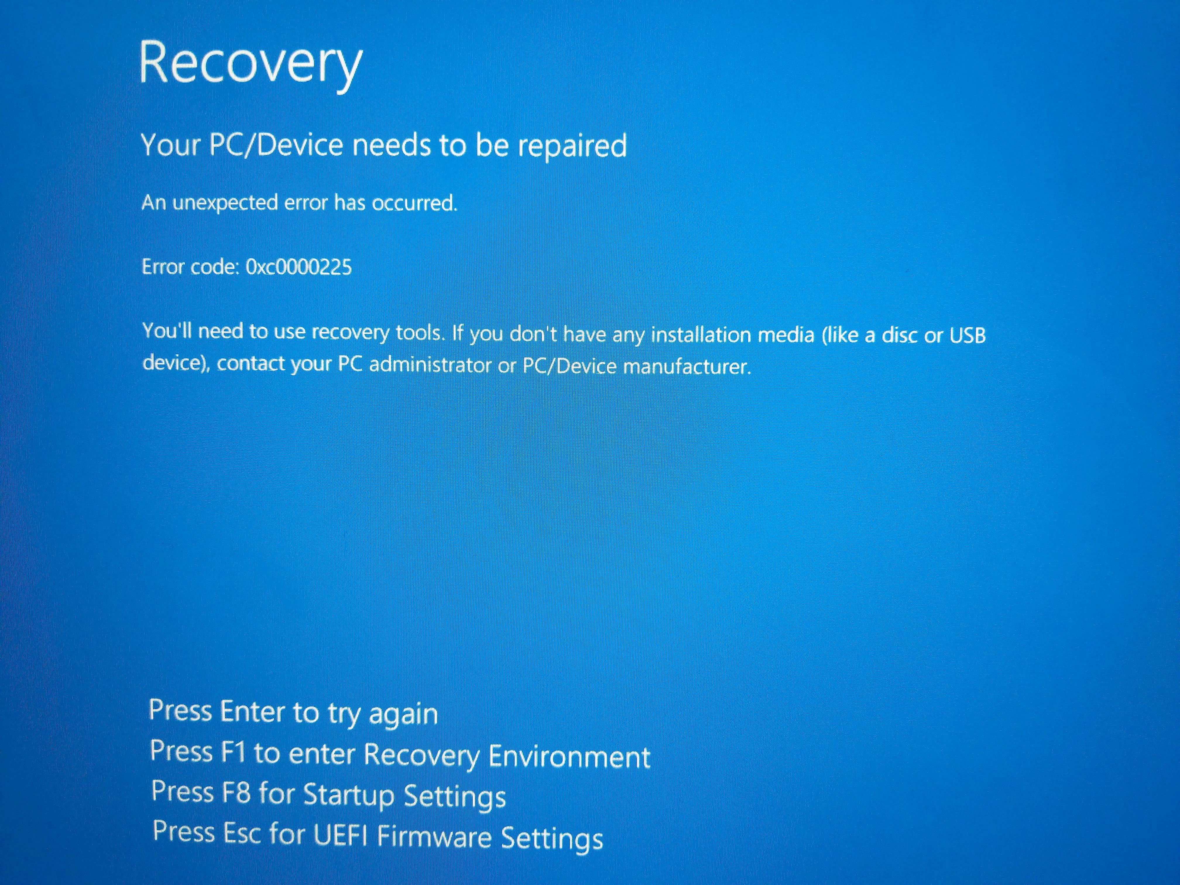

    I have an issue that I believe is tied to this update as well.  I'm on a Lenovo laptop, I7 processor, Windows 10 home.
    I started the laptop this morning and received the blue recovery screen.  However, none of the options on the recovery screen do anything.  I have a USB recovery drive and even when I plug that in and try to boot into recovery mode nothing happens.
    The laptop installed this update mid week but we just shut down on Saturday night so when I logged in this morning this was the result.
    I can't even get to any screens that allow me to get into my system to be able to uninstall this update.  Anyone else having this type of issue or does anyone have any workaround to get back into the system?

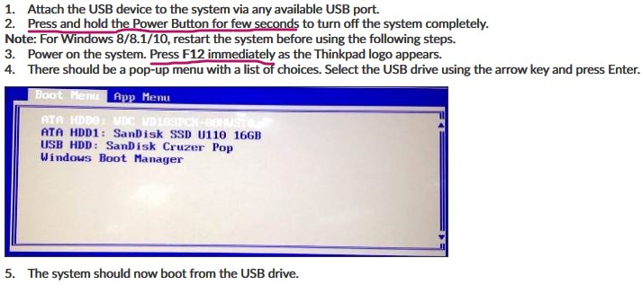

         For a Lenovo, the PF key for the Boot Options menu might be PF12, but varies by model.

    2a. I mean I cannot boot to it.  I can select the option to enter recovery mode from the screen shot I sent but when I do nothing happens.  Even when I try to boot to it from a shutdown, nothing happens.

    (1) When you press F1 on that screenshot, it tries to go to a Recovery Partition. It won't be there, if you chose to delete it at the end of making your USB Recovery drive.

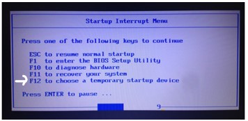

    (2) I think the 1903 USB Recovery drive should boot & work. Plug it in, turn on the computer, & try PF12 at the Lenovo logo. You may have to press & hold it. Or maybe you have to repeatedly press/release it. When at the Boot Menu screen, select the UEFI option, if two are offered for the USB drive.
