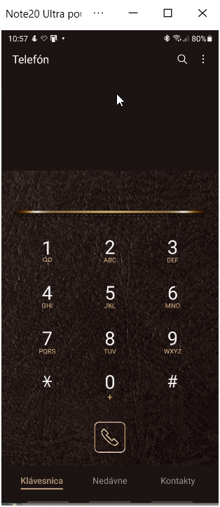

    Hello there,
    well not sure but I have similar problem to the mentioned.
    I have Lenovo ThinkBook G2 ITL laptop with Your phone app installed.
    Then I have Samsung Note 20 5G connected via mentioned app to Laptop and
    I have Samsung earbuds Live connected to the phone.
    Wenn I want to make a call and hear/talk via earbuds, I can do it two ways:
    1. open the "Phone screen" in Your phone app on Laptop and then as usually doing call on Phone app as shown below, dialing or choosing contact. Then from there while making call click to change the source of the voice to my Earbuds if it is´t choosed automatically.  Then it works.
    Also to make a call on Win 10 I must disable Focus assist in order to make calls.
    1. Dial directly on the phone.
    Notification about ongoing call is shown on Laptop´s screen.
    Doing calls by dialing from "Calls" in Your phone app on Laptop doesn´t work with earbuds and the sound is always in phone only.
    Receiving calls is normal and while my earbuds are connected I can hear and talk over them. Without any problems.
