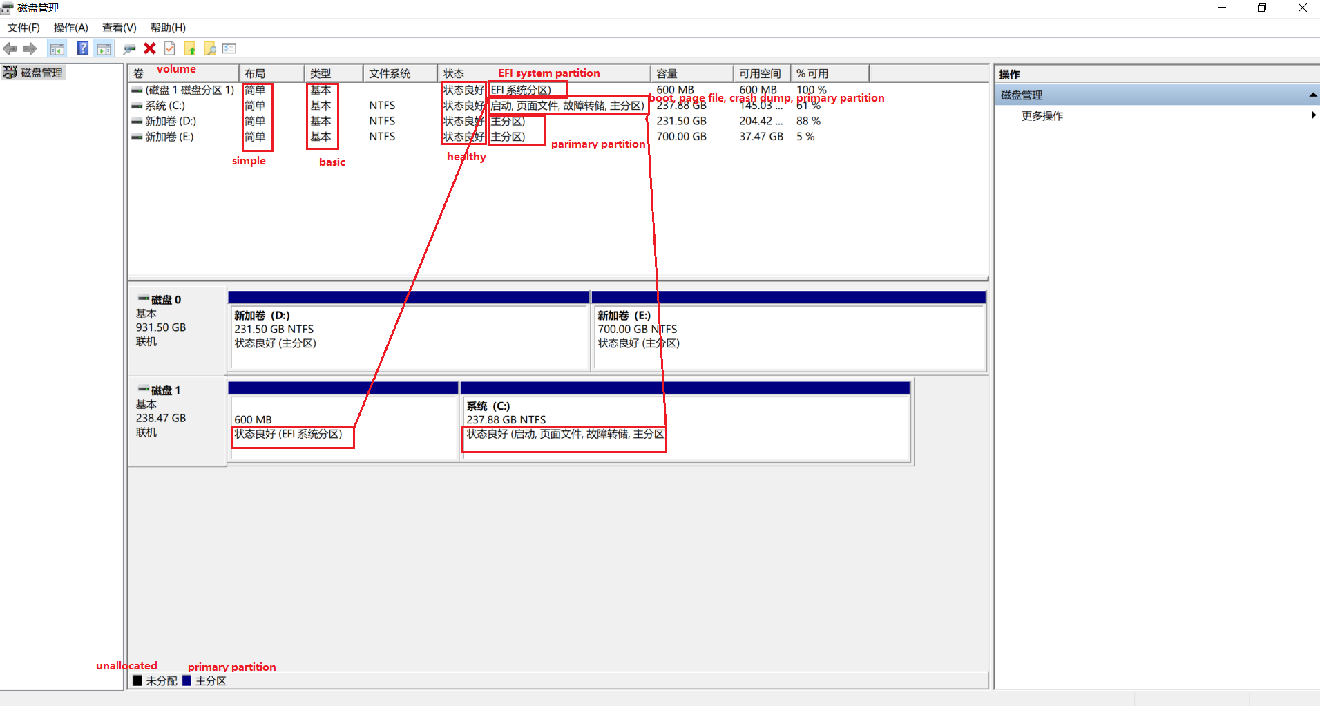

    2020-03-08T16:41:36+00:00
    I really need to see a picture of your Disk Management window..  The below entry is really strange..
    Firmware Application (101fffff)
    identifier              {890f9897-7d40-11e2-8053-9b1bda41daaa}
    device                  partition=F:
    description             Solid State Disk
    2020-03-08T17:26:05+00:00
    This is Disk Management window, sorry Home edition can't switch to English.
