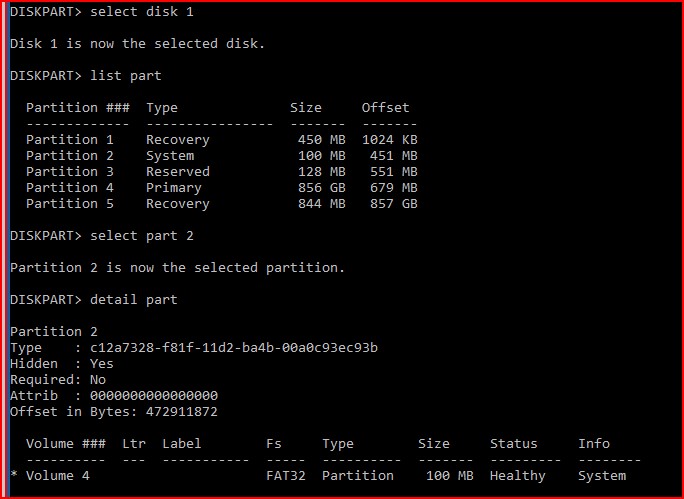

Install attempt fails with error 0x800f0922 whether I run Windows Update  to install this update or run windows10.0-kb4532695-x64_a85fd28af075ebfd8b0753d2c2aca244e926c3ce.msu
Running WIndows 10 Pro Ver. 1909 build 18363.592
I have tried every suggestion by HiltonOishi in https://answers.microsoft.com/en-us/windows/forum/all/failed-install-attempt-error-code-0x800f0922/c5eb31d7-f04f-4ff8-9d6f-f39e4f03944b
After the update installs I restart the computer and when it reboots it gets to 93% in "Working on Updates" then I get "We couldn't complete the updates Undoing changes"
Windows Update says this is an optional update. Should I just ignore the problem till the next update?
