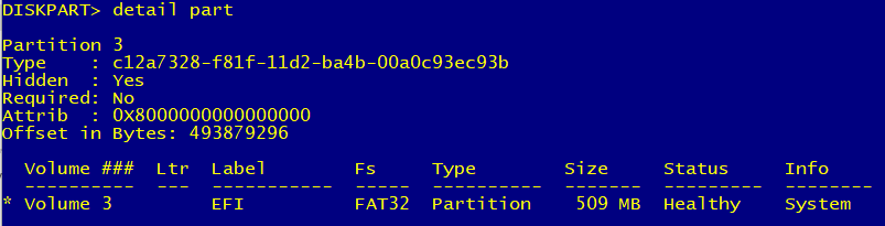

    Yes!! Thank you so much! I had to use the override parameter which was a little worrying but I was basically ready to reinstall anyway so I decided to risk it. and yeah, "set id=c12a7328-f81f-11d2-ba4b-00a0c93ec93b override" worked perfectly. I'm fully updated on the slow track now

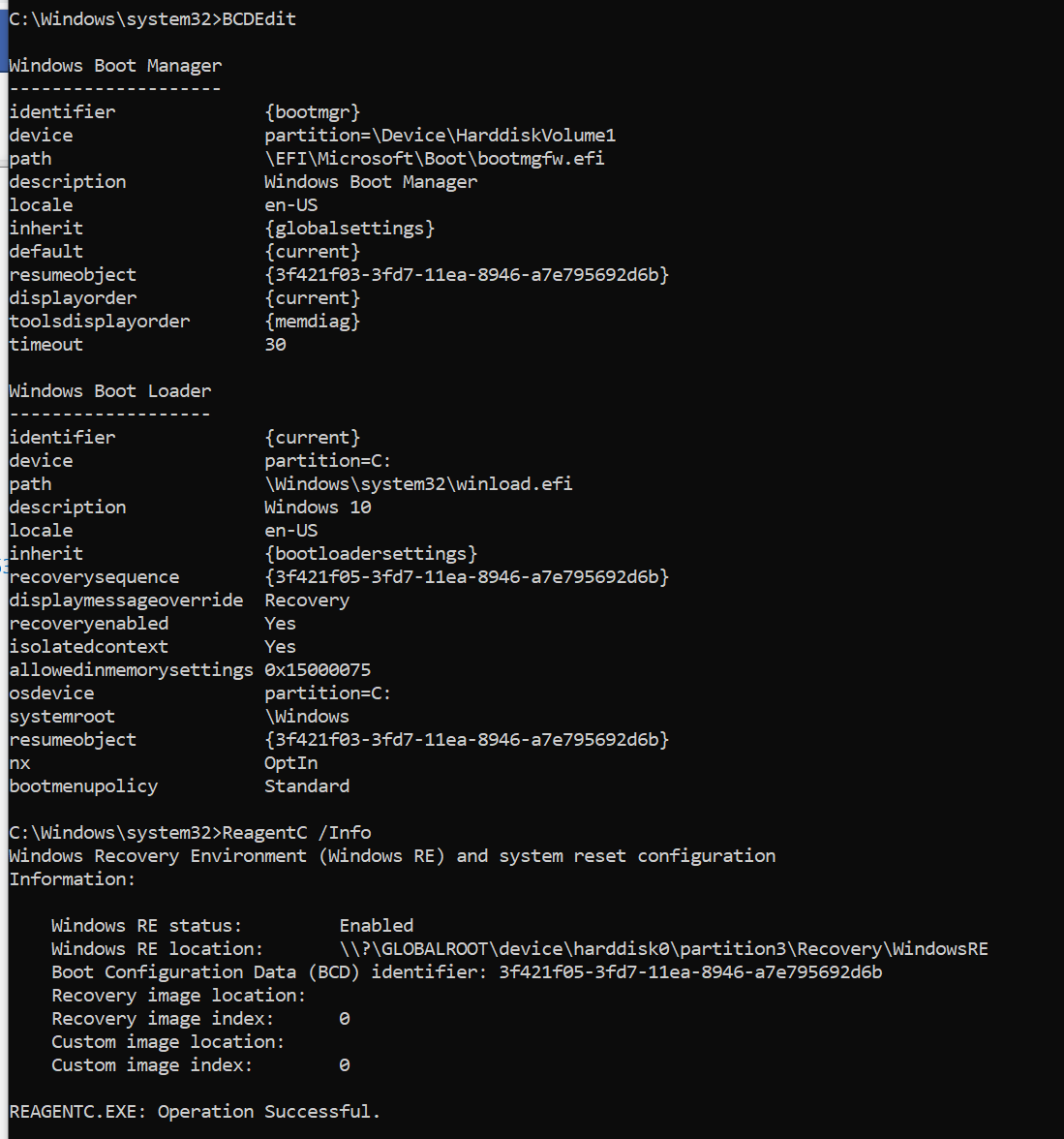

    Here is what her boot manager looks like:

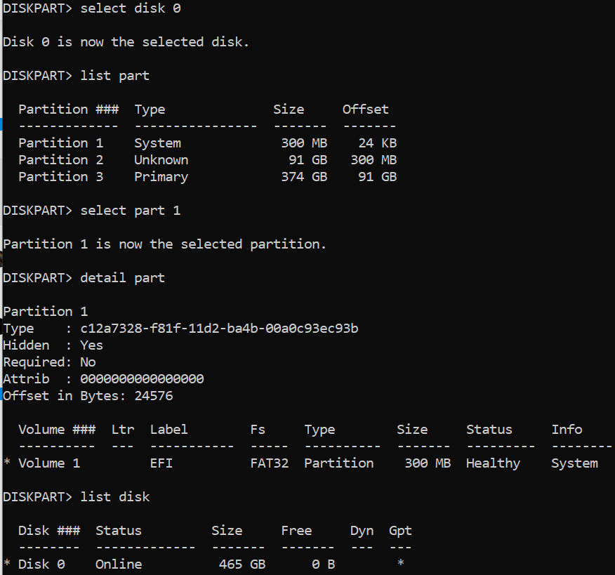

    And here's what her diskpart looks like:
    I notice that the Windows Boot Manager thinks that "HarddiskVolume1" is the "device" that it should be looking at.  But does it know to correctly look on "Disk 0"  ?
    (Note that EFI Partition 1 is indeed the **"**c12a7328-f81f-11d2-ba4b-00a0c93ec93b" GUID so I don't think that's my specific issue like it was the previous poster's.)

    For what it's worth, the only thing that looks different in what you show from what I have is that in my case the EFI partition shows attrib 0X8000000000000000 (and I have a differently sized EFI partition).

    (1) HarddiskVolume1 is the 1st partition on Disk 0. It begins counting with the partitions on Disk 0 & progresses to the other disks, if any.
    (2) HarddiskVolume3 is your 3rd partition on Disk 0. It is your Windows partition. ReagentC shows it also contains your Recovery Environment (to which Shift+Restart will boot). Normally, that would be in a partition of its own, but I suppose Bootcamp wanted it this way. It could happen this way in other circumstances as well. When I briefly dual-booted, the second Windows installation was like that. (The first kept its existing Recovery partition to itself.) It updated OK, so I doubt that's the problem.
    (3) I suppose that unknown partition 2 of 91 GB is your wife's "MBA" which I suppose is Apple's OS. I don't know why it intercedes between EFI & Windows. Doesn't seem right, but I know nothing about it.
    (4) You are right, the issue for you is not that EFI has a wrong type ID. That's the right one. Normally, the size of EFI these days is 100 MB, but 300 MB is OK too. Maybe Bootcamp wants it that way, I don't know. But I would give it GPT attributes that looks like helzayat's & mine this way...

    But it just doesn't sound like that is a solution to the update failure. Also, I don't know whether Bootcamp wants it that way.
    (5) What I like least is that you are missing the MSR (Microsoft Reserved) partition. These days it is 16 MB & located just before the Windows partition, if Windows creates it during a clean install. It used to be 128 MB. All GPT disks are supposed to have one...

    (6) Do you have other disks & does any have another EFI partition on it? That could confuse Windows during a reboot to complete the installation of an update.
