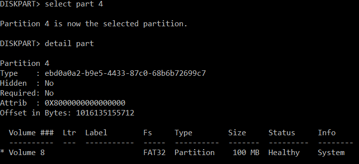

    I think this might be my issue, as this is what I see:
    how would I go about changing the GUID?

    You don't seem to have an EFI partition (Type System). Are you using UEFI or Legacy boot? Run msinfo32.exe and look at "BIOS Mode" under "System Summary".

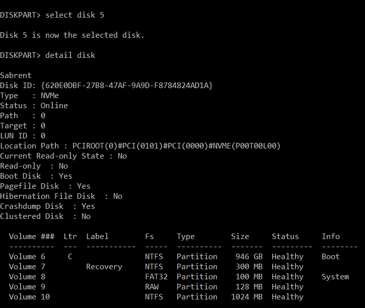

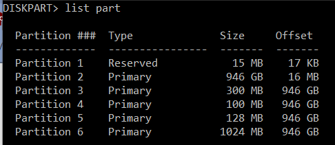

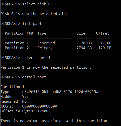

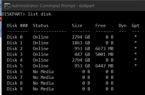

    I'm sorry, I'm really dumb, that was the wrong drive. Unfortunately the correct partition (i think) is still showing a different (incorrect?) GUID
    I had to dig just a little to actually make sure I was selecting the right drive, and I think I found the system partition on it? For me, disk 5 (the only nvme drive) was the os/boot drive, so:
    I'm almost positive this is the correct partition, with an incorrect GUID.
    Is changing the GUID a thing you can even do? My google skills are letting me down on this one

    In diskpart select the disk and partition you believe is the EFI partition and
    set id=c12a7328-f81f-11d2-ba4b-00a0c93ec93b
    You may also want to check the contents of the partition. You can assign a letter to the volume so you can look at it in Explorer:
    select volume 8 (assuming your last image is correct)
    assign letter=S
    then exit diskpart and explore drive S:. You should have a folder called EFI containing two folders, Microsoft and Boot.
