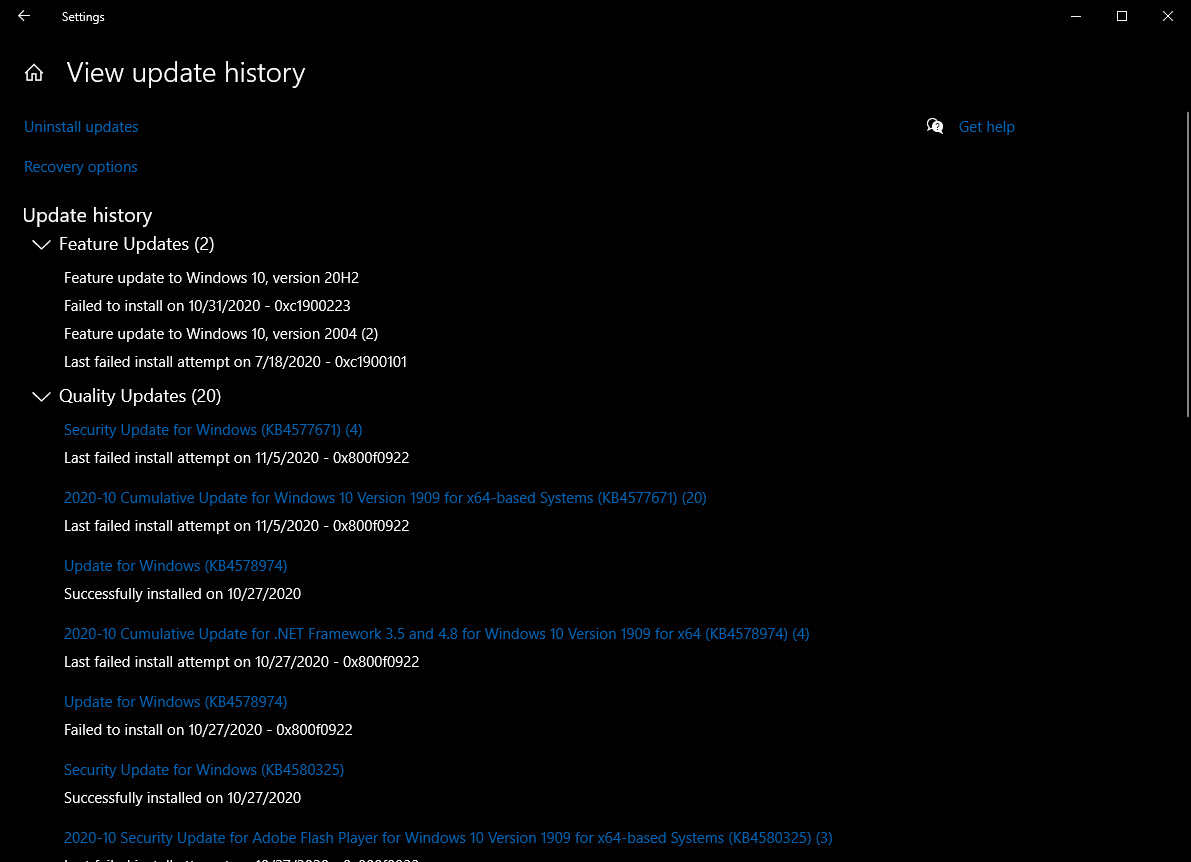

Install attempt fails with error 0x800f0922 whether I run Windows Update  to install this update or run windows10.0-kb4532695-x64_a85fd28af075ebfd8b0753d2c2aca244e926c3ce.msu
Running WIndows 10 Pro Ver. 1909 build 18363.592
I have tried every suggestion by HiltonOishi in https://answers.microsoft.com/en-us/windows/forum/all/failed-install-attempt-error-code-0x800f0922/c5eb31d7-f04f-4ff8-9d6f-f39e4f03944b
After the update installs I restart the computer and when it reboots it gets to 93% in "Working on Updates" then I get "We couldn't complete the updates Undoing changes"
Windows Update says this is an optional update. Should I just ignore the problem till the next update?

    That is so weird Norton won't go even with their own removal tool. Definitely, SetupDiagResults.log should read as mine: RegisteredAV = Windows Defender. And I see it is the same error message twice more for you whether you attempt 20H2 or 2004. At least, that's what I see in the .log. (I know you said otherwise: "v20H2: returns error 0xc1900223". But that one only means to try again later.). And you did everything those quick fixes said to do & even did a clean boot. Sheesh.
    A clean install has got to rid you of Norton for sure. You should make a Windows system image backup to one of those dynamic disks of yours first. It will be the only undo you'll have (except for another clean install of 1909). Be sure you know how to restore an image too.

    I've been around long as you, but went from Win 98 (on a Compaq 7470) to Win 8.1 on this Dell Inspiron 3542. Then I went through all the upgrades fairly nicely to 20H2. Along the way was just one clean install only to rid me of a bunch of Dell add-ons that were duplicative of what Windows already had, but I can't hate Dell. And I wasn't fully rid of McAfee till then, either, though I ran their own removal tool like you.
    I've seen an 0xc1900223. It means only to try again later, which you did. In the .log it was the same  0xC1900101-0x40017 as before. And you've done everything under the sun right to fix it, but it just won't fix.
