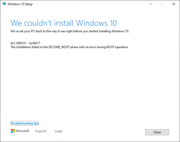

    KB4577671: returns error 0x800f0922
    v2004: returns error 0xc1900101
    v20H2: returns error 0xc1900223
    On v2004 installation I was watching (patiently) in front of computer and noticed a blue screen with "SYSTEM THREAD EXCEPTION NOT HANDLED" - assuming it means something to you.
