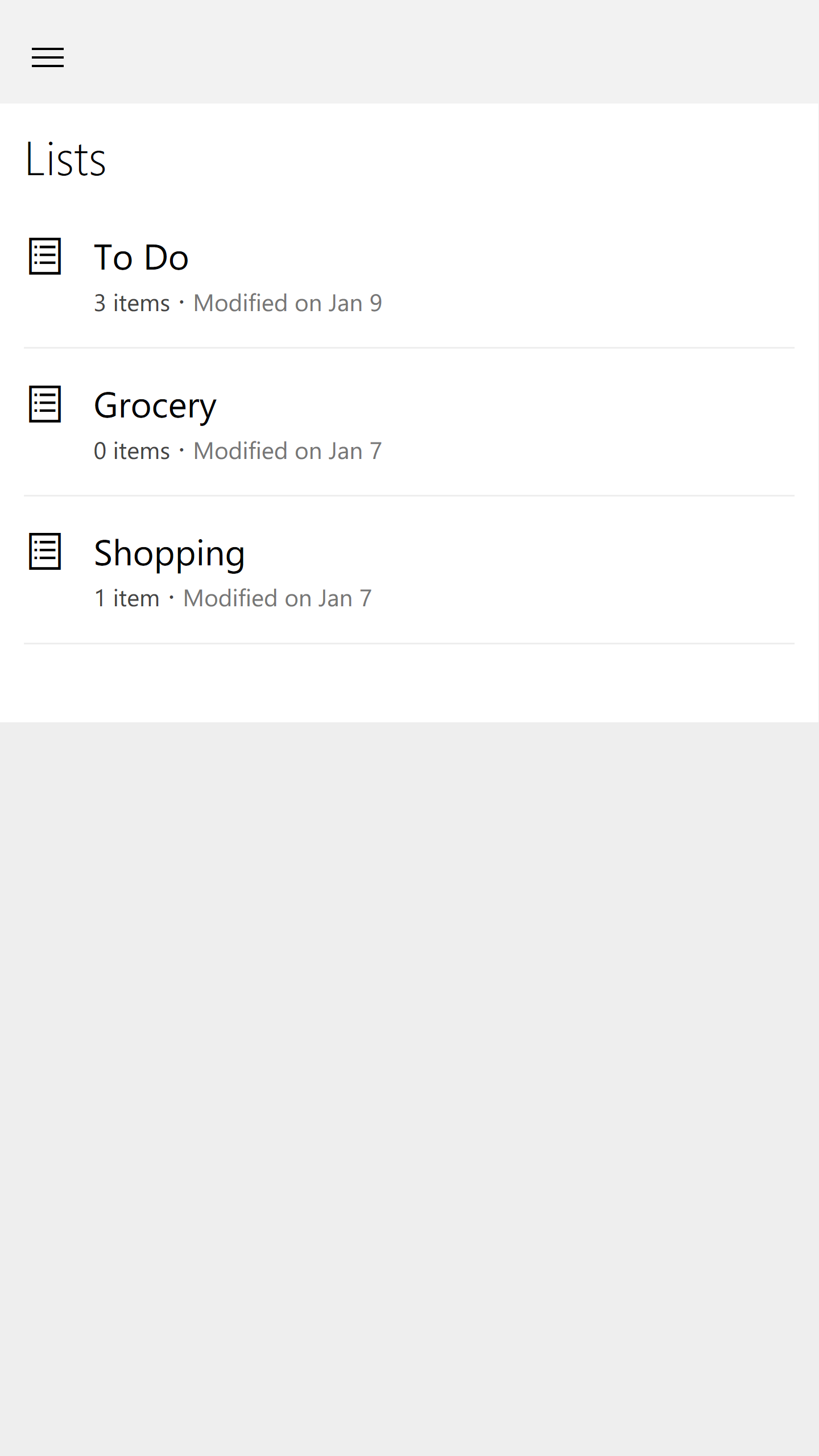

    2020-01-10T19:01:39+00:00
    Try removing the To Do, on PC and Mobile. So it syncs reminders through outlook instead of To Do. I think To Do can't do location based reminders. Also in the Cortana notebook go to lists and To Do is there anyway.
    Screenshot:
