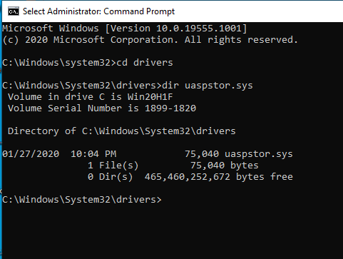

EDIT: This appears to have now been fixed in the following build
https://blogs.windows.com/windowsexperience/2020/01/30/announcing-windows-10-insider-preview-build-19555/
It looks like this issue is acknowledged in the 'Known Issues' section of the latest Insider build.
https://blogs.windows.com/windowsexperience/2019/11/19/announcing-windows-10-insider-preview-build-19028/
So at least we know Microsoft is aware of the problem and we'll hopefully see it fixed soon. The bad news is, of course, that it's not fixed yet.
