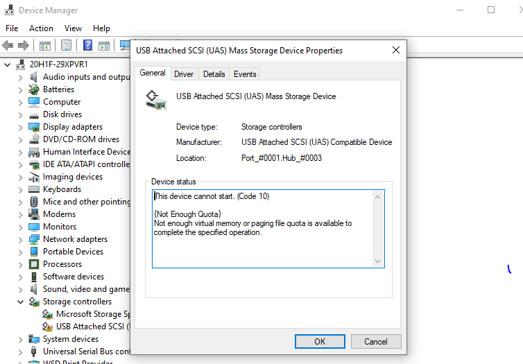

I am using Windows 10 Pro Build 19013.vb_release.191025-1609. Now I cannot use external hard drives.
When plugging external hard drive I can hear the sound of something is connected. But, the drive never displayed in This PC.
Checking Disk Management, the disk is not even there.
Checking Device Manager, one device is malfunction: USB Attached SCSI (UAS) Mass Storage Device.
The device status is:
This device cannot start. (Code 10)
{Not Enough Quota}
Not enough virtual memory or paging file quota is available to complete the specified operation.
I don't understand this error.
2019-11-22T00:42:35+00:00
EDIT: This appears to have now been fixed in the following build
https://blogs.windows.com/windowsexperience/2020/01/30/announcing-windows-10-insider-preview-build-19555/
It looks like this issue is acknowledged in the 'Known Issues' section of the latest Insider build.
https://blogs.windows.com/windowsexperience/2019/11/19/announcing-windows-10-insider-preview-build-19028/
So at least we know Microsoft is aware of the problem and we'll hopefully see it fixed soon. The bad news is, of course, that it's not fixed yet.

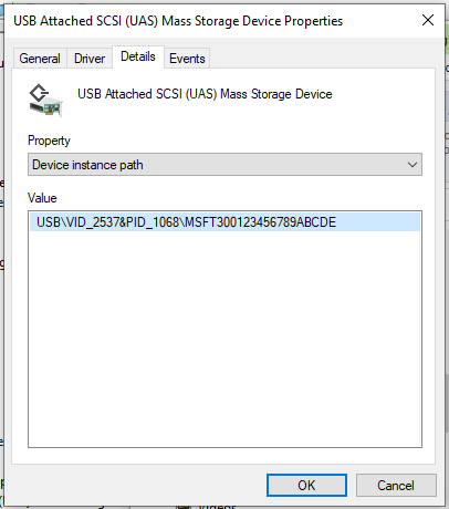

    Here is a sample of an iDsonix enclosure (NS106X) that uses 2 different drivers on USB 2 with (usbstor.sys) and USB3 with uaspstor.sys.
    With this particular device the bug is only occurring when connected to a USB 3 port, see below the error with build 19551.1005.
    The same device works fine with current public build v 1909  build 18363.592 (uaspstor.sys 18362.387 dated 10/6/2019), any uaspstor.sys of insider builds fails with the error shown in the last picture below.
    Device connected on USB 2.0 port:
    Device connected on USB3.0 port.
