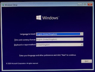

    I have managed to boot from the USB flash drive, and it displays a Windows Setup window, as per the following image:
    But I am a little confused as to what to do next. What should I do / select from this window? Or should I just turn off the PC, reconnect the HDD, change the boot sequence to boot from the HDD again, and see if it will boot from the HDD?
    How were you able to access the "boot drive" (is that the HDD?) and rollback the Windows 10 upgrade via the recovery options, if you were booting from the USB recovery disk?
    I might need detailed steps, as I am a bit of a novice. :-)
    Any further help you can provide is greatly appreciated! Many thanks!
    2020-11-28T14:12:38+00:00
    Hi Yash,
    great the rollback worked.
    My USB recovery stick booting the sata drive attached via usb gave me the option to repair the startup and to rollback the update.
    In my case, I simply booted from the rolled back HDD attached back to the SATA without the recovery USB Stick and it booted just fine.
    Later I removed the Lenovo backdoor stuff 1. from the security entry in the bios settings and later on on the windows directory. After that the upgrade to the 2004 update runs smoothly. Found this after reading thru the whole thread in here - sorry don‘t remember the name of the author.
