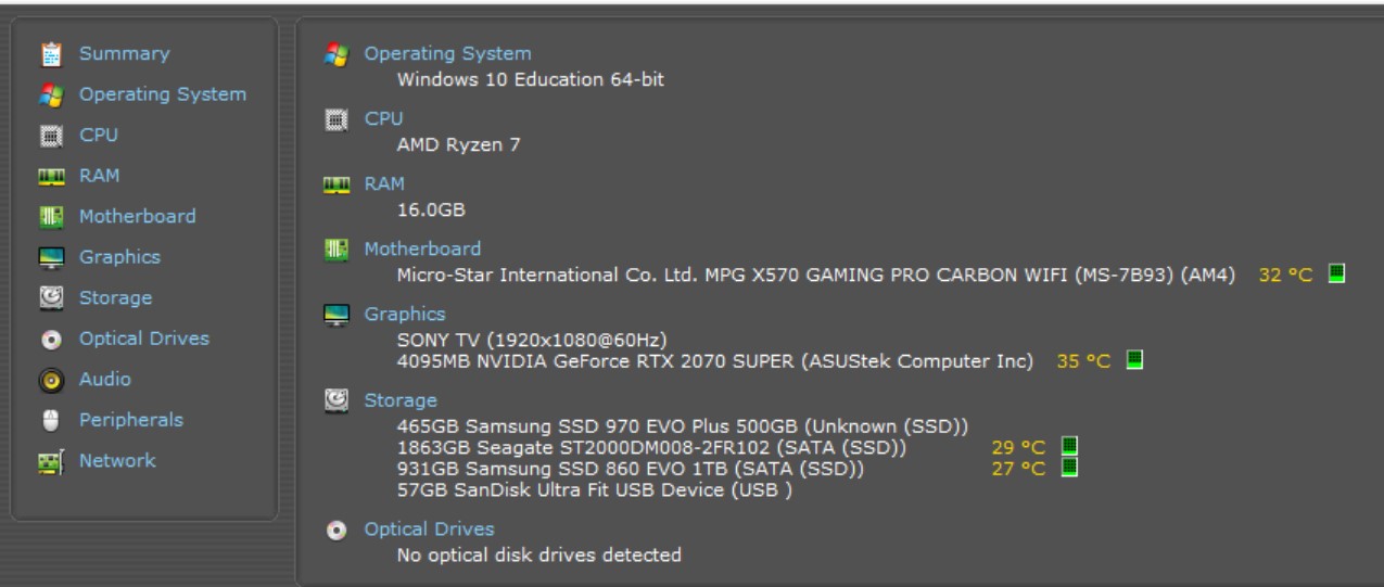

I recently built a new computer and installed windows 10 on it. After I the first hour or so I started experiencing a system-wide stuttering. It happens while I play games, it happens while I watch Netflix, and it is happening while I type this. It makes any kind of media playback worthless. The audio and video are both effected during the stutters which last less than a second but occur about every 1-2 seconds. I have fully updated all my drivers including the bios, altered power settings, and other things mentioned in some of the older posts on this topic. I've included this snapshot of my setup since it seems to be a popular request on the older forums at least. I am wondering if there are new solutions since none of the ones that have been mentioned in the past have been helpful.
