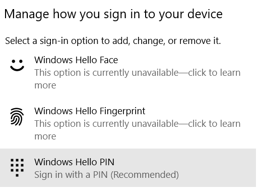

    I am having the same issue as the original post stated. My computer's fingerprint reader was working properly until the update from windows that installed the "Hello" version of the login options.  In fact when I go to sign-in options the Windows Hello Face and the Windows Hello Fingerprint both say "This option is currently unavailable - click to learn more".  I have clicked on several occasions and it leads me through the same steps of checking for up to date drivers and I am always given the message "The best drivers for your device are already installed".
    I have the Windows 10 version 1903 (OS Build 18362.592).
    My Biometric devices only shows Synaptics WBDI and there is an error symbol over the fingerprint picture.

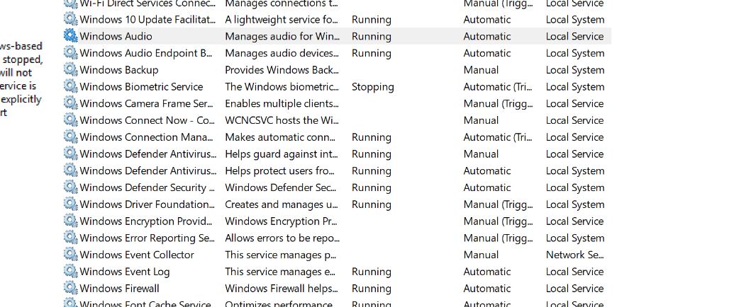

    2020-03-27T13:15:35+00:00
    Now, select Automatic from the drop down for Startup type.
    Here in my case Status is still displayed as STOPPING

    Hi. My windows hello face/fingerprint option is currently unavailable. Can you please assist with this thanks
