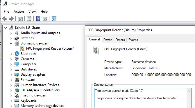

    Hello.  At the time this started I know it had just done a Windows update.  I'd have to look back at my original post, I think at that time it was version 1908.  My current version is 1909.  I checked for hidden biometric drivers and there are none.  I've done the driver update and it says I have the latest driver.  I have an LG Gram laptop and as far as I can tell I have the latest driver (I don't find the driver specifically on their website but they have a LG Update Center app on the laptop that says I'm up to date).  Under Services.msc it was already set to Automatic.
    Here is what it says under Device Manager.
    I would love to be able to use my built in fingerprint reader again.  It was one of the main features of the laptop.
    All help is appreciated.  Thanks
