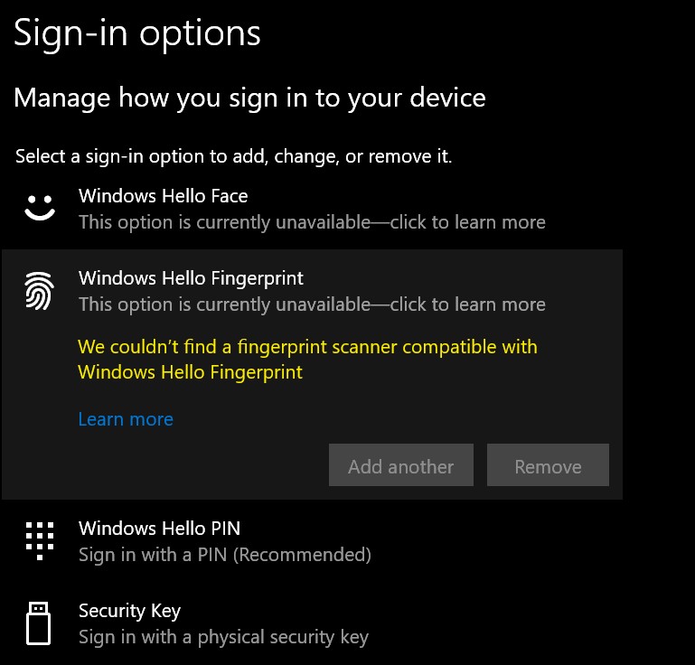

I have a problem with windows hello on my laptop. In the normal settings, it says "We couldn't find a fingerprint scanner compatible with Windows Hello Fingerprint".
This problem has been around for about a month a half now, hoping that a software update would fix it. It hasn't been fixed. My laptop is a hp envy x360 convertible ds-0xxx. This laptop has a fingerprint reader on it, and it worked for when I got it.

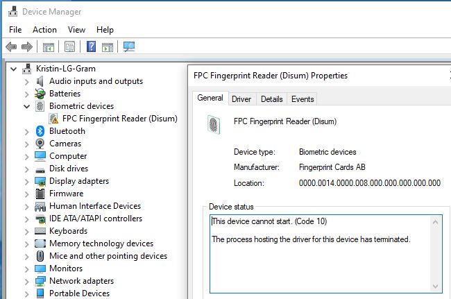

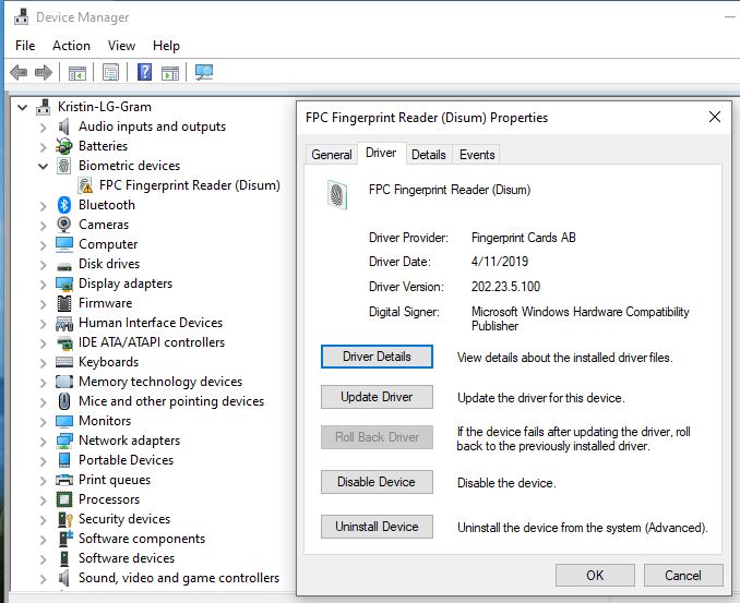

I had the same problem as everyone else and finally decided to try and fix the problem.  Under my device manage I had the little yellow triangle that signaled an error of some sort.  Synaptics WBDI SGX was the driver name.  Tried everything listed in the various replies of this thread without any luck.  I even tried updating the drivers and got the message that they were already up to date.  Finally I decided to try a different update that I had dismissed previously and it worked instantly!
What I did that finally worked was this:
windows + X
click on device manager
right click on the driver under Biometric Devices (If it is hidden click view and then show hidden devices to see it)
click update driver
click the SECOND option which says BROWSE MY COMPUTER for drivers. (The first option just told me the best drivers were already installed.)
Click let me pick from a list of available drivers on my computer
Click the driver listed.  (I only had one listed and it was the same as the one I was trying to fix Synaptics WBDI SGX)
Click next
Let the install complete.
At this point my yellow triangle vanished.
I then went straight to my sign in options setting screen (which you can type in the search bar for easy access) and when I clicked windows hello fingerprint it said it was ready for me to use!  No restart required.
I share this in the hopes that it helps someone else who had no luck with any of the other methods listed.

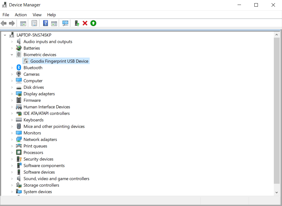

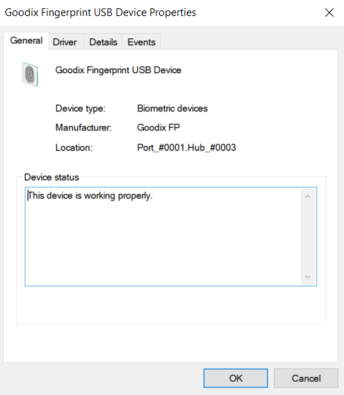

    Hey there!!! I had this same problem with my device too...fingerprint was working properly until today morning...I tried all of this...but then none of them worked for me...soo try this too...if the other ones don't work for you...
    1~ Press Windows Logo key + X, and select Device Manager.
    2~ Double click Biometric devices.
    3~ Then you might find the Goodix fingerprint device.
    ( when I double-clicked the goodix fingerprint device it showedwindows has stopped this device because it has reported problems. (code 43) )
    4~ Right-click the goodix fingerprint device and disable it.
    PLEASE NOTE:- Don't click uninstalled click disable.
    5~ Click on the goodix fingerprint device again and at the top tabs, you might find a green color arrow mark called " Enable Device".
    6~ Double click Goodix fingerprint device.
    7~ If you find this message click your account and check sign in options and check windows hello fingerprint and there you go! you have got it back!!!!
    let me know if it works!!!

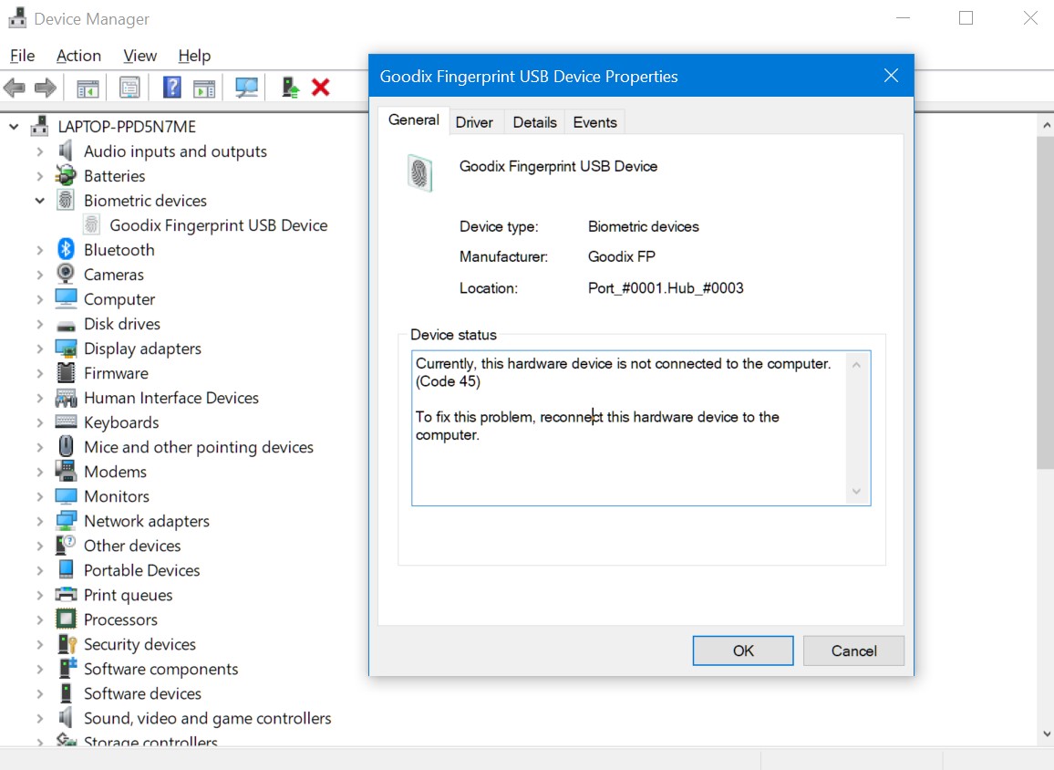

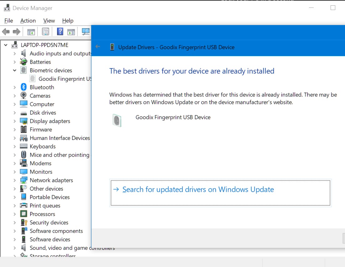

    I'm using a Huawei D15 laptop. I just opened it and all of a sudden the biometric/fingerprint option is gone.
    I checked the setting and it says "We couldn't find a fingerprint scanner compatible with Windows Hello Fingerprint".
    I also did what you advised to to do in Device Manager. I was able to find the device but it says that the "The best drivers for your device are already installed.
    I checked the properties and now it says: "Currently, this hardware device is not connected to the computer. (Code 45)"
    I haven't made any changes to my laptop and I don't know why it is saying that.
    I hope you can help me with this.
    Please see the screenshots for reference.
