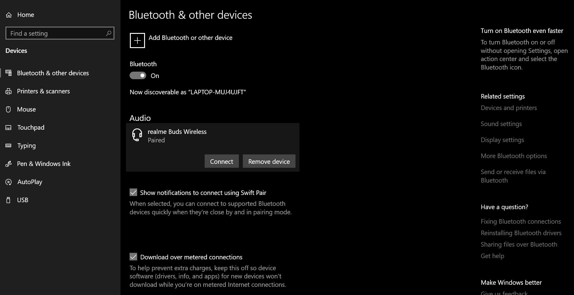

I bought Realme buds wireless bluetooth earbuds recently. I started using them with my phone and it worked just fine. But when I used it with my laptop (Asus FX570UD) it works for sometime and then automatically disconnects and the same problem persists when I reconnect it again. I tried troubleshooting but it is of no use. I need help with why it keeps disconnecting frequently??
