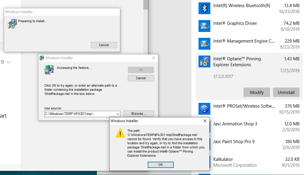

    2019-10-29T16:57:46+00:00
    Hi there.
    I still have a problem with fixing my PC.
    Option "Modify" have not helped.
    Windows Installer can not fine correct path (please see below pop-up windows).
    Will you please assist?
    Kind Regards
    Piotr
