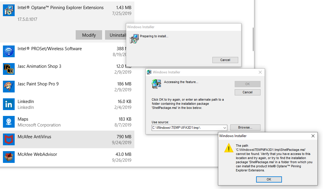

    The following solution that BillConstable1 described worked for me:
    open the system Settings menu
    select Apps
    select Intel Optane Pinning Explorer Extensions
    click Modify (you may see a quick flash, and you may think nothing happened, but the error should be gone)

    The following solution that BillConstable1 described worked for me: it's a quicker, simpler alternative to the more extreme answer that DaveM121 gave....
    https://answers.microsoft.com/en-us/windows/forum/all/intel-optanetm-memory-pinning-unable-to-load-dll/f144a8d9-f81b-45d2-a9d5-2a5575fe6ce1?msgid=a1343287-01a3-4bb2-bc25-35f93592b178&tab=AllReplies#tabs
    1. open the Windows10 system Settings menu
    2. select Apps
    3. select Intel Optane Pinning Explorer Extensions
    4. click 'Modify'  (you may see a quick flash, & you may think nothing happened, but the error should be gone)
