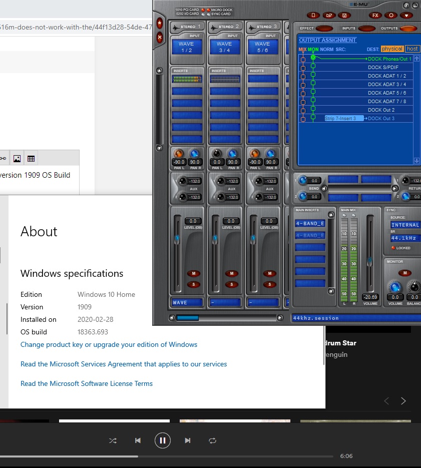

E-MU 1212m/1616m - Complete Install Guide for Windows 10 (1903)
This is a complete guide to setting up the E-MU 1212m/1616m audio interface on Windows 10 version 1903x64 and above.
It will work for both PCI and PCI-Express and should work with the E-MU 1820/1820m/0404 audio interfaces too but you may need to rename the 2 instances of your device name in the EMU_Driver_Fix script file.
Huge thank you to ClubHouseKey and Martin, Producer at Sherwood Sound Studios whose information saved us and give us compatibility with Windows 10x64 1903. The E-MU 1616m PCI-Express is the audio interface I have and I will never get rid of it unless there is absolutely no way to keep using it. Amazing piece of hardware! If any new updates are posted in this thread then this first post will be edited accordingly.
E-MU 1212m/1616m - Complete Install Guide for Windows 10 (1903 & Above)
*Please perform each task in the exact order listed.*
1.  Remove all current E-MU Drivers and PatchMix software.
2.  Download the E-MU_Windows_10_Install.zip file from   https://1drv.ms/u/s!Ar-KCv7xikVOh23zeXTESuD8k2ih.
3.  Extract the zip file to a folder on your main Windows 10 drive and call it---> "temp". (C:\temp
4.  Install the EmuPMX_PCDrv_US_2_30_00_BETA drivers
5.  RESTART INTO SAFE MODE by holding the shift key when clicking on Restart.
6.  Choose Troubleshoot, Advanced Options, Start-up Settings and click Restart. You will later be prompt with safe mode restart option. Select option 4 in Safe mode.
7.  Once in safe mode right-click on the start button and open Windows PowerShell (Admin).
8.  Type into the PowerShell window --> "cd c:/temp/EMU_Driver_Fix"   or you can right click with your mouse to run the script run with help of Windows PowerShell (Admin).
*Note: On some systems Windows 10 1903 has another security layer even in safemode that forbidd you to run unkown scripts and code. You get then a confrimation message if its okay to run the selected script "EMU_Driver_Fix".  Select "yes" and then the script will finally run for you.
This a modified version of Cl ubHouseKey's script. This will replace our windows files with the new updated files.
*Note: Performing this step in a normal Windows environment will either cause the script to not run at all due to script settings within Windows or some files will not get overwritten because they're in use.
9.  Restart Windows as normally and then install the EmuPMX_PCApp_US_2_20_00 PatchMix Software.
You should now have successfully installed your E-MU Audio Interface and everything will and should work as normal.
Extra ASIOx64 driver
10.  If you plan to use the ASIO x64bit driver in a x64bit DAWs like Cubase Pro 10, Studio One, Pro Tools, Sonar and other x64 environments.
Click on "Start" and type "regedit" in the search bar and click on "Registry Editor" to run it.
11.  Go to    HKEY_LOCAL_MACHINE\SOFTWARE\WOW6432Node\Microsoft\Windows\CurrentVersion\Run
12.  Right-click "AsioThk32Reg" and choose Modify.
13.  Change "CTASIO.DLL" to "CTASIO64.DLL."
I hope this guide helps everyone that wants to keep their 1212m/1616m running in Windows 10 1903.
Big thanks to ClubHouseKey and Martin, Producer at Sherwood Sound Studio that found this solution for us all.
You can find and follow updates of this driver here!
https://www.kvraudio.com/forum/viewtopic.php?t=529349
I hope this helped you all to make the installation of the new driver easy and informative for everyone.
