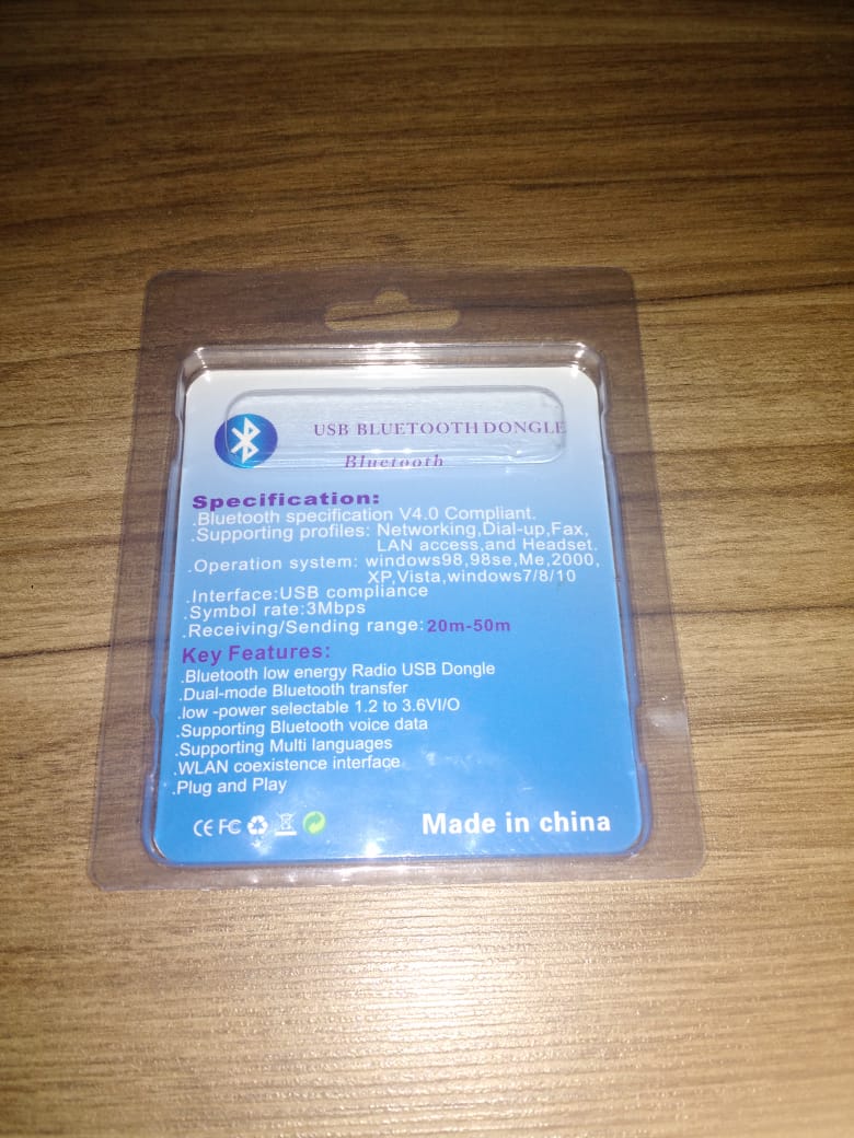

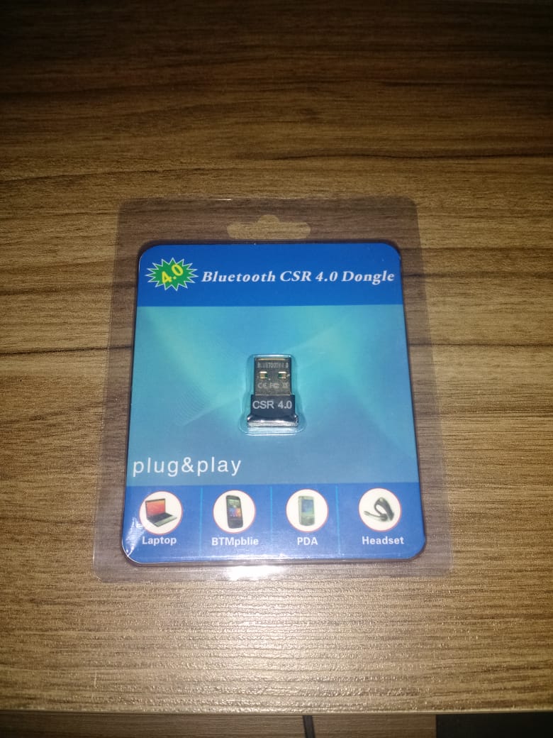

    EDIT: my adapter is the btd-mini 5, but when I download the driver for it the driver for version 4 is downloaded.

  3. Greg Carmack 24,780 Reputation points Volunteer Moderator
    2019-08-30T20:48:47+00:00
    no, mine is 5
    This is the box, and when I looked up the manufacturer along with some information available in this package I found this gembird webpage.
    It's Version 4.0, exact match to the Support page which the driver comes from.
    2019-08-30T21:42:41+00:00
    I thought it was 5 because when I downloaded the drivers there was also a BTD MINI 4, so I thought you were referring to that, not to the bluetooth version.
