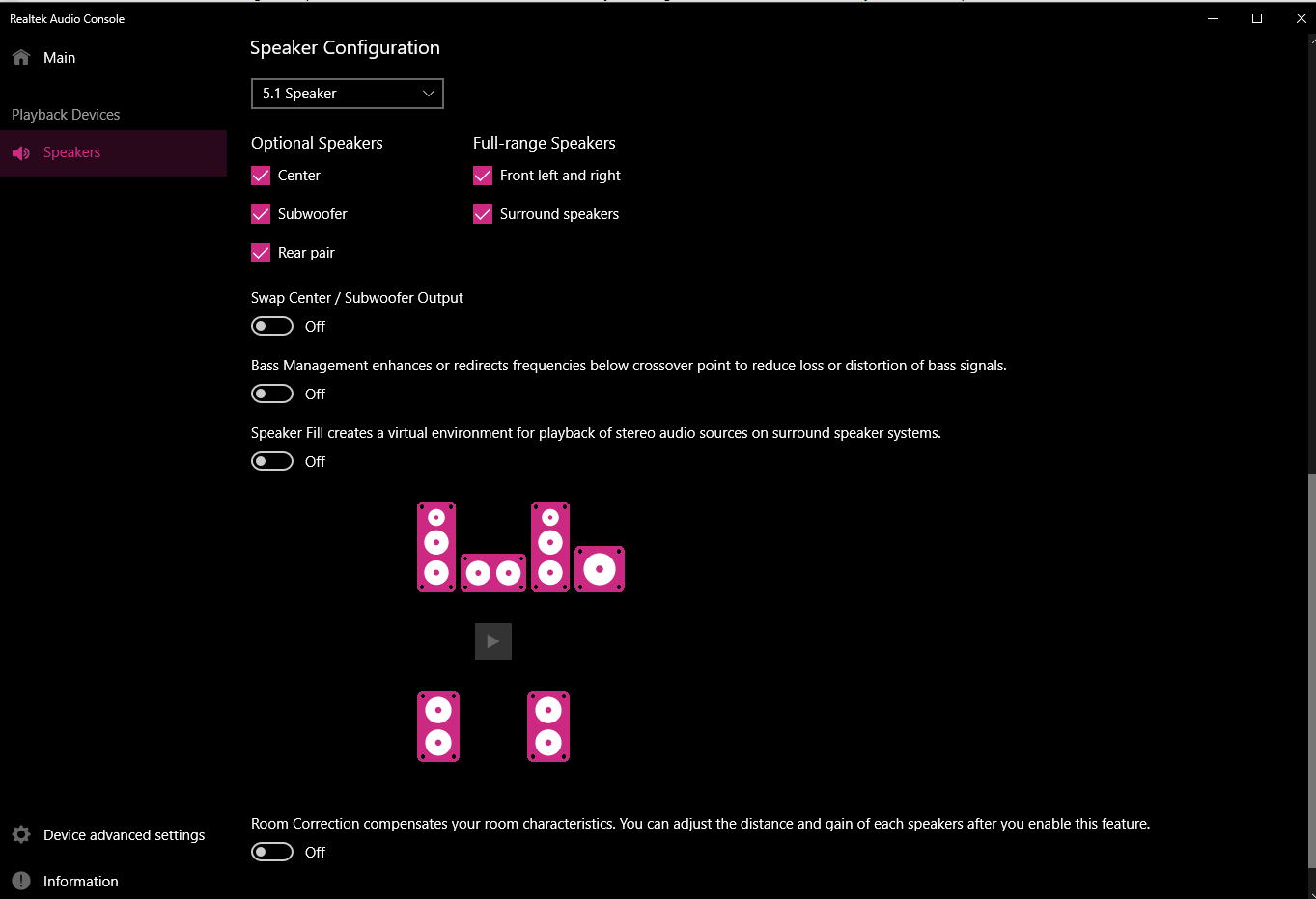

    Every thing works in test. Everything works watching a dvd.  I have the latest codecs.  I built the computer. It decodes Dolby...etc.....  When streaming or playing music that has been downloaded it is in stereo. Just trying to find answers on that. The stereo playing items are encoded with 5.1 but won't play 5.1. Just trying to figure out why. I freely admit I may be missing something simple. Just reaching out to see what I may have missed. As a side note I mentioned I used to be able to "fill" but that driver seems to be a windows 7 deal.
  4. JosephT71 9,220 Reputation points
    2020-10-06T18:00:47+00:00
    1. "Speaker Fill" (aka stereo upmix to 5.1) is a "feature" in the Realtek driver that is enabled or disabled by your computer manufacturer. Nothing to do with Microsoft.
    1. Testing digital optical with test signal --- is testing whether or not your AV receiver can decode Dolby Digital or DTS. It does not mean your computer can decode encrypted Dolby Digital or DTS.
