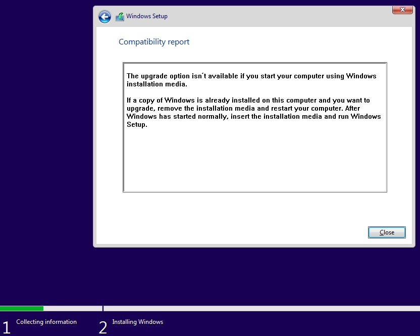

    I thought you could install updates while in Safe Mode, but I will test shortly.  You cannot do an in-place upgrade because it has to be started from Windows.
