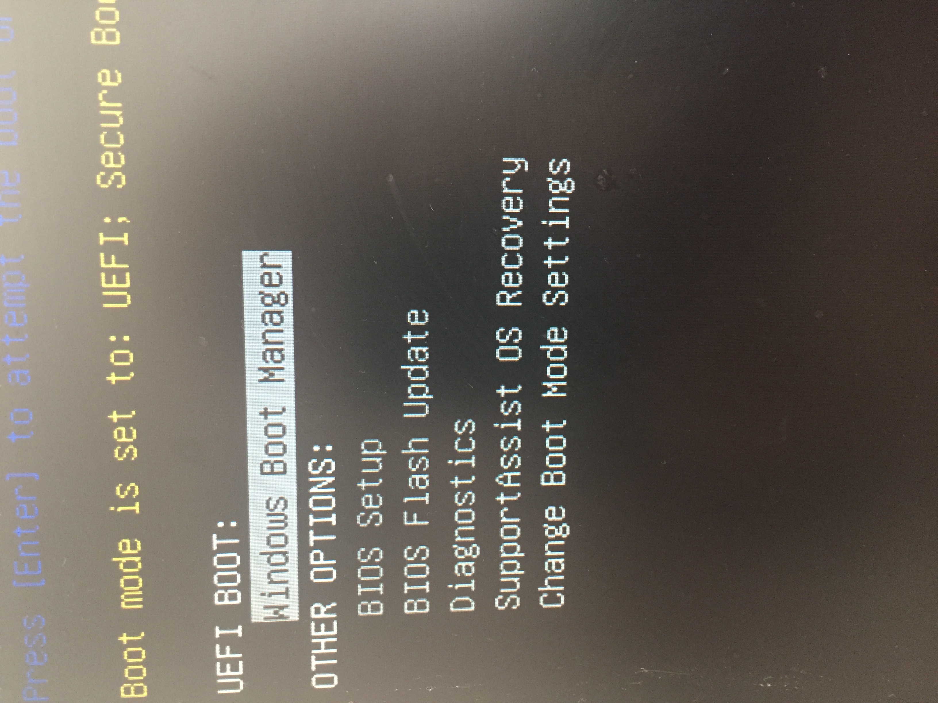

    I got as far as downloading win to flash drive from the ms provided link.
    I don’t know what to choose after F12 at this point

    2019-09-30T18:24:52+00:00
    I recently called MS again and they gave me steps. I downloaded to flash from provided link, went to my desktop, restarted, hit F12, and then it was not clear what option to choose. There were warnings and it made me a little nervous so I decided to instead call Dell today.
