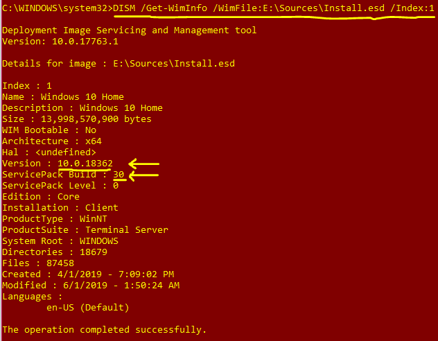

    (2) I created the Win 10 USB Installation media using MediaCreationTool1903.exe. It was a fresh download of the tool, & it fetched the new 18362.175 OS Build (instead of the 30). The first try produced the same error message reported on page 1...

    The new Windows 10 1903 Installation media at build 18362.175 has the fix for the USB problem described.
