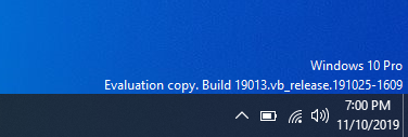

    Preview Build 19013.1 release 191025
    Which will be released to public soon.
    First, I have to say this preview build does deliver with high expectations.  Best of all, it does put my slow and cheap Intel(R) Celeron(R) stability back on track.  For most of you with better and faster system hopefully problems with lag and stuttering should be resolved once you get your hand on.
    I’m not suggesting that you should do as I did.  A slow system requires some intervention to keep it running smoothly, so I elected to take off some background unused and moving parts.  Perhaps I don’t have to and perhaps you don’t need to.
    First; I’m still using O&Oshutup10 to limit all background telemetry.
    Second; as I mentioned.  My system doesn’t like Notifications and Action Center, so I disabled it.
    Lastly;  I regedit and change the following services start to ‘4’ (Disable).  Simply I don’t want anything to monkey with memory and disk including push notifications while I’m playing video and give my 2 core 1.6Ghz a 100% without throttling.
    HKEY_LOCAL_MACHINE\SYSTEM\CurrentControlSet\Services\bthserv start=3
    HKEY_LOCAL_MACHINE\SYSTEM\CurrentControlSet\Services\intelppm start=3
    HKEY_LOCAL_MACHINE\SYSTEM\CurrentControlSet\Services\OneSyncSvc start=2
    HKEY_LOCAL_MACHINE\SYSTEM\CurrentControlSet\Services\RmSvc start=2
    HKEY_LOCAL_MACHINE\SYSTEM\CurrentControlSet\Services\Spooler start=2
    HKEY_LOCAL_MACHINE\SYSTEM\CurrentControlSet\Services\SysMain start=2
    HKEY_LOCAL_MACHINE\SYSTEM\CurrentControlSet\Services\WpnService start=2
    HKEY_LOCAL_MACHINE\SYSTEM\CurrentControlSet\Services\WSearch start=2
    So far it has been a week of full enjoyment, hopefully you will too.  Two thumbs up Microsoft’s developer team, next public release will be the best Windows 10 hands down.
