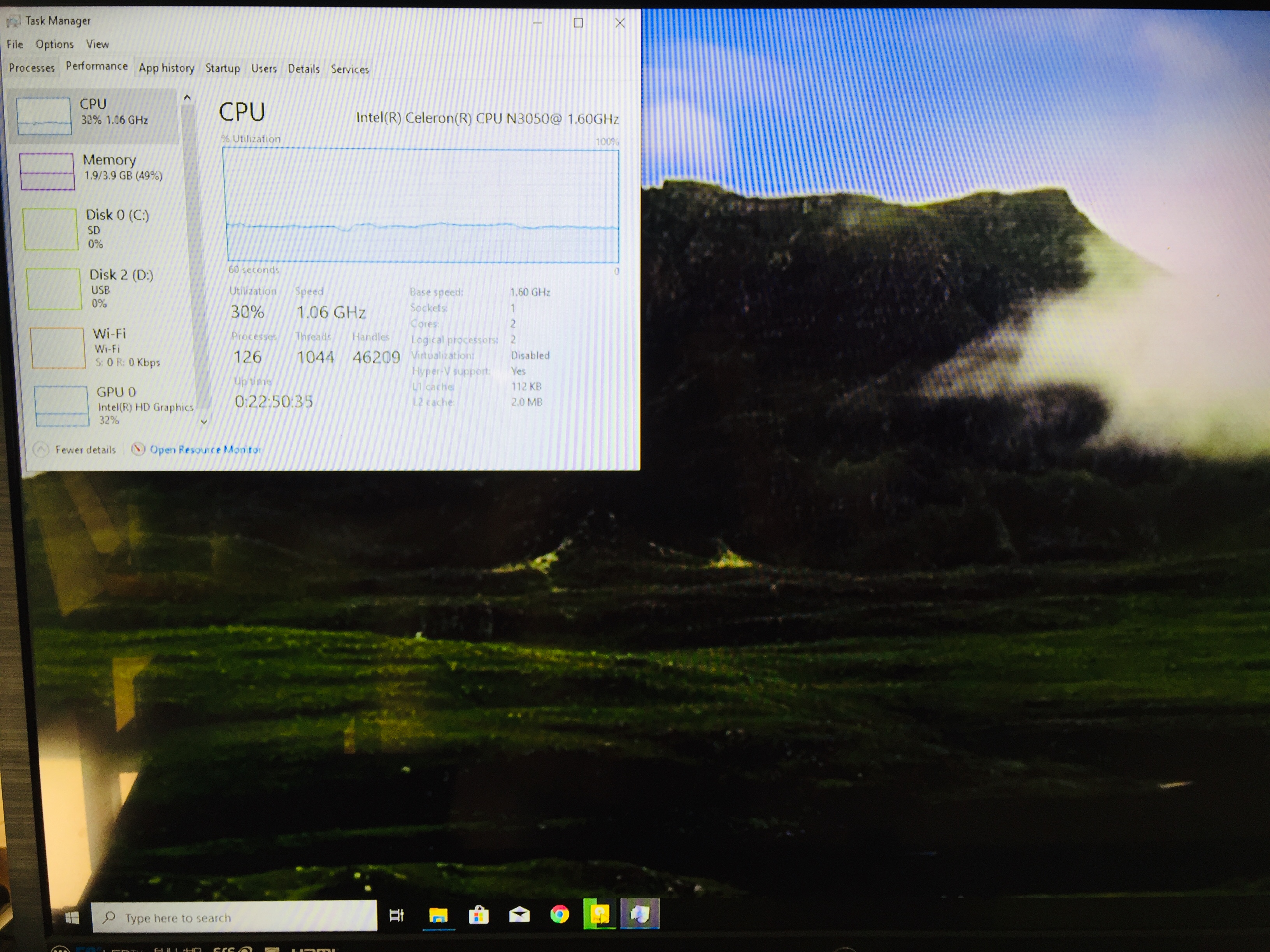

    Update - 20191010
    After TimeBroker service has been put down with video is constantly running.  24 hours later all backgrounds still as dead as a doorknob, and not even one spasm.  That’s an absolute proof that whatever is dropping the crumbs, is coming from windows pre-installed.
    What puzzle me and I can understand is that “Search” function won’t work since TimeBroker did not return a permission valued.  What I don’t understand is that, if I can’t type anything into input textbox, why do they allow me to paste then search results shows up.   Shouldn’t it be the other way around? by allow users to search then filter in the SQL all results that doesn’t have permission.  As well as not to activate function called.  :/
    Only if I have their source code and debugger, this mystery ghost would have been found decade ago.  Because one thing that I have and Microsoft doesn’t have... the machine that I can reproduce the BUG.  I signed in, so you know where to get me.
