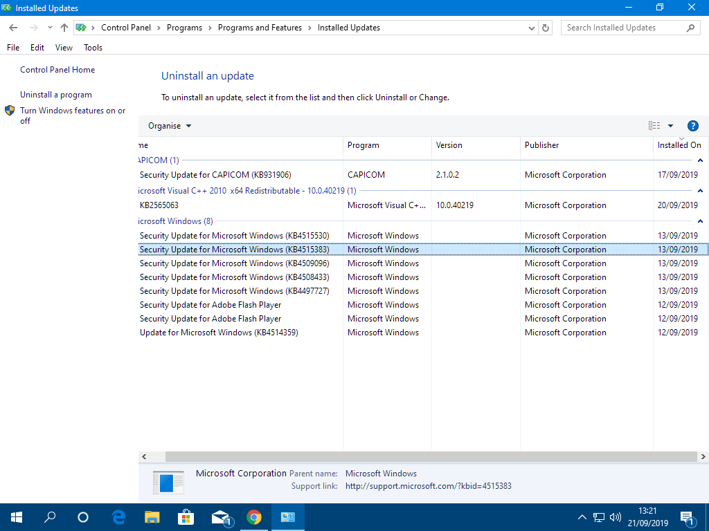

     Ive, been on this for days with many a user and have Just decided that removing windows updates since the problems occurred is the only current viable solution to rectify this as a temporary measure.
    To all users having issues, this is what I've divulged.
    This Update Failed to install constantly ATM and the troubleshooter says there's nothing to report
    Checking back to when the errors started occurring

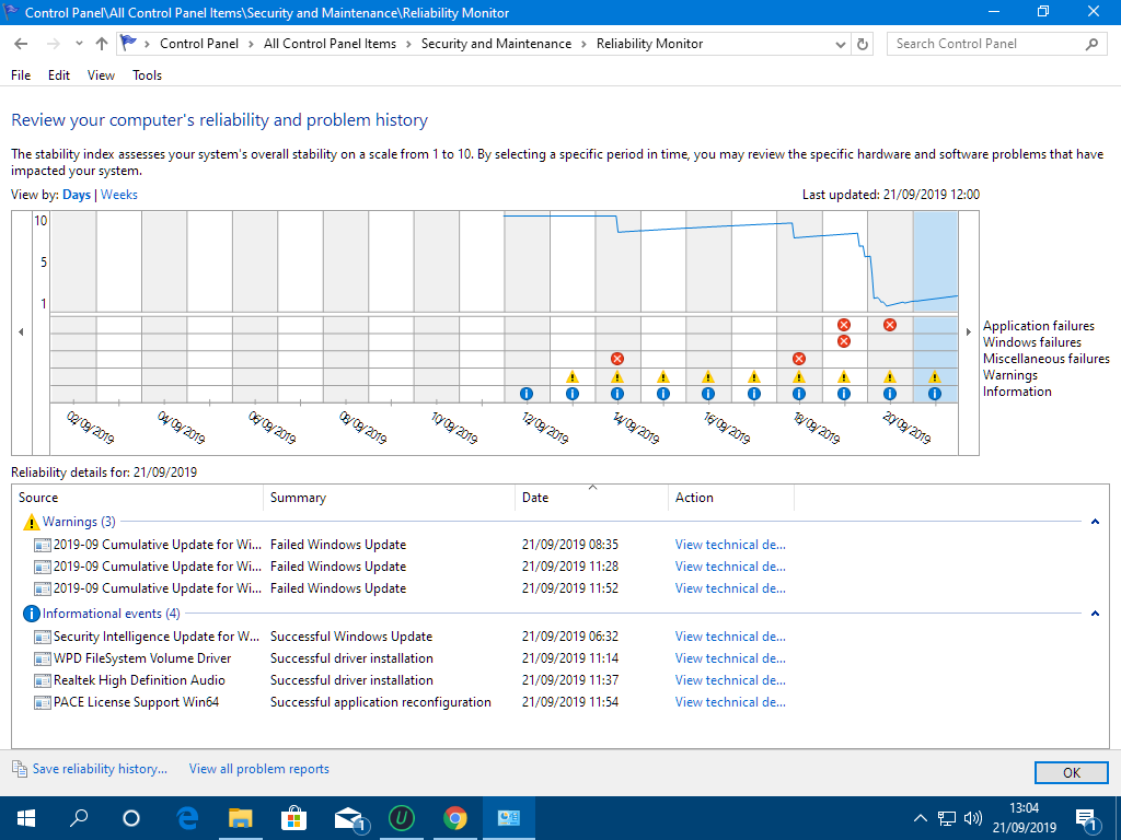

    Using Maintenance Archive Reports,
    The reports allows us to know how many updates to remove as there's no one culprit ascertained! Although I will be removing one by one and trying re-installation of the drivers between each update uninstall.

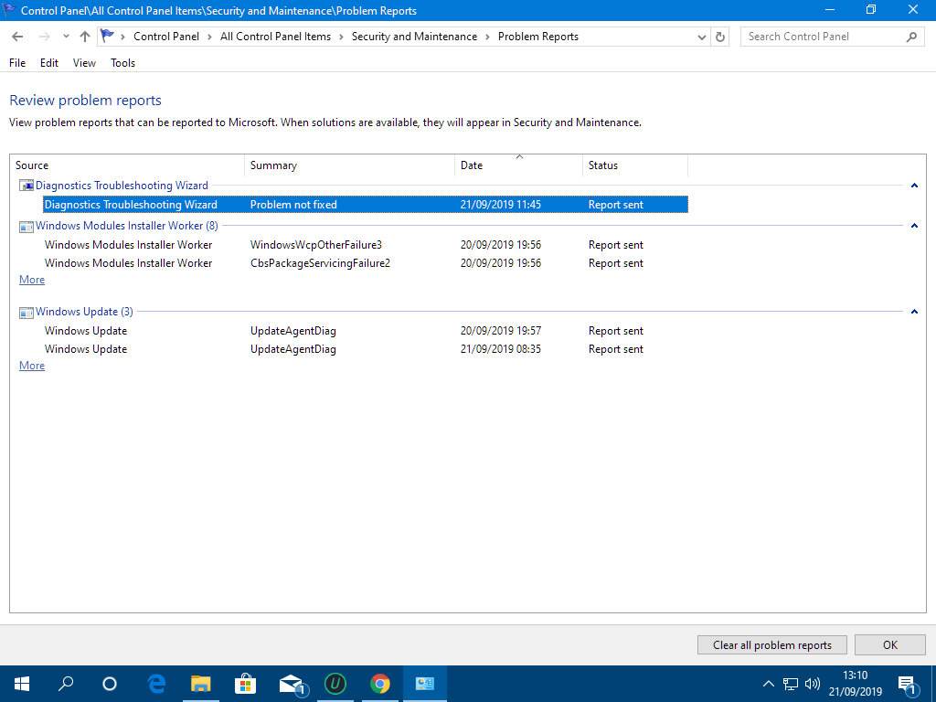

    So Pressing Windows + Pause Break To get the System Screen UP then Selecting Security & Maintenance from the bottom left and going back to the last clear date in the report - I Am going back to hear >>
    When I click view all report problems, these still 6 issues that have to be resolved, so this procedure Is what I am doing. Please dont take this under advisement as a solution, Its my own temporary measure this this problems been rectified..

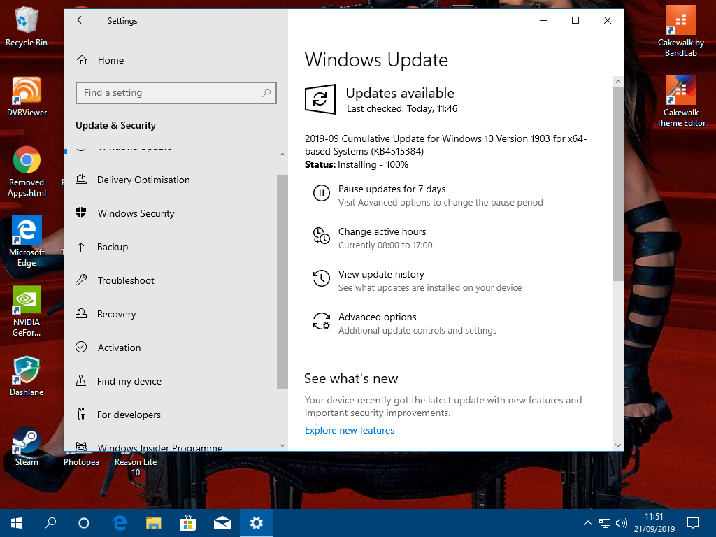

    Hi There, kb4515384 wont install is the problem and Its already installed, searching all over and loads have mentioned it.
    Update Conflict!!!
    Yet windows is still repeating a loop trying to install it again

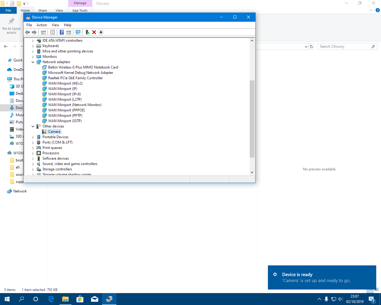

    Hi Flynn, I too am frustrated, this had got me beat ATM. I spent 7 hours with a friend with the same issue and went through many procedures to rectify including reset to no avail.

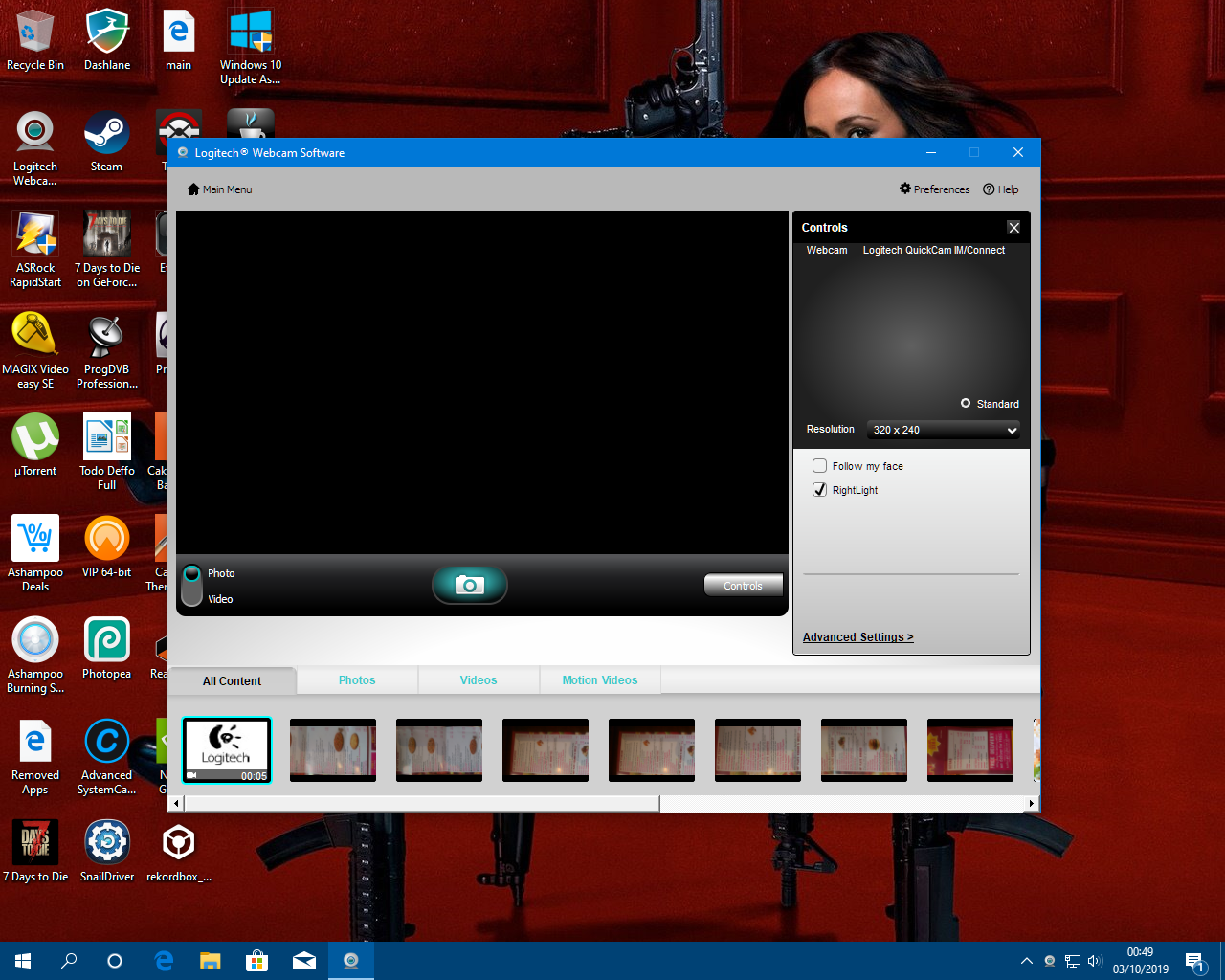

    my current installation wont even deal with cumulative update (KB4515384) on build 1903 same issue lies with USB failing and camera. Actually managed to get it to the point where says its installed and working correctly via settings and device manager, however the app says no its in use by another program which I resolved and still no joy.. I've tried my hardest to assist with this resolve but I am at a loss here, I will be jumping out of my pro build tonight to the insider build which I frequent to see if the fault remains. probably loss my full OS for a change and have to re-install, but I don't like being beat by technology at all. I will be monitoring each event through every install and update procedure. hopefully some kind of isolation will transpire, sorry I cant help further ATM.
    Just so you know my frustration, windows says camera is setup, yet device manger says no
    Then after that I mess around to get device manager to pickup the device, doesn't work via pick a driver myself then camera as it only shows USBvideo device. I need select all devices then Logitech Camera shows. Even Installs but to no avail. detect but black.
