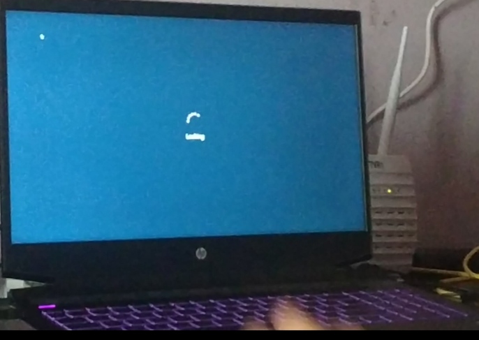

2 days ago i upgraded my windows 10 to build 1903 , since then ,
randomly and during any activity (gaming , watching a video ..etc) ,
screen with the word "locking" in the middle appears for half a second and my laptop goes into sleep mode
and then i have to turn it on again
this never happened before the update , i tried to reset and fresh start but, nothing worked , and now i can't get back to previous build
what do i do ?
HELP , PLEASE

Hey guys
So, I solved the issue (for me, at least) a long time ago but forgot to report back. My apologies
Basically,
Settings -> power and sleep -> additional power settings -> change advanced power settings -> battery
Then, change critical battery action and low battery action to do nothing both on battery and plugged in
I don't know if others already solved the problem In a different way, but i Hope that helps
Have a good day

    I had LOCKING problem as described very early in this discussion, and noticed the post that advised removing the battery. By this time I was very frustrated as the machine would only stay up a few seconds at a time so getting to any diagnostics was almost impossible.  Even getting to safe mode took many restarts.  Anyway, I removed the battery and that seems to have solved my issue.  Many thanks to all that posted and I hope something works for you all, as it did for me.

    Same issue here with random brief "Locking" message on blue screen before hibernating/sleeping.   Have to awake again with power button.
    • Asus Netbook  (weeks old)
    • Windows 10 Home Ver. 1903  Build 18362.657
    • Started happening while trying to remove Lock/Unlock feature from WD Passport ext.    drive.  Frequency increased to just minutes (3, 5, 15) after erasing drive with WD Unlock interface and formatting.  (Don't know if it has anything to do with the issue, but that's the activity I was performing when it got a lot worse (frequency of minutes)  ).  Note: I had experienced a previous isolated occurrence days before, that occurred after the initial insertion of the WD Passport drive (Non-SSD).
    • Started disabling some of the Power settings eg, What closing lid does, etc.  Problem persisted.
    Only after disabling all the power settings I could, including "Advanced" options, I have been able to go hours now without experiencing any brief "Locking screen" with accompanying hibernation/sleep action.
    I did though, experience signs early on (on about three different occasions) that made me feel  it was about to happen again.  Quick, momentary blanking of screen.  But no sleeping/hibernation!!
    I hope these details are of help.
