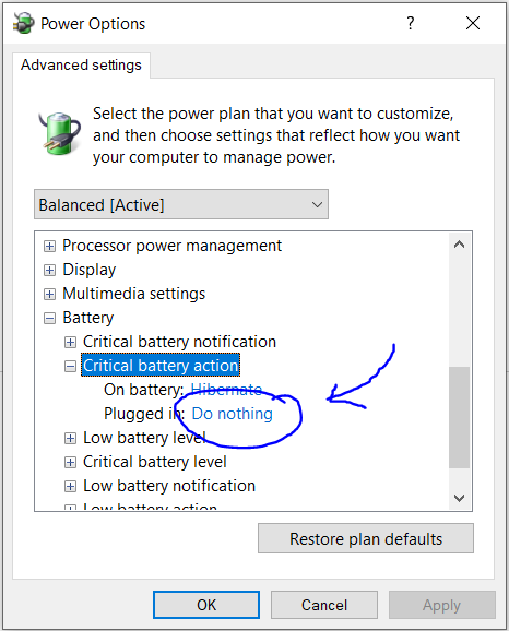

SOLUTION
Hey guys
So, I solved the issue (for me, at least) a long time ago but forgot to report back. My apologies
Basically,
Settings -> power and sleep -> additional power settings -> change advanced power settings -> battery
Then, change critical battery action and low battery action to do nothing both on battery and plugged in
I don't know if others already solved the problem In a different way, but i Hope that helps
Have a good day

Hey guys
Basically,
Have a good day
