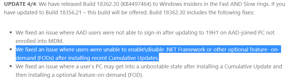

    The update from 18362.1 to 18362.30 was supposed to fix this issue:
    It is bad enough that this happens, but it can be replicated on any recent version of Windows, just by using DISM to uninstall .NET Features.  Some features then vanish from the list shown with DISM /Online /Get-Features /Format:Table and cannot be restored apart from a total clean install. I even tried sysprep yesterday, but the Features are totally removed from the image, so cannot be enabled. An example is the Feature named NetFx3 that shows in the DISM list. It vanishes if .NET 3.5 has been removed. It should never vanish from this listing.
