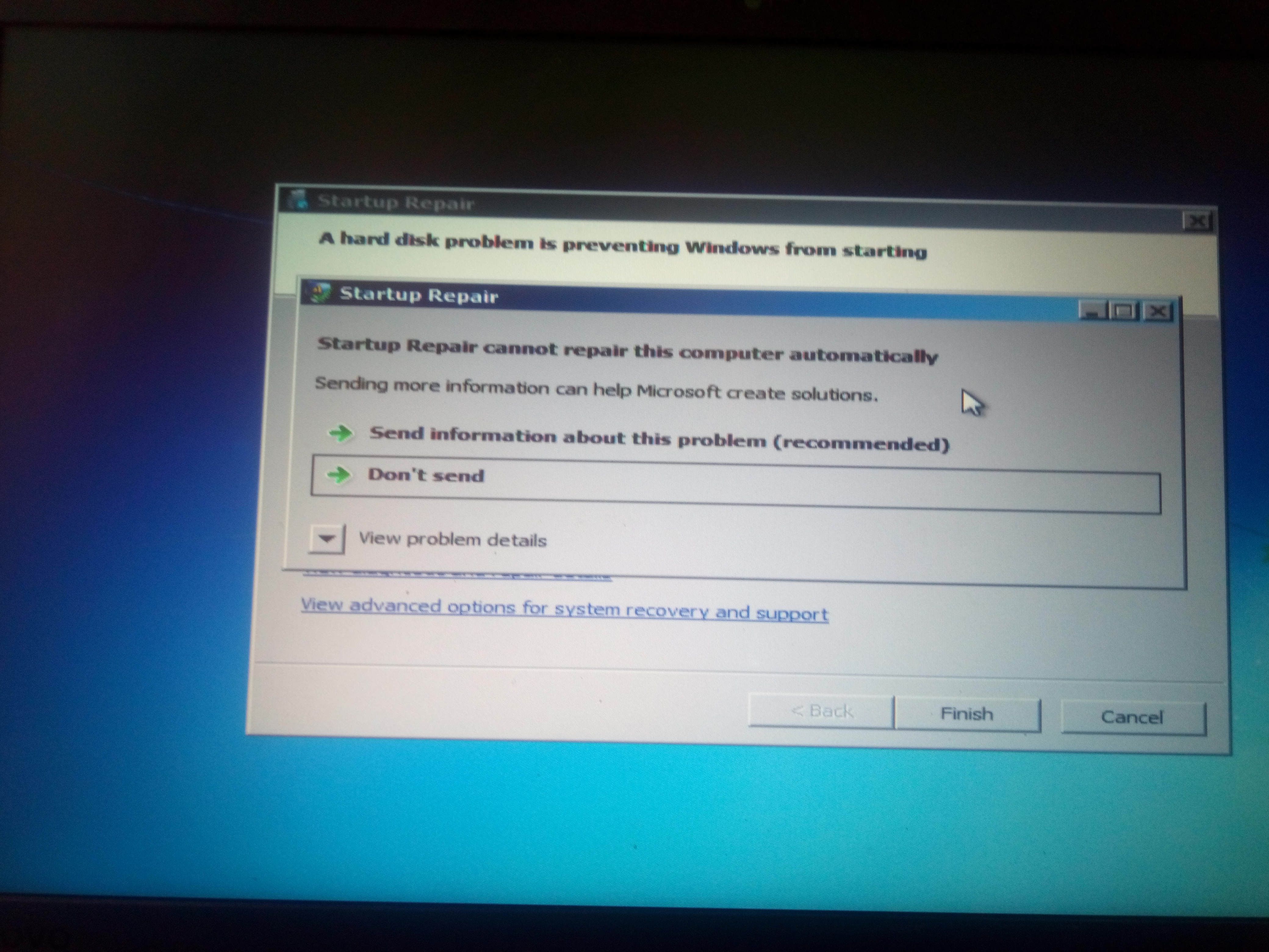

I have tried so many ways to repair my computer but still non of them are working . My PC is saying "Windows failed to start . A recent hardware or software change might be the cause . To fix the problem ......
I tried via automatic repair , it couldn't fix my problem after that I tried with system restore to the earlier point , but iit' showing no restore point detected .
I even tried by booting from usb usb flash drive and after that it sayings "Windows file is loading" and then windows 7 logo appeared and then it stucks , A black screen appears and now i am in trouble .

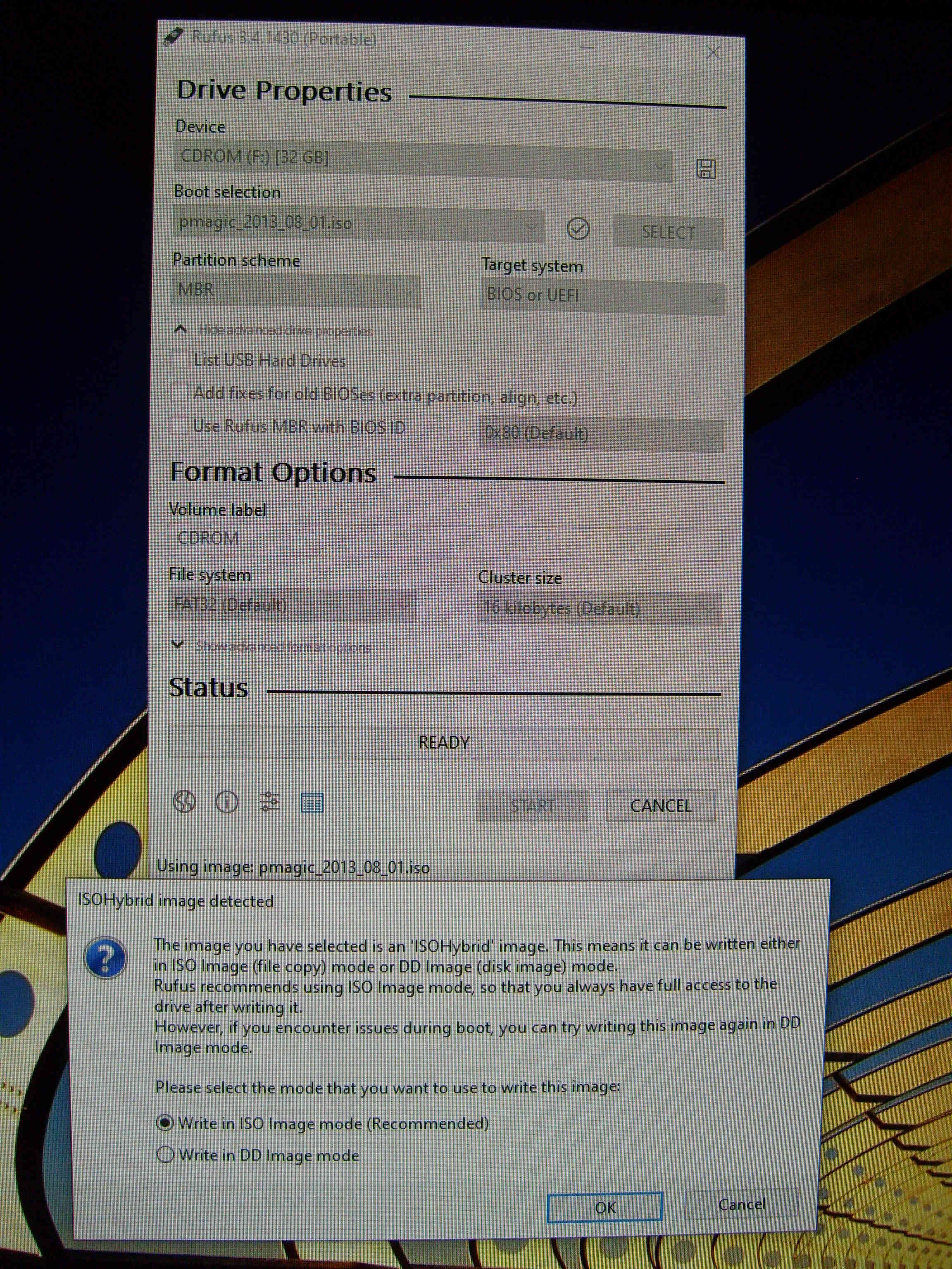

    I know about rufus , I have been using rufus for a long time . But what is parted magic , I didn't understand .

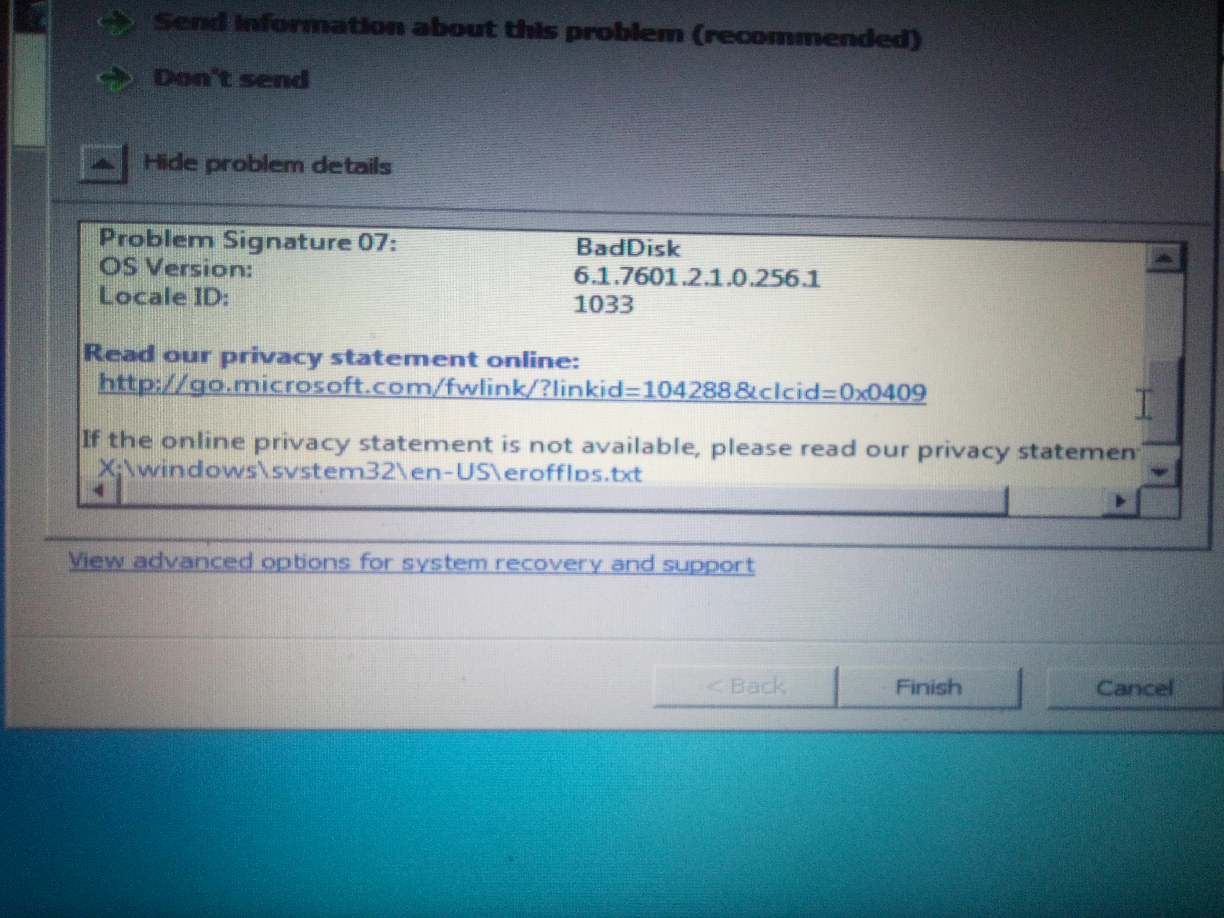

    can you tell me about this picture , why it's showing this kind of problem , It's saying bad hard disk .
    When my computer was working I tried to transfer my files into a hard disk drive but sometime the transfer speed decrease to 0 bytes/s and it cause my PC freeze . Then it start to not responding and it become so slow even if I want to shut down my PC , it failed . And I had to shut down my PC by pressing the power button .

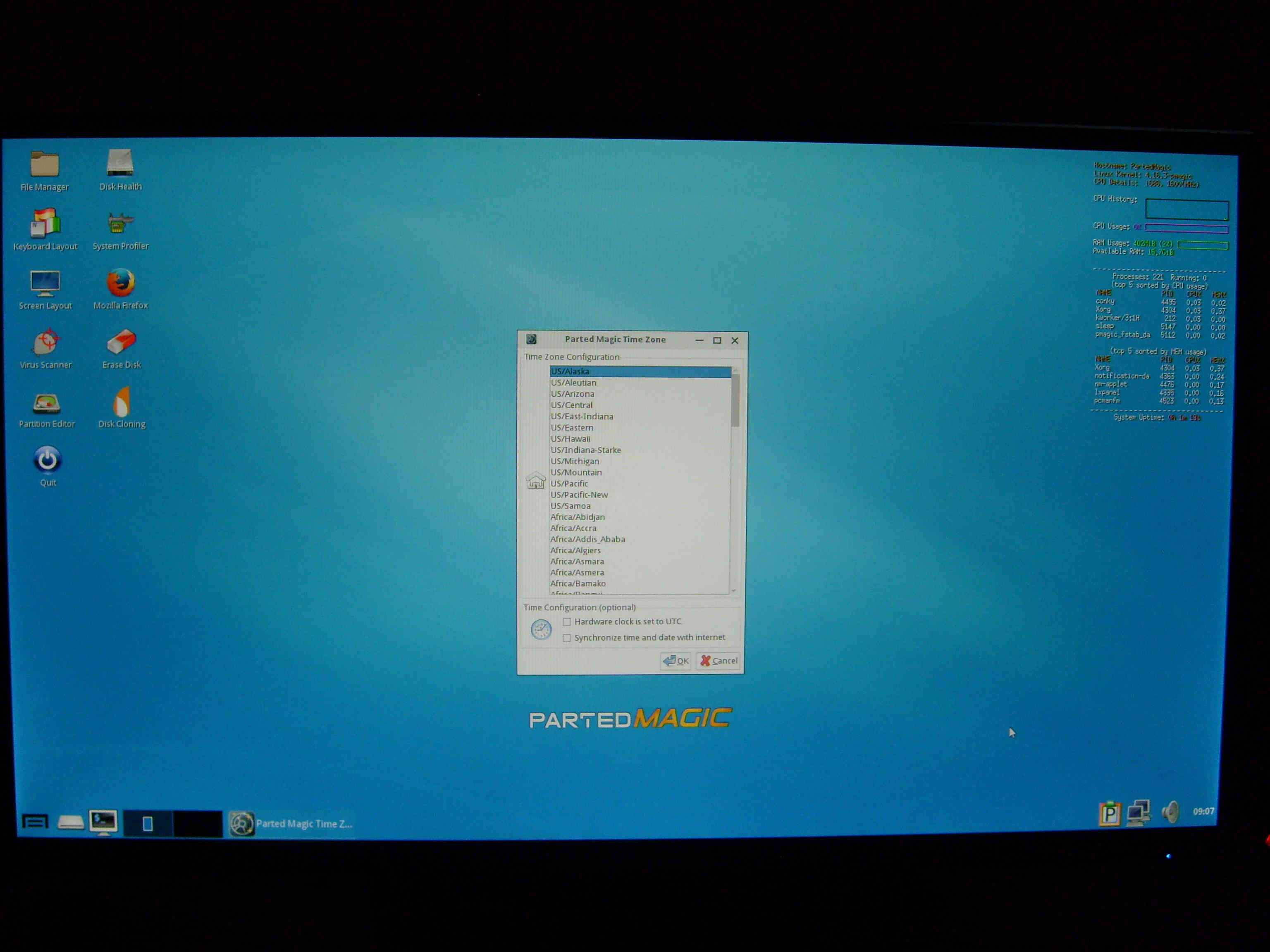

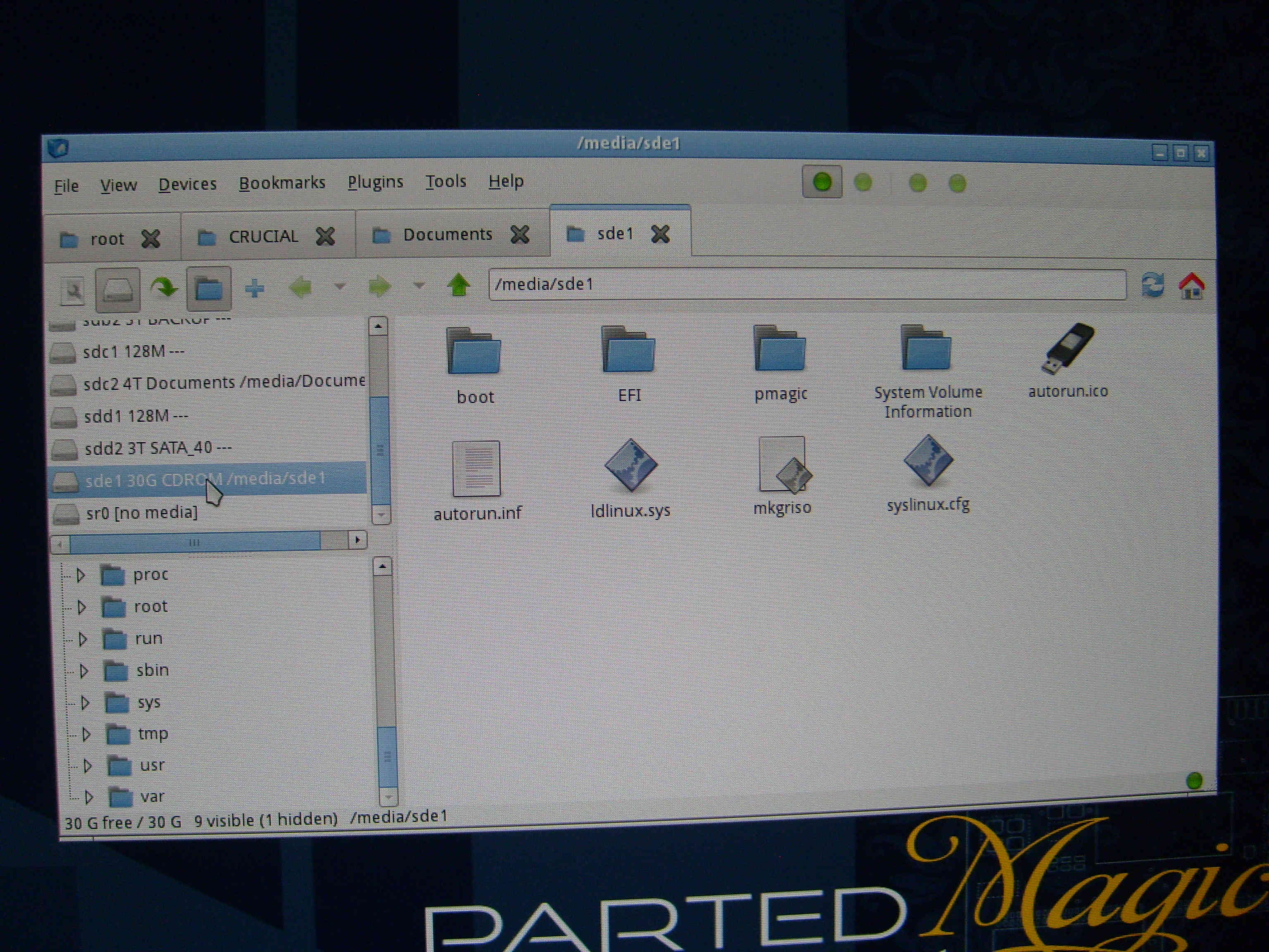

    Will the parted magic needs the computer to be working and running windows . My PC isn't running . I can't open the desktop like you opened and you show me your file manager in upper left corner . Is it like booting or running windows thatst how we do to install windows with a USB flash drive qith rufus .
    2019-03-28T23:43:06+00:00
    It may be that your hard drive is failing, but it might be that Windows 7 is simply too damaged...
    Your hard drive was working well enough to show your partitions when using Notepad, so they may be savable... At least some of them..

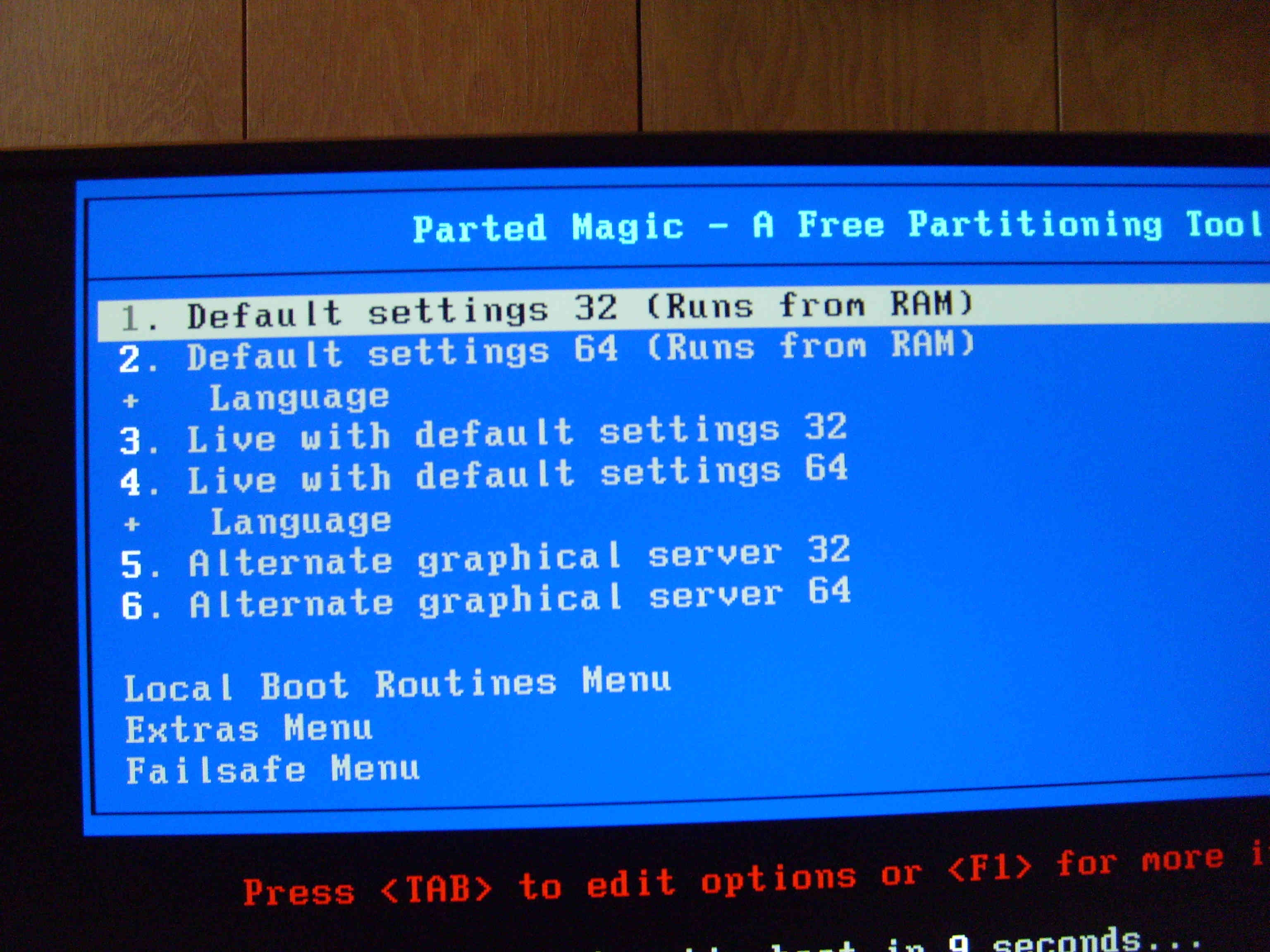

    Parted Magic is a LINUX based Operating System that runs out of the computers memory...
    It does not actually install onto your computer...
    Because it is not based upon Windows, most of the restrictions Windows places on things do not apply...
    This particular version of the Operating System is primarily for various repairs to the system...
    You will not see the File Manager I mentioned until you burn the Parted Magic to a CD or Flash Drive, and boot your computer with it...

    You would boot with it just like you would Windows Installation media...
    If it will not boot on it's own, you may need to select your CD\DVD Drive or Flash Drive from the Boot Options available on the manufacturer's screen you see when you first power on...
    Of course, if the media is not created properly it will not boot either...
