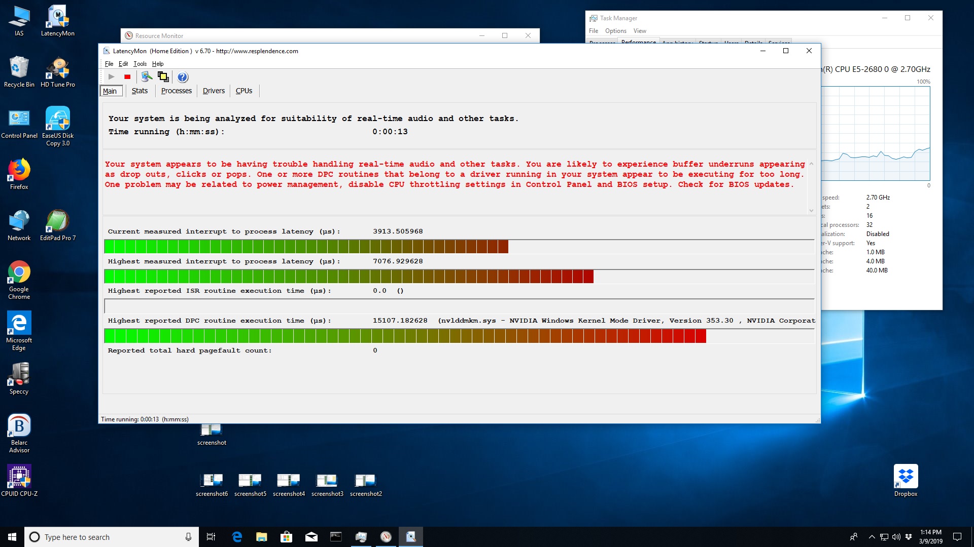

I've looked at task manager, and it is showing periods of high CPU use, and it is in these periods when it us unresponsive.  The main things using the CPU are "system", "service host: diagnostic policy service" and "service host: Windows event log".  See the attached screen capture from Task Manager.  When the CPU use is 20% or higher, it is unresponsive.

    Someone suggested LatencyMon.  In periods when I was not having the problem, it didn't show much.  But it showed something when I was having the problem, but the response was not good enough to save the screenshot.  I just managed to get a screenshot and save it.  I'm not using audio for anything and haven't heard problems.
