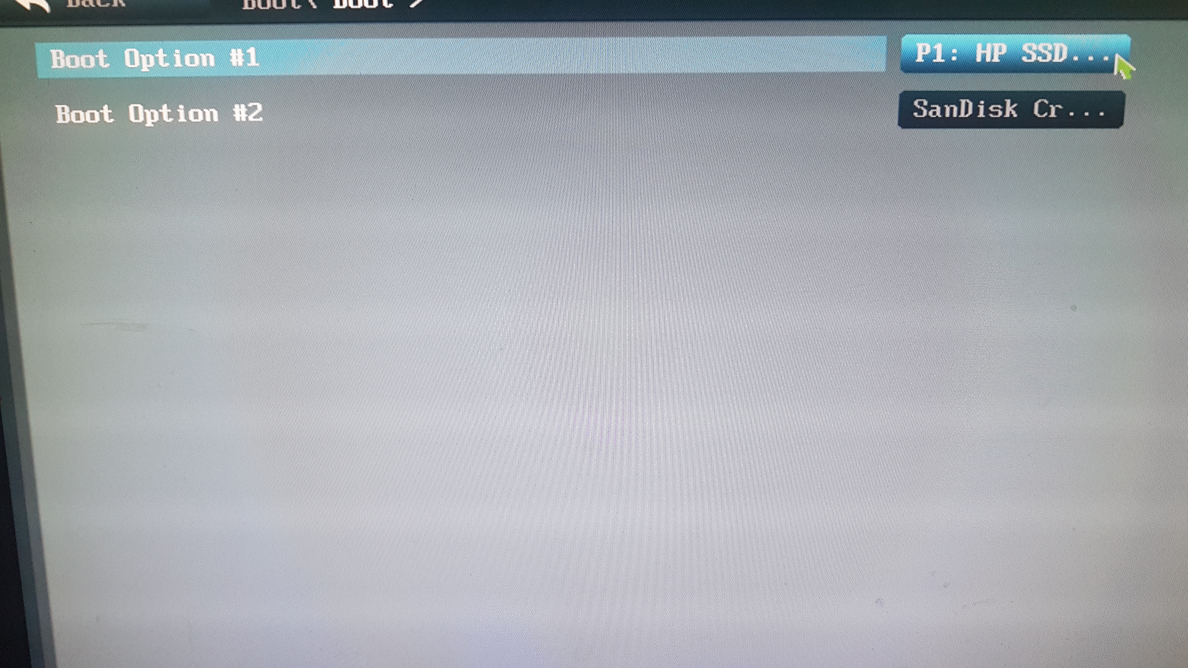

    I disabled port 5 and enabled port 1. Still nothing. Tried port 2 as welI after that just to be safe. I also checked the directkey options and the only other one is to disable the button. That didnt let it boot either.
    I built this computer myself years ago so I know there is no drive in port 5. It may have once been my CD drive, which should have been drive 2 since it is in the 2nd slot, but that has been long since disconnected anyway and I havent had issues with my HDD.
    Originally this drive was the 2nd drive. I had plugged it in to see if I could install windows with both drives plugged in but I ended up unplugging my hdd and using that sata cord for the ssd just to be safe. Could that have set it to drive 2 messed with something?
    Reinstalling again as instructed earlier brings me back to the final picture.

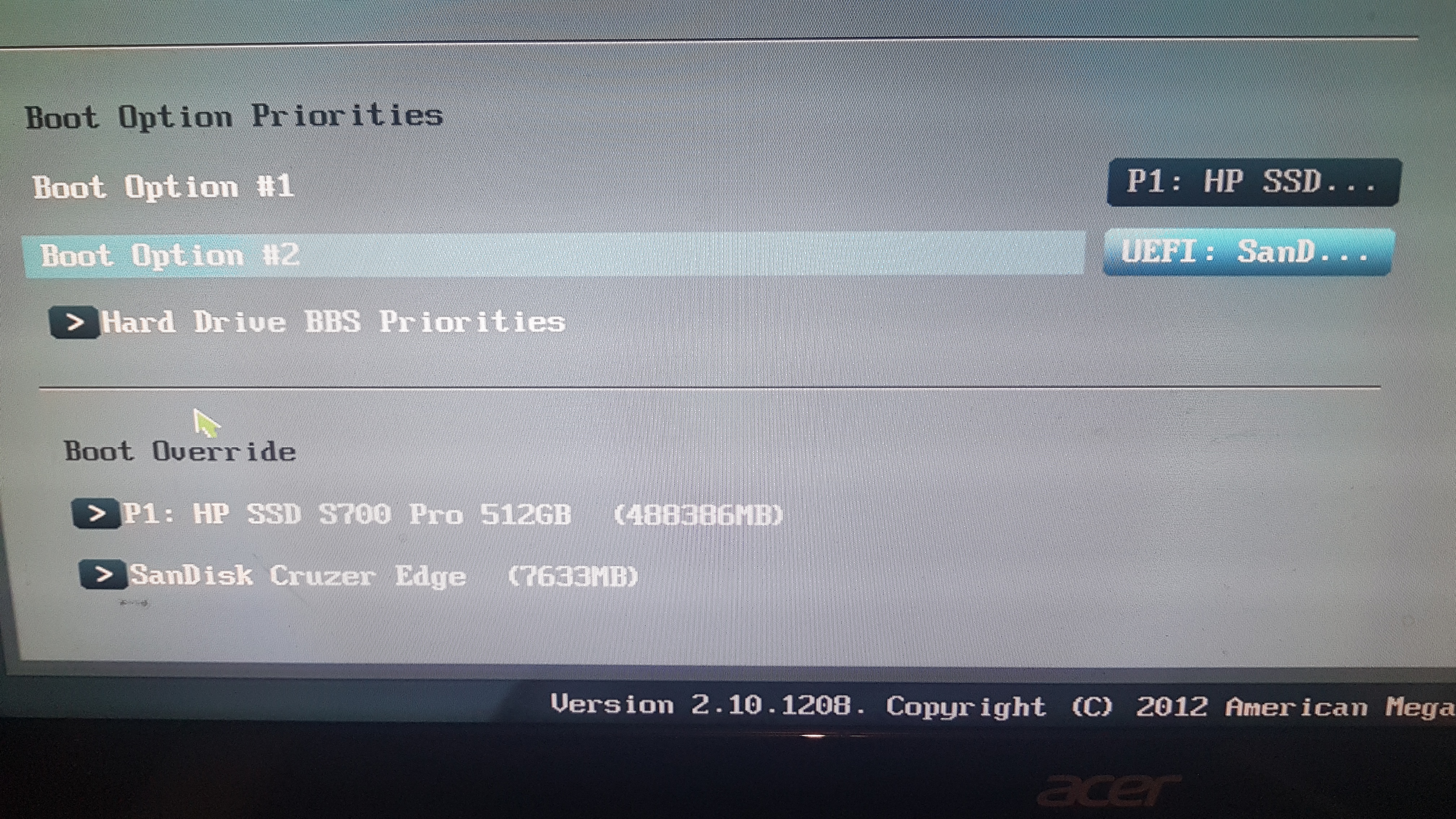

    2019-03-03T20:53:14+00:00
    is this what you are asking for?

    What is under "Hard Drive BBS Priorities" ?
    It may be that you simply have a defective SSD...
    Because of the way the internal controller works and etc., it could show files, but they are not complete or accessible... I have had weird issues such as that with SSD previously...
    The file name may be in the directory, but no files in it, as a for instance...
    There is no reason you should be able to run your machine with a HDD, but not a modern SSD...
    Plugging your SSD into the HDD connector should be all that is needed, but the fact you tried to install to the SSD with the HDD still in the machine may have caused some complications and\or confusion...
    I don't know if that SSD is a Samsung or not... The model number is for a HP SSD...
