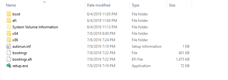

    The autorun.inf is not created when you format the USB, but it is copied from the downloaded files.
    I see autorun.inf in the one I create, to see it you need to change the view to see hidden files.
    Would be nice to know what is the difference bewtween your setting that fails and mine that never fails. What is the root cause ?
    I have 5 different machines and created USB windows install media all the time for years, I never see the problem described in this thread.
    Autorun.inf   on the media with both 32 and 64 bits:
    [Autorun]
    open=setup.exe
    icon=setup.exe,0
