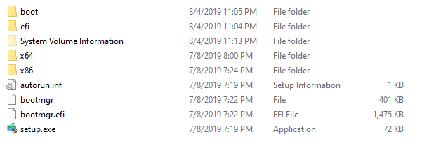

    This below is what I see on the USB stick after it completed.
    It boots fine giving the option for 32 or 64 bit.
    It is formatted as FAT32 to be bootable both for UEFI or Legacy BIOS machines, the partition is set active.
    As for the Boot sector it is prepared when the device is formatted with Windows and contains BOOTMGR.
    The biggest file in the x64 folder is around 3.5GB, so there is no problem with FAT32 format which has a file size limit of 4GB.
    The total space used on the USB device is 6.72GB.
