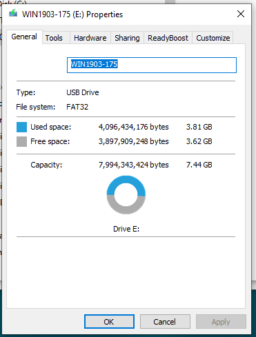

    2019-07-30T20:32:47+00:00
    Wile E One,
    Following the good suggestions usually helps :)
    Glad it worked for you, some USB devices may need to be cleaned up and formatted properly, some third party programs may not prepare the device correctly.
    Here is one sample on a 8GB SanDisk Cruzer created without any issue.

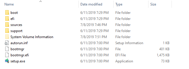

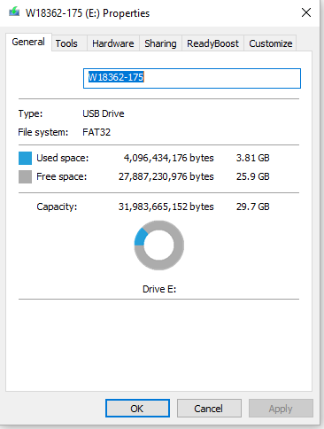

    2019-07-31T01:32:57+00:00
    4 of your folders have different dates, doesn't mean much without comparing the folders with the date change.
    I bet if I download one today it will be different again...

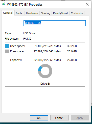

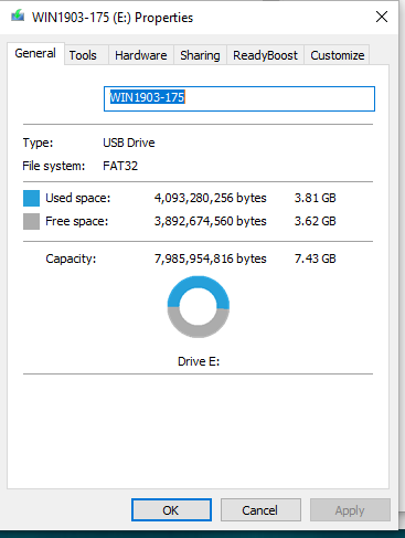

    Here is a different one on a 32GB device with the same dates as the 8BG device..
    The used space is different and more than your 16GB device...
    Could be the cluster size used for formatting that makes the difference in the space used.
    The default cluster size changes with the device capacity.
    See the last picture below, it shows exactly the same used space as yours, I just changed the cluster size to prove it.
    The bigger the cluster size the more space gets wasted.
    Since the default allocation unit size changes with the size of the device, that explains the difference.
    Looks like yours was formatted with Unit Size of 8192 bytes.
    Everything seems to match for the same build even if they were created at different dates.
    Last 2 devices show the same space occupied, they are formatted with Unit Size 8192, one device is 32GB, I just changed the unit size from 16KB to 8192 B, the other is 8GB just changed the format from 4096 to 8192 B Unit size and the numbers match.

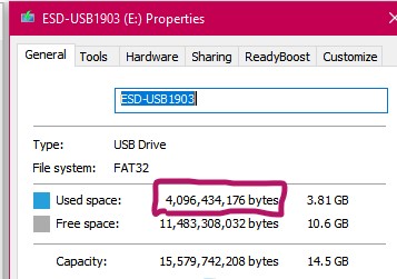

    2019-07-31T04:00:56+00:00
    Good thinking. I might have thought all that up myself given enough time. OK, it seems ChkDsk reveals cluster size but calls it "allocation unit" - &, right, it is 8192 for mine...
    C:\WINDOWS\system32>ChkDsk E:
    The type of the file system is FAT32.
    Volume ESD-USB1903 created 7/9/2019 10:13 PM
    Volume Serial Number is 8E09-EE84
    Windows is verifying files and folders...
    File and folder verification is complete.
    Windows has scanned the file system and found no problems.
    No further action is required.
       15,214,592 KB total disk space.
               16 KB in 2 hidden files.
              744 KB in 84 folders.
        3,999,656 KB in 943 files.
       11,214,168 KB are available.
            8,192 bytes in each allocation unit.
        1,901,824 total allocation units on disk.
        1,401,771 allocation units available on disk.

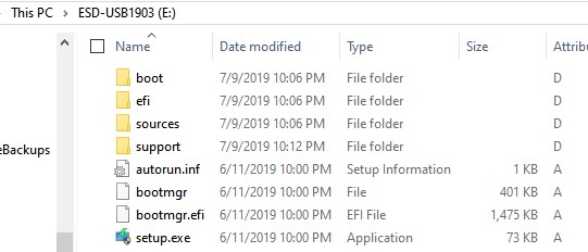

    It's a fairly instantaneous ChkDsk. Again, good thinking. I accept the explanation. As for the date differences, my dates seem to match what is in my DISM...
    Created : 6/11/2019 - 9:35:39 PM
    Modified : 7/9/2019 - 10:05:52 PM

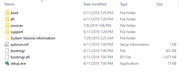

    I believe "Created" is the date MSFT made/released the Windows image (if I may call it that) that MediaCreationTool1903.exe (MCT) downloads. And "Modified" is the date I ran MCT to (do the download &) create the Windows Installation media. Turning OFF "Hide protected operating system files" in Folder Options, I see my System Volume Information folder is 7/9/2019, which matches Modified.
    I guess you ran MCT on the very day MSFT released 175 which was 6/11/2019. That made all your folder dates to be the same date. Then, on 7/8/2019, you modified the contents of the Sources folder at 7:46 PM. I don't know what to make of your System Volume Information folder which is dated 7/24/2019. I'd rather have seen it be another 7/8/2019.
    Edit: Now I see it was another 7/8/2019 in your earlier listing (of the 8 GB Sandisk Cruiser). That makes sense. When you changed the Sources folder, it must have also modified the volume information. But the 32GB device remains a puzzle.
