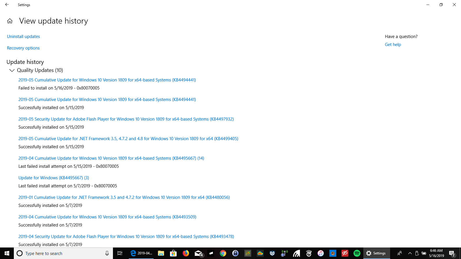

    UPDATE! KB4495667 Showed installed and went through the restart PC process and then later downloaded again and said not installed???? This is crazy!!!!

    Welcome to the club! At my update history shows the same as at your screenshoot, that the update was successfully installed, but after restart because of .NET update, it didn't install and failed.
    2019-05-16T13:14:19+00:00
    I had the same issue.  I was able to resolve the problem.  On my PC (an Acer Predator Helios 300 running Win 10 Pro Build 1809) I have several user accounts (two MS user accounts as Standard users, and one local account as an Administrator)  When I ran the update using my MS user account (Standard User) the update consistantly failed to install.  I resolved the issue by rebooting the system and logging into the local account (an Adminstrator account) and re-ran the update.  It installed correctly.  This leads me to believe there is some sort of permissions thing going on with this update.  Your mileage may vary :)
