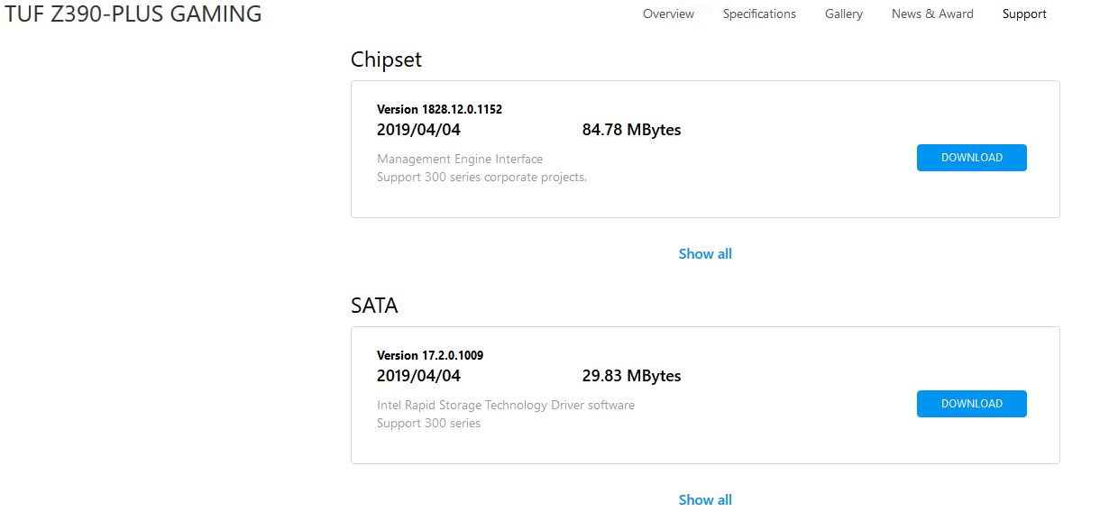

2019-04-09T11:18:00+00:00
Here is a link to your motherboard's website... Near the bottom is a "Special Features"...
It mentions an automatic driver download feature for "First Time Installers"...
You might not want to use this though... The reason ?.... It may also install some additional ASUS Utilities that you may not want... I have had problems with some of this type of stuff in the past, as have a good number of others on the Forums...
https://www.asus.com/Motherboards/TUF-Z390-PLUS-GAMING/specifications/
Further down it mentions a "Driver Support Disk"....
In reality, Windows 10 will install most everything you need as far as drivers are concerned...
Some may be "Microsoft Basic Drivers", but they will get you up and running.... Others may be the exact same thing provided by ASUS...
You could take a look at what drivers are on the Driver Disk and then look for newer ones...
You could also use the automatic method, depending upon what it downloads, and what you decide to do with the extra ASUS Stuff...
Part of the "Special Features" is a "ASUS Exclusive Features" which lists the Add-On stuff I mentioned...
Personally, I would not install any of it... Just more stuff to potentially cause problems in the future...
Setting the memory for it's rated higher speed would not be damaging to the memory or MoBo...
They are both designed to support doing that...
If you have figured out how to get into the Bios for Boot Order and ETC., it shouldn't be to hard to find the XMP settings... The machine will start and run just fine with whatever the Default is... Setting the XMP is not something that is critical for it to run... Just to get the faster speed...
Should it become necessary, I can probably help you find it... Some times the Bios Settings Documentation is easy to find, and other times not, but most all are somewhat similar...

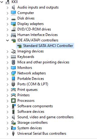

You have a Intel CPU... Which is why it makes no sense that it attempted to install on your computer..
But again... this talk concerning AMD and Intel has nothing to do with your I\O Crest SATA card...
It is all concerning motherboard issues...
Because it is for motherboard issues for a motherboard you do not have, I think it is responsible for your problems.. It certainly won't hurt to test your memory though...

I can't guarantee it, but I can find no reason your motherboard would not be able to use over 2TB drives...
I'm also not sure what you mean by pciex adapter cards... It;s probably just the terminology... I simpy call them PCIe... I found a number of them with a quick search...
I would not worry about the Windows 10 Compatibility... I have not had problems with any of my add on cards running Windows 10...

I suspect that maybe one of your SATA cards may be the problem, but it could be a memory stick you haven't tried yet...
Most importantly concerning your HDD size... You should be able to run a HDD larger than 2TB...
I have a similar Gigabyte EP45-UD3R motherboard with the same Intel Chipsets...
I am currently running a 3TB and a 4TB drive on it, along with a 2TB and a 120GB SSD...
The trick is that the HDD over 2TB needs to be "Initialized" as a "GPT (GUID)\NTFS type drive, instead of the traditional MBR\NTFS...
I will check on your motherboard for any restrictions using a GPT drive, but I doubt that there is...
This is more of a Windows Issue than a motherboard issue...

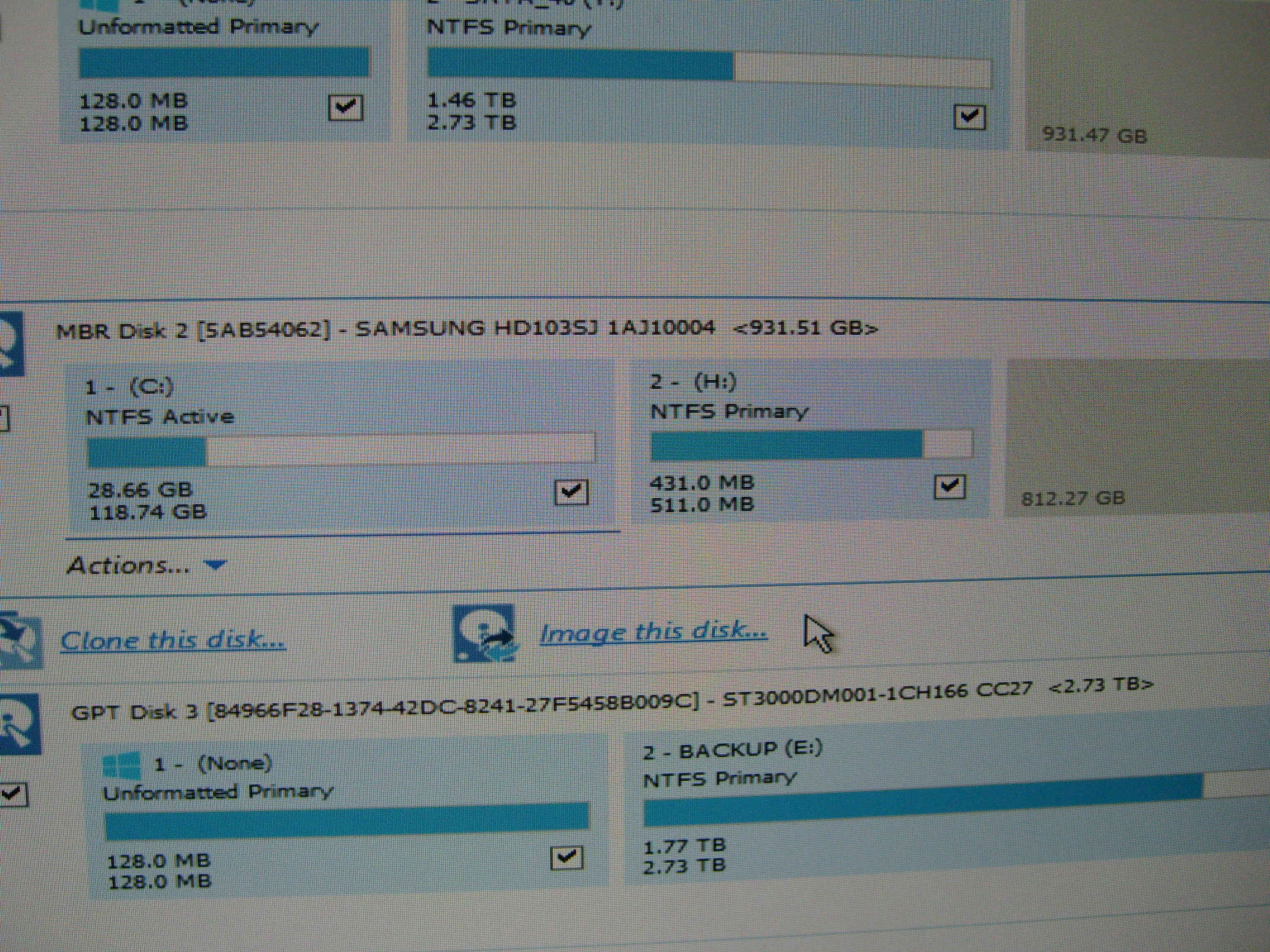

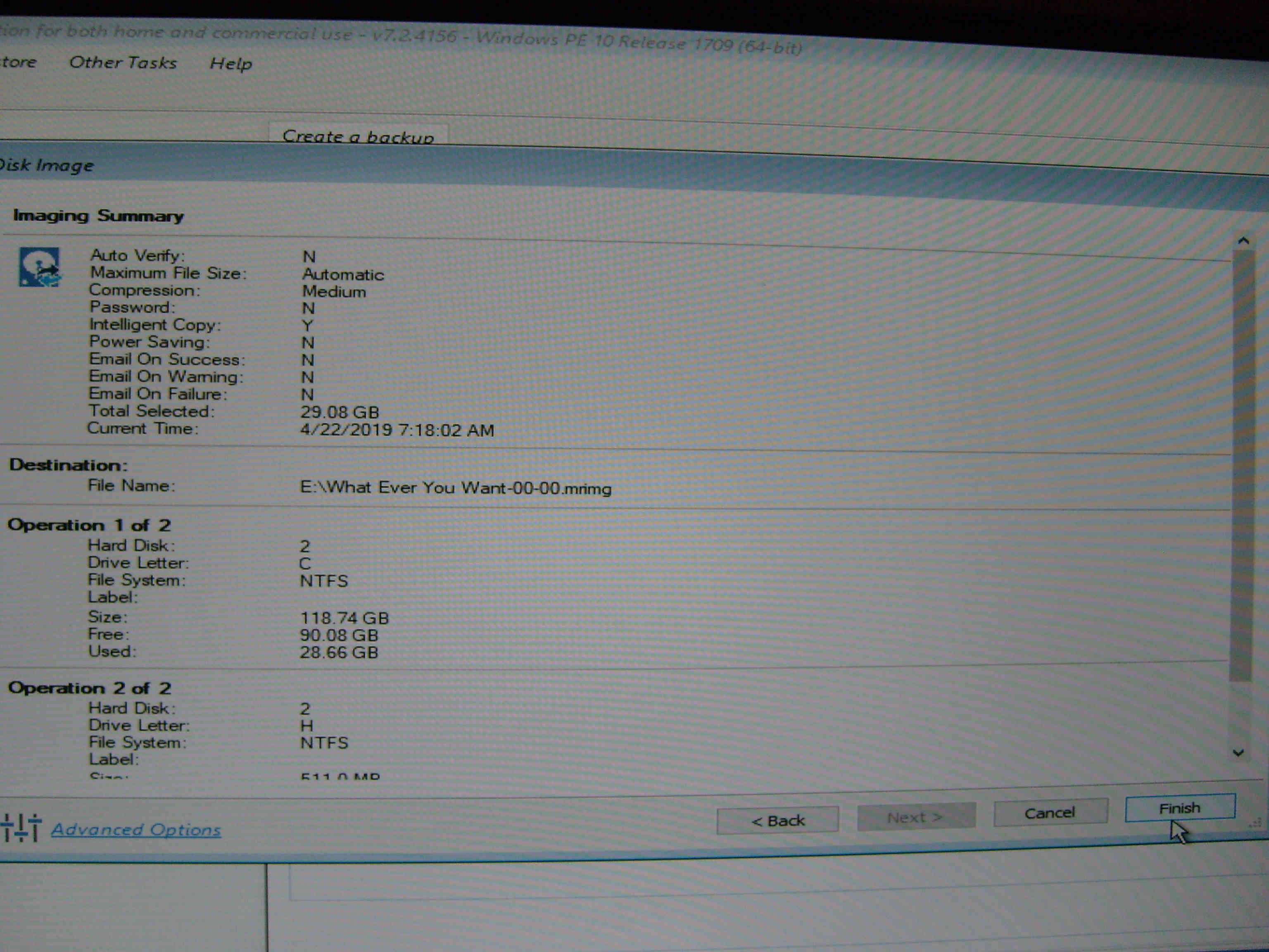

    This was to save you needing to wait to get your HDD ready to install Windows as a spare to use Macrium...
    You would want to use it immediately to make another System Image of your SSD..
    For two reasons... The ones you made of your SSD using the Windows 10 method may not work if your SSD failed and you needed any type of replacement... In theory, they should be usable to restore an image to a replacement drive... In practice, the current version of the Back\Restore does not seem to want to do that..
    The second reason follows up on the first... If you use Macrium to create an image of your SSD, it eliminates all of the quirks and possible failings of the Windows Back\Restore method..
    You will be able to restore a Macrium image of your SSD to the HDD we discussed...
    An exact copy of what you currently have, placed on the HDD... No installing required...
    Of course, feel free to do a fresh installation on the HDD if you choose... Nothing wrong with practice that will not be damaging to your current setup...

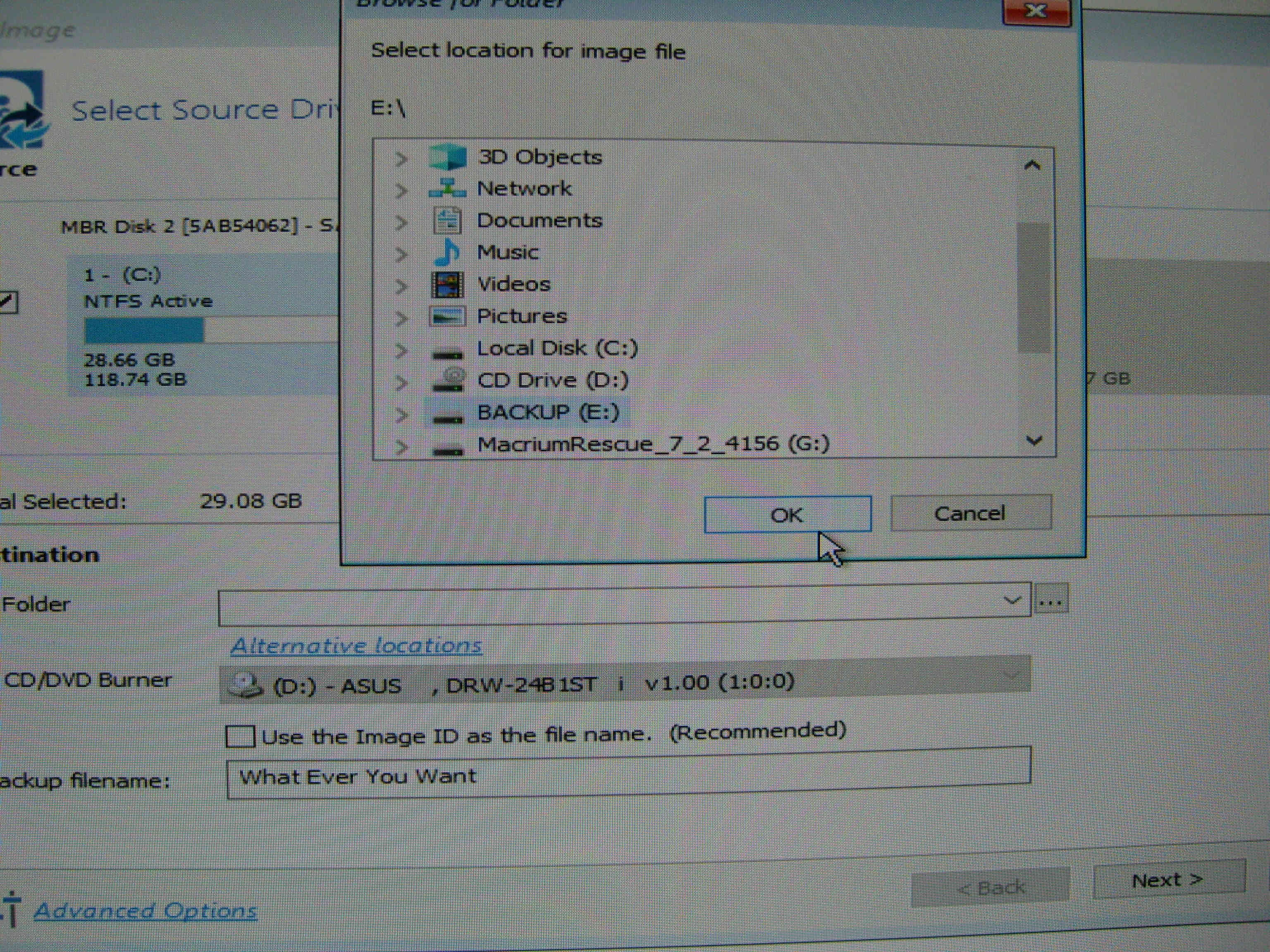

    So what you would do is to boot your computer with the Macrium CD...
    Click on The "Backup" Tab...
    Click on the drive you want to image... In this case your SSD...
    Select the "Image This Disk" that will appear directly under the "Disk"...
    Uncheck box to use "Image ID As  File Name"...   This is so you can name the new image as you wish..
    Click the Advanced button on the bottom...
    Select "Make Exact Copy"...   This takes a little longer, the size of the image is slightly bigger, but it saves EVERYTHING on the drive...
    The other method removes certain "Unneeded" files from the image, then requires Windows to re-create them when the Image is ever reloaded...
