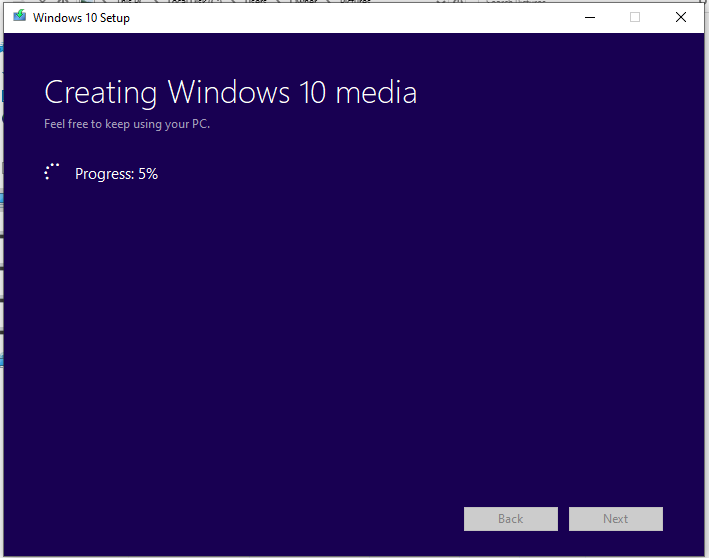

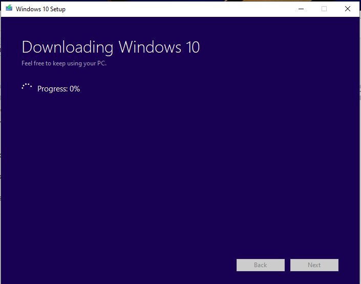

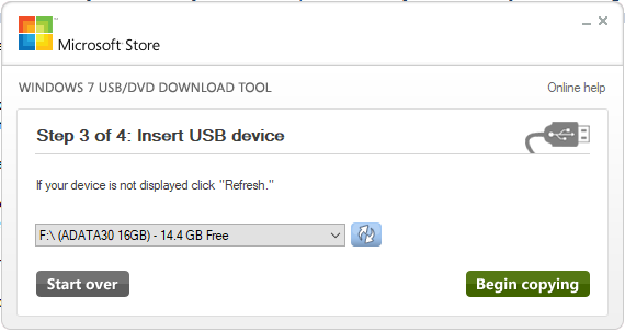

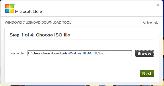

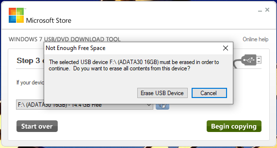

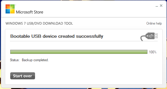

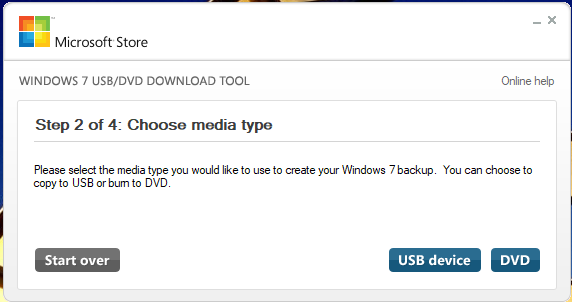

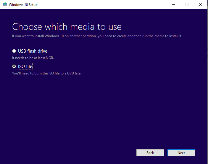

The ISO\Flash Drive stuff is actually fairly easy...
Windows 7 even has a tool to create one for your machine in addition to the RUFUS I mentioned..
Very easy to use...  https://www.microsoft.com/en-us/download/details.aspx?id=56485
My biggest objection is that it installs... The one from RUFUS does not...
I think the problem you had before with the Flash Drive was for two reasons...
You "Extracted" the ISO to the Flash Drive... That does not usually work... I have read where some people claim that is possible, but it worked for me maybe once out of 20-30 tries...
Mostly because the boot files are not correct when done that way...
The second problem may be how the Flash Drive was selected... I bet I went 8 years thinking my Gigabyte motherboard would not boot from a Flash Drive... I thought I had tried every possibility...
Then I stumbled across someone discussing this... There are two ways... Both require using Boot Options at the Gigabyte screen... Start hitting F12 as soon as you see Gigabyte screen...
Select +HDD which opens a menu that has a USB HDD, and select that...
Or even easier... simply select USB HDD at the first screen that comes up after hitting F12...
If you don't need to try this, that is great, but if you do, it's a simple (usually) thing to do...
When you boot with the Flash Drive, you also have access to multiple Repair Functions, and the Command Prompt....
A DVD will work too... Just slower...

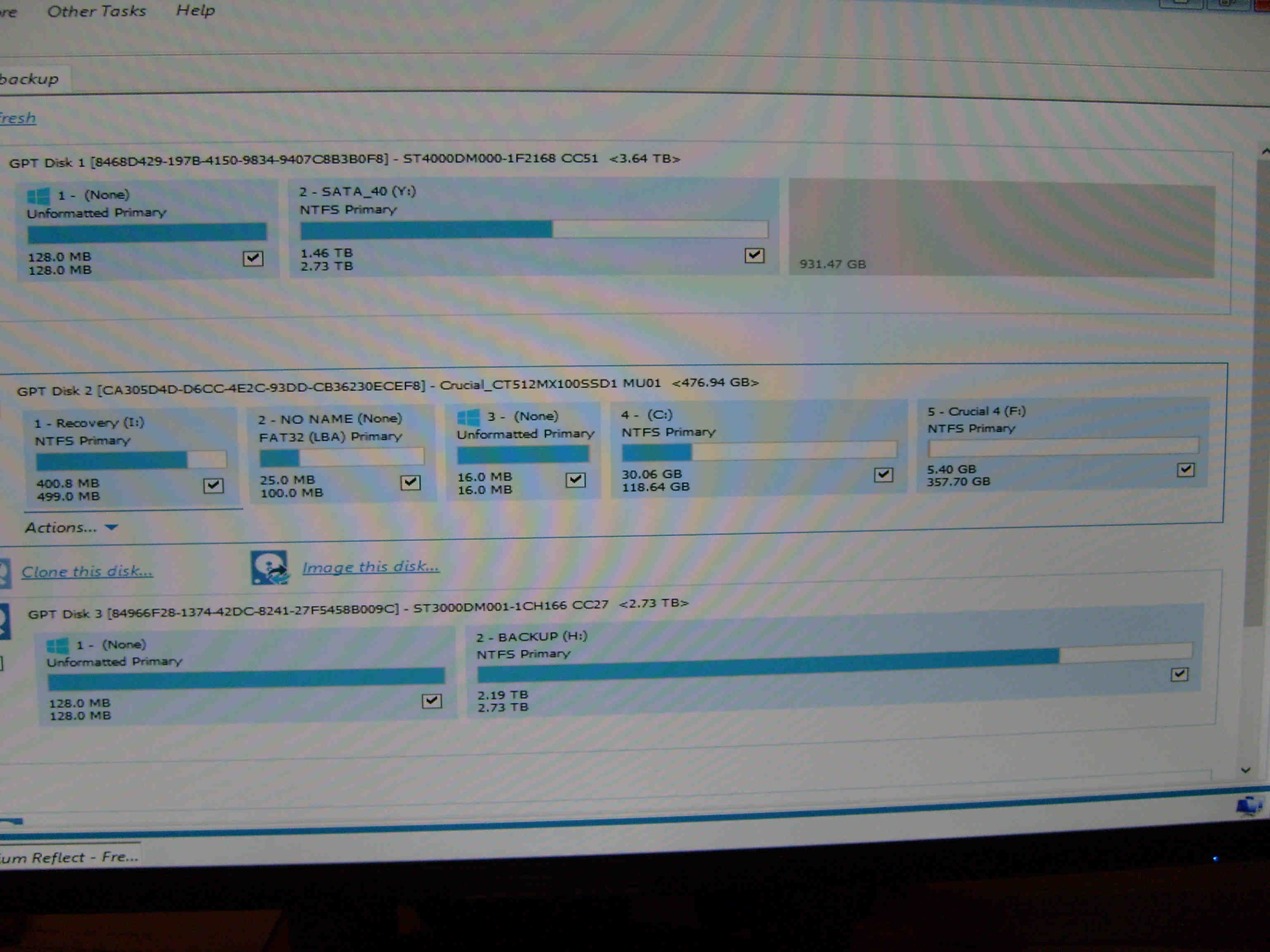

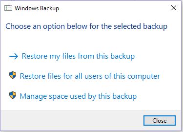

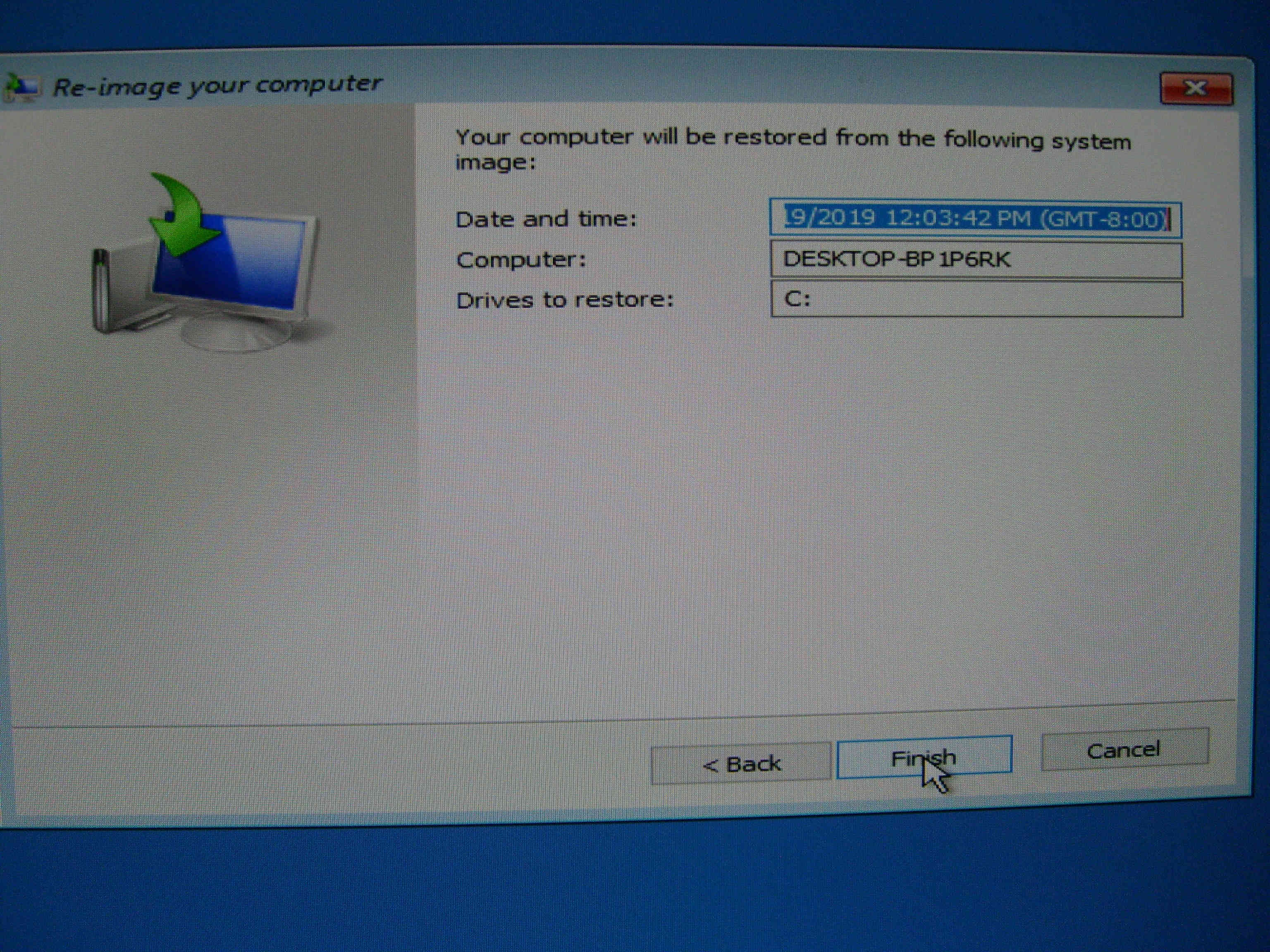

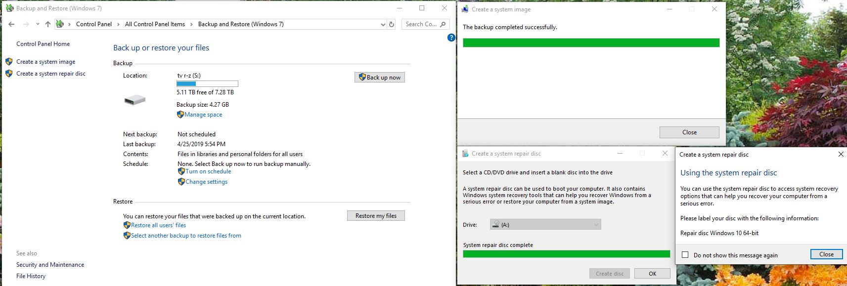

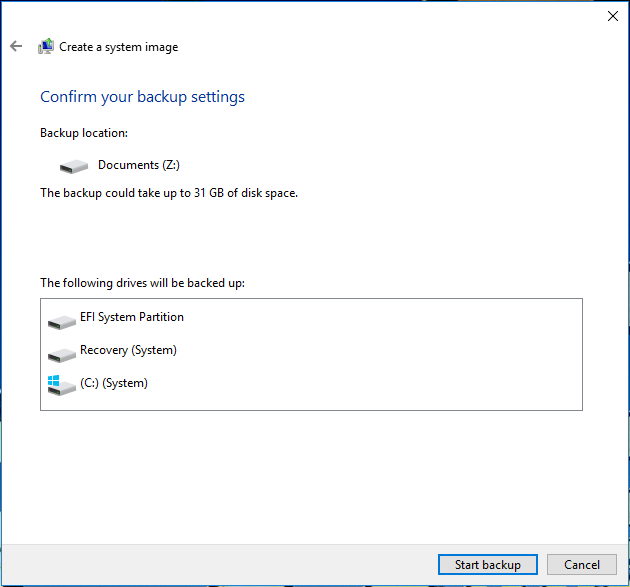

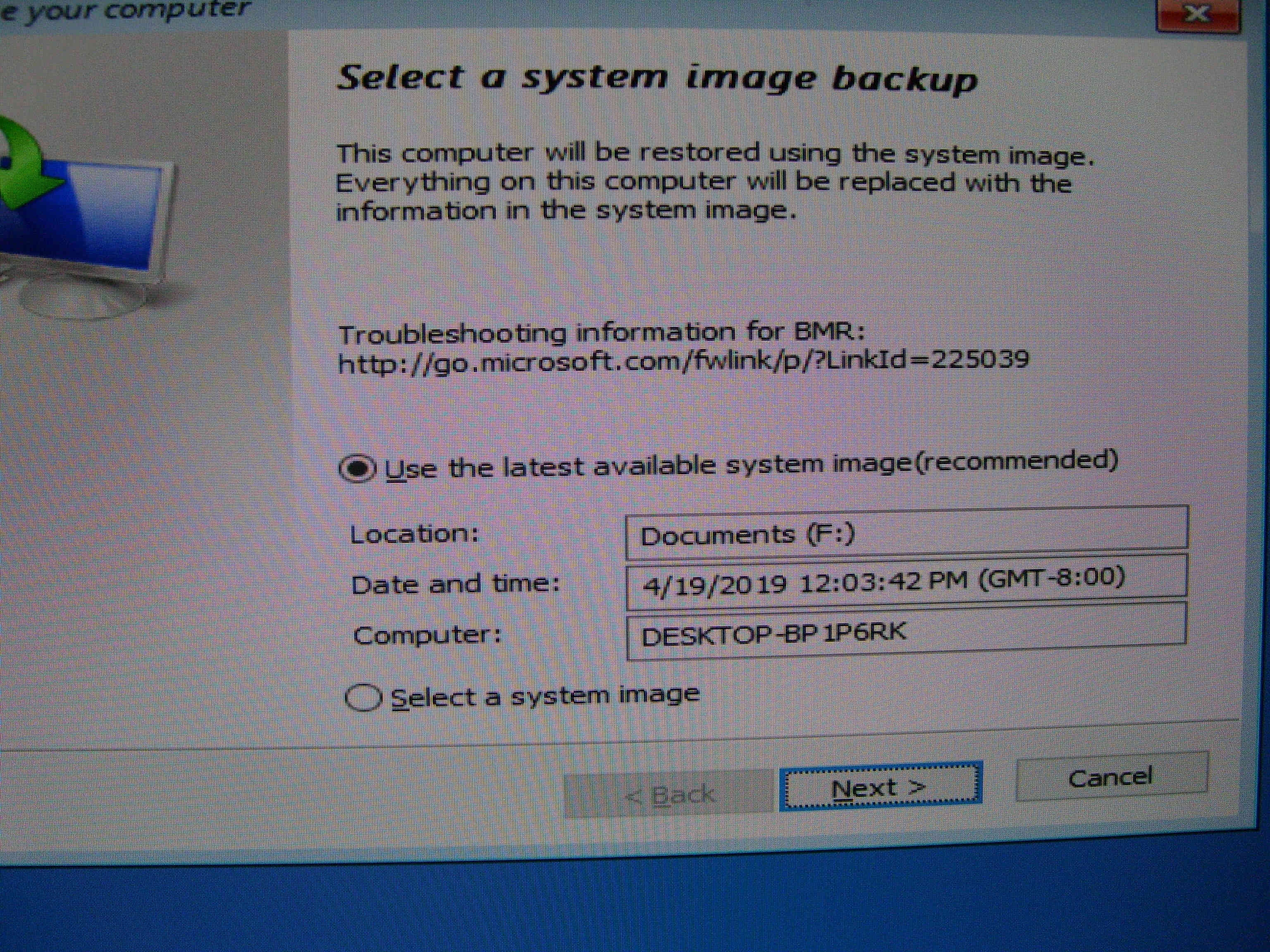

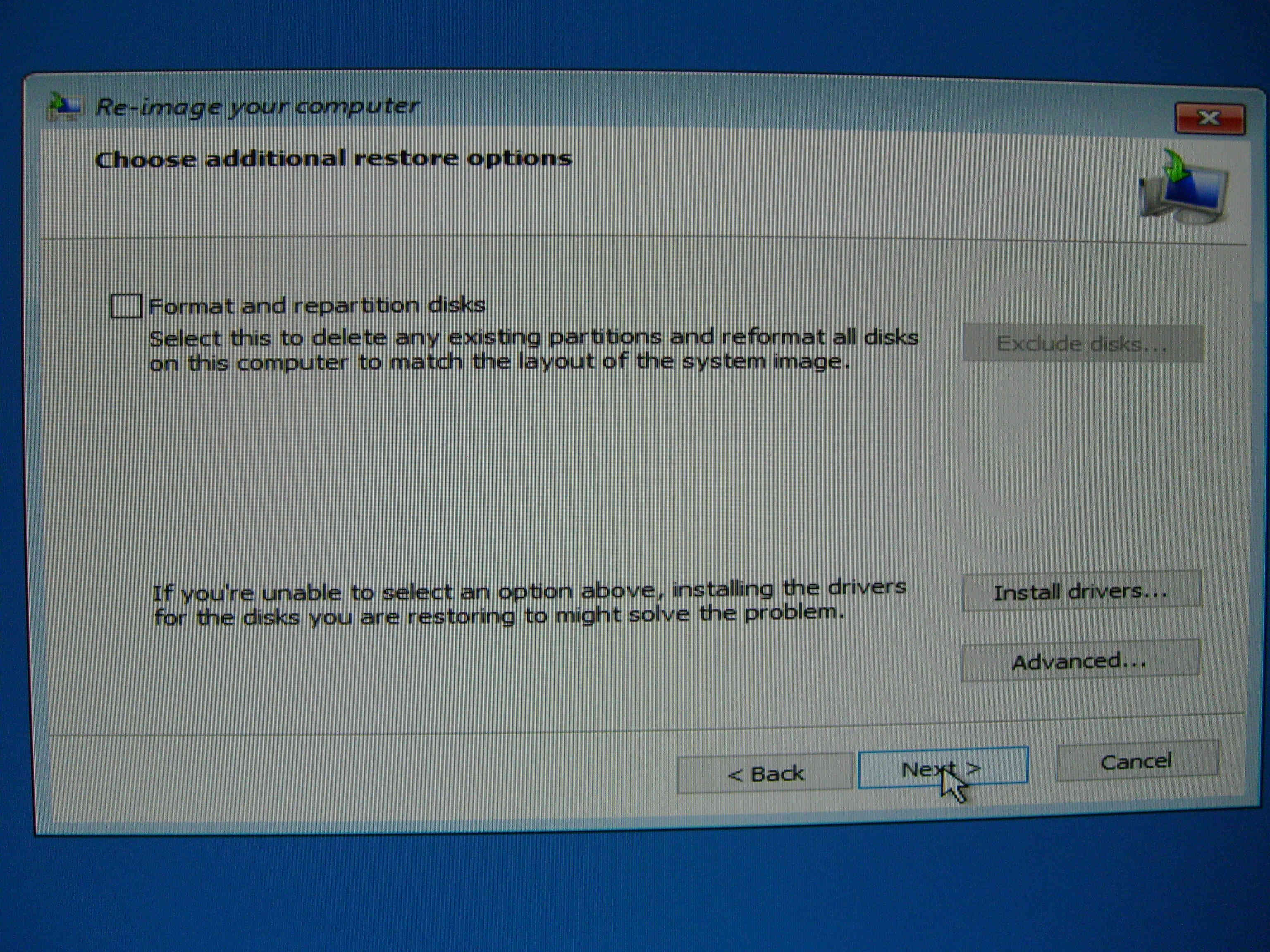

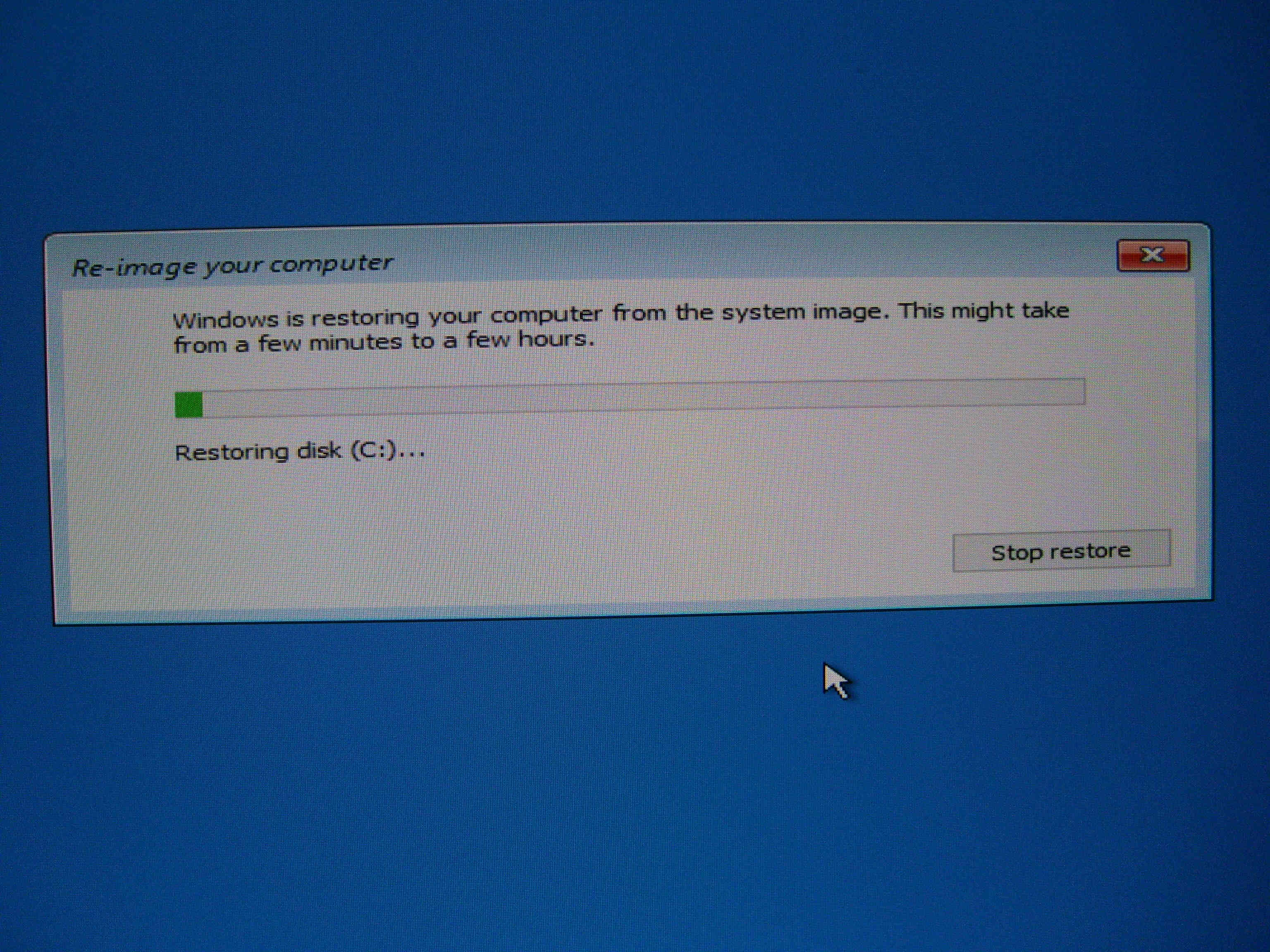

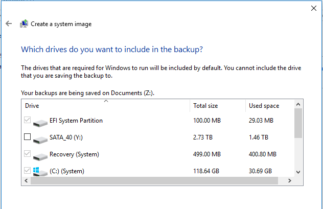

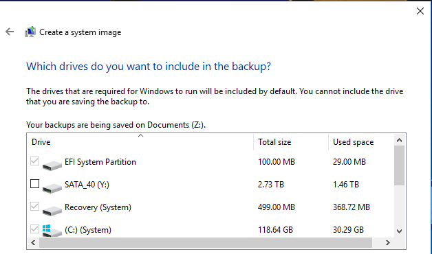

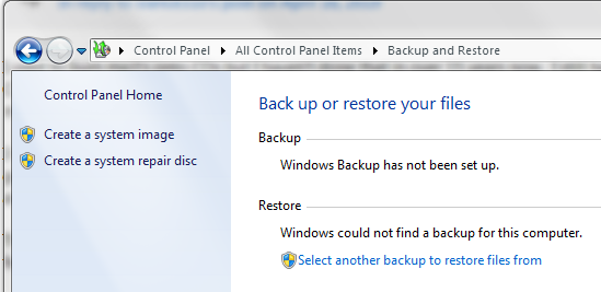

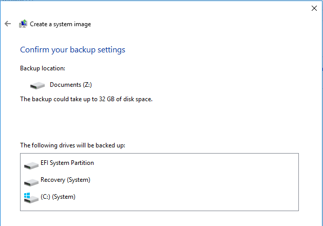

BTW... You mentioned System Restore not working as well as before, and I mentioned Acronis...
Acronis is nice to have, but Windows also has a built-in Imaging feature...
It is no longer supported, but works on most machines... especially those using Legacy Bios as ours do... You will need bootable Installation|Repair media to reload an image though...

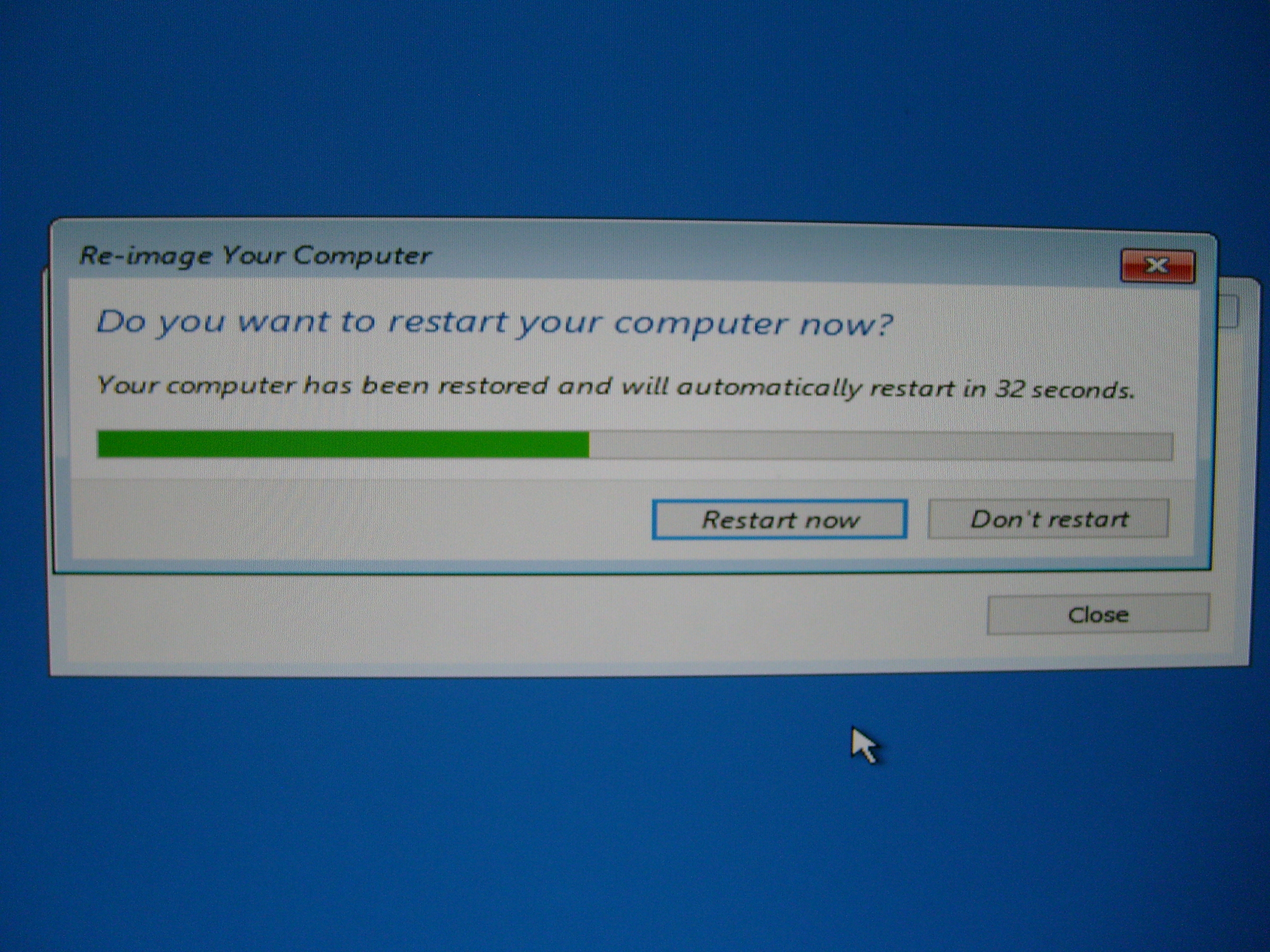

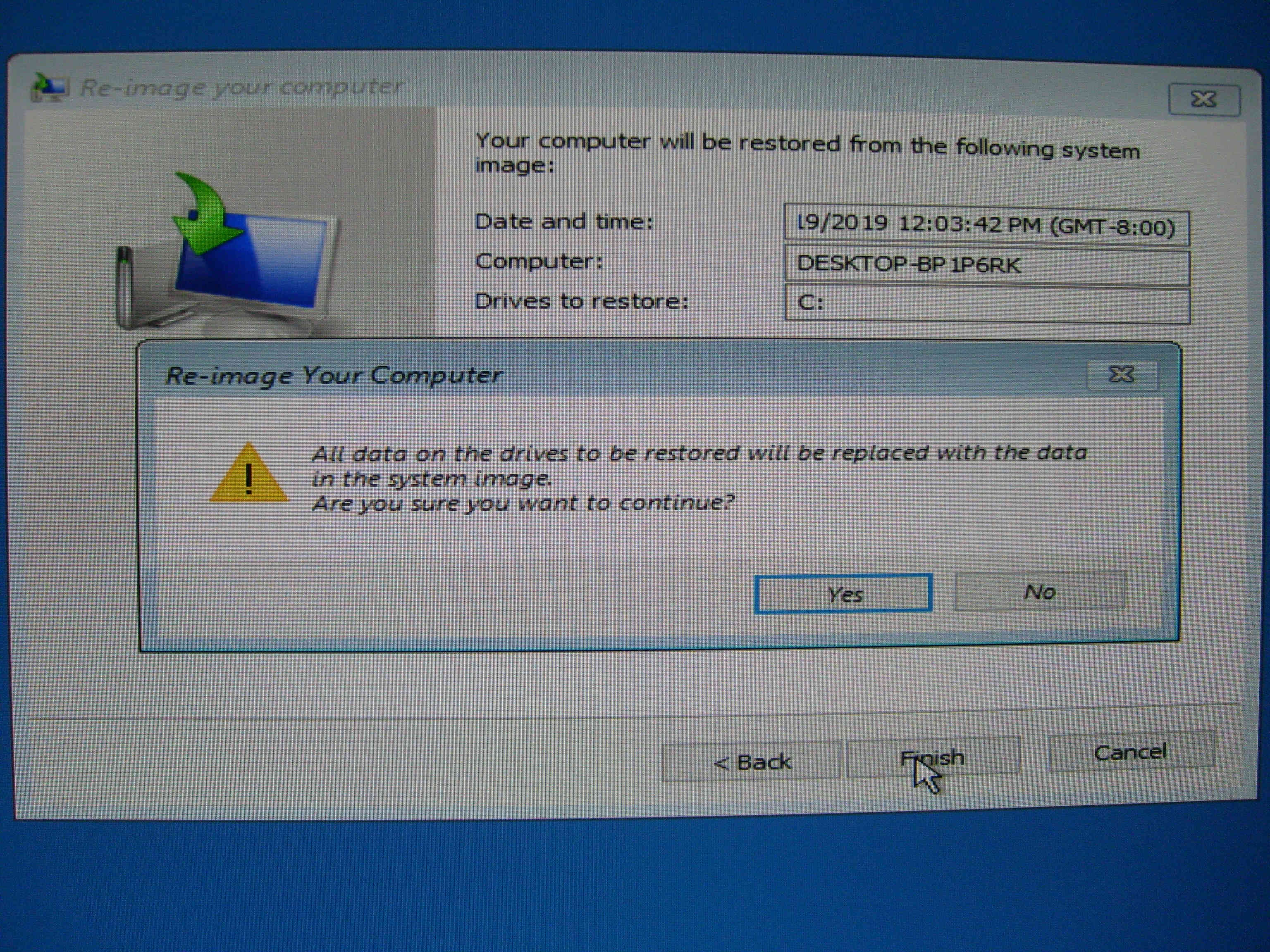

The Imaging tool will ask if you want to create a CD when it completes, or you can use installation media's Repair feature...
The tool basically takes a snapshot of your OS drive... Then reloads it if you should need it...
You can find it in Control Panel... It's called "Backup and Restore Windows 7"...
You can save the image to most any drive you choose...

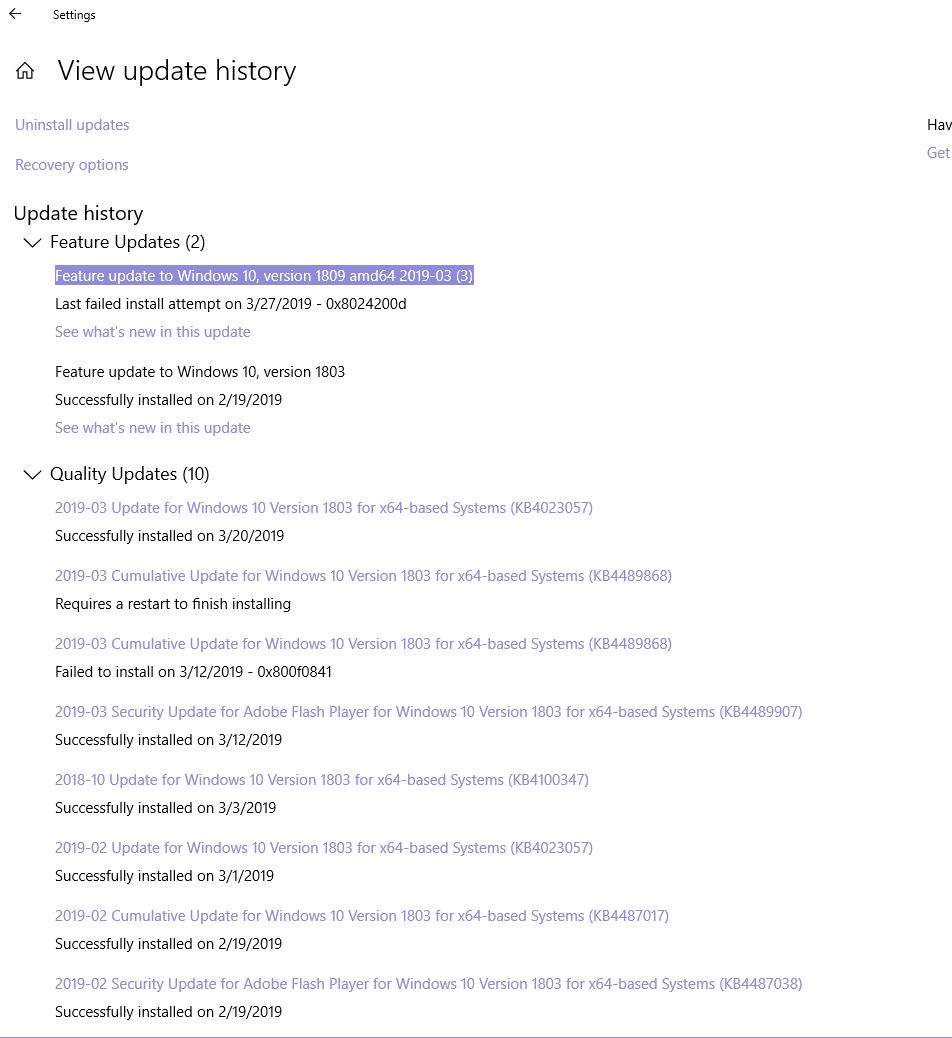

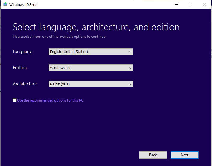

I can't guarantee that a fresh installation of Windows 10 would solve the problem...
You might have a problem with your OS hard drive for instance, but I think that would be a good place to start... There is a good possibility that it has become corrupted from all the crashes, updates , and etc...
If that is what you decide to do, you might as well download a new ISO... Your original 1803 version will immediately try to update to 1809... 1809 may then immediately try to update to the Feature Update that is likely to be causing problems...
1809 is the newest available for public download at the moment... There is a good chance it will actually update to a newer build during the installation if you have your internet connected...
1809 may download with the most recent update already included, but that is something I am not sure about... It may download October 2018 Update (1809) Build 17763.1... which is the original...
Unfortunately there is no way to tell until it installs...

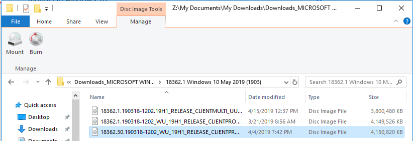

I just found out that the next Windows 10 version (1903) is not scheduled for release until the end of May..
Basically two moths late... So that is one less thing to immediately worry about...

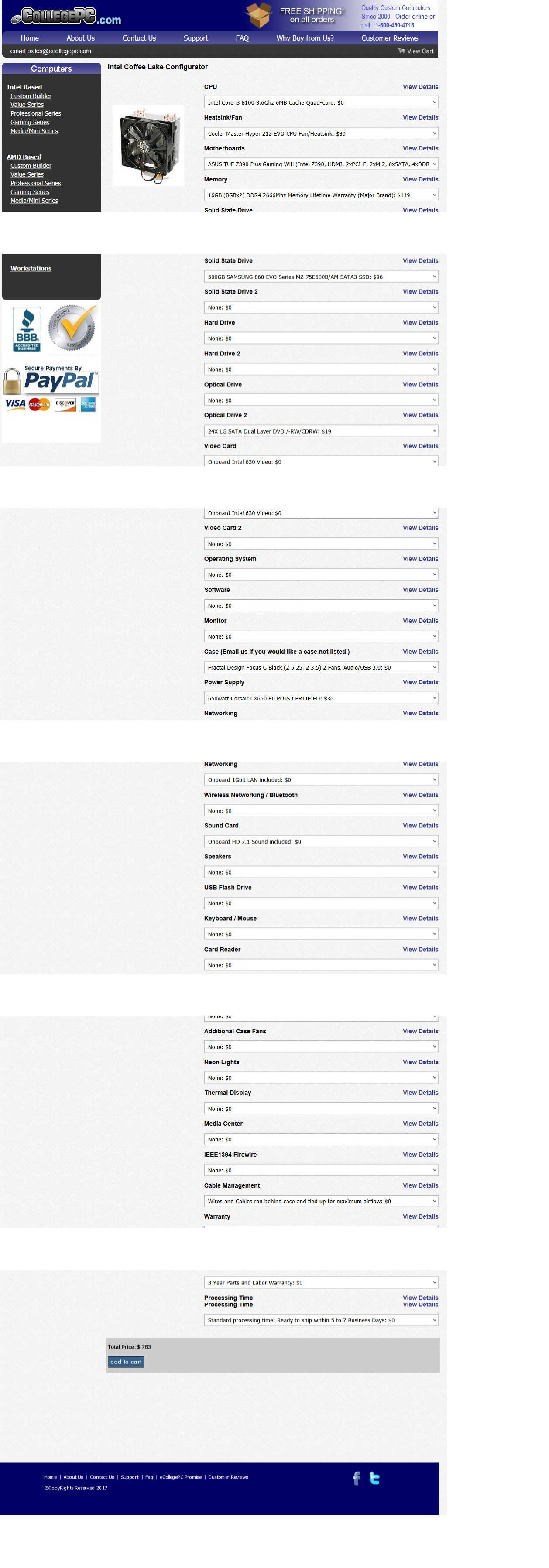

I did some checking on the PC's you are considering...
One thing I noticed is that they both use very small motherboards...
Your first link... the Intel i3, has a ASUS mobo with a limited number of slots and SATA connections...
The 2nd link... the Intel i5, has a Gigabyte mobo that is slightly larger, and has more slots and SATA connections... It also has a PCIe x4 slot with which you could use your I\O Crest SATA card.. The ASUS does not...
There is a big difference in price, partly because the first link does not have a HDD or Memory...
You will need memory... The stuff you have is not compatible with these machines...
The 480GB SSD is an off brand... It may or may not be OK...

Here are some quick notes I made about your links...
I've been looking at buying this pc, with a few upgrades to the PSU, fans and a larger hdd.  Would you give me your opinion about it?      http://www.ecollegepc.com/intel-core-i5-8400-cpu-professional.html
uATX MoBo Gigabyte B360M-D3H
PCIe x16... PCIe x16 @ 4...  1 PCIe x1...  1 PCI
6 SATA... 1 M.2
Inland Professional 480GB SSD... $50... Good price... quality unknown...
This case has room for 8 3.5\2.5 drives... more expensive...
Another one that I've been looking at is this one but it's more expensive and doesn't include RAM, an optical drive or a hdd.  They would cost extra.     http://www.ecollegepc.com/intel-coffeelake.html
Only 2 PCIe x1 slots.. 1x PCIe x16...
uATX MoBo ASUS Prime H310M-A  $71
Spec Not correct... Claims 4xDDR4 Slots... Only has 2xDDR4
4 SATA... 1 M.2
As far as your comment about not including RAM on the more expensive one...
I think you got them switched... The expensive one has RAM... The cheaper one does not, but will need it... The more expensive one is also the one that has a SSD...
The more expensive one has more Drive bays in the Case, more SATA Ports on the mobo, and possibly a PCIe slot combination that may work better for you if you should ever need your 8 port SATA Card..

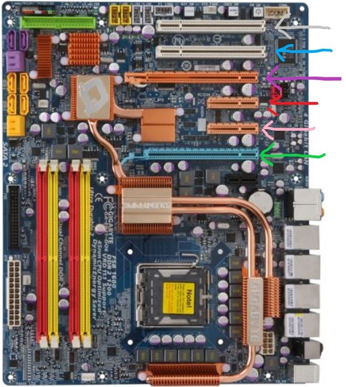

2019-04-06T02:57:32+00:00
It would be the large orange one with an extra tab like the one you are using...
Marked with a purple arrow in your picture...
There are two smaller slots in between the current 16x and the 8X...

SFC /SCANNOW would show any damaged Windows files, and may or may not fix them...
An ISO is simply an exact copy of a file... usually a CD or DVD... Very similar to creating an Image of your operating system drive...
If you extract one like you mentioned, it will not be bootable, but the files on it can be used for a In-Place Upgrade... Just run the SETUP file from within a functioning Windows...
There are free utilities to burn a ISO to a CD\DVD, but since you don't think that will work, we can do the Flash Drive...
First... download a free tool called RUFUS... https://rufus.ie/Select the "Portable" version...
Download the ISO from the Create Media Site....
If you already have the earlier (1803) ISO that you mentioned, you might also use that, and just be quick to block the 1809..
Second... Plug in the Flash Drive and launch RUFUS... Then just Browse to the location of your ISO...
Your machine does not use UEFI Bios, so you would select a "MBR" type drive...
This is what RUFUS should look like, except that the name of my drive and file will be different...

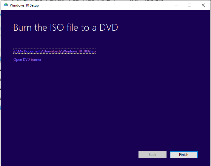

I forgot to post the link to the Create Media site...
http://www.microsoft.com/en-us/software-download/windows10
This will require downloading a tool that you will run to launch the media creation...
You will have a choice of a DVD, Flash Drive, or ISO... Personally I prefer the ISO as it is more versatile...
You can than burn it to a DVD with any Image burning tool, or to a Flash Drive with a free tool called RUFUS...
If you do this from a different machine, make sure you indicate that so you can choose the proper build and etc...

The thing is... Right now you are being pestered about Windows 10 version (1809)... Which has had issues since it was released.. It doesn't work too bad on my machine, but the Forum is full of people with problems...
In a couple of weeks or less, there is going to be ANOTHER new version...
Instead of the (1803) you started with, or the (1809) that keeps failing, this one will be (1903)...
I don't know if the final build of the version to be released to the public has been determined yet, but it is very close...

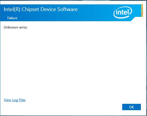

2019-03-29T01:00:51+00:00
I forgot to mention that the "Verifying DMI Pool Data said "Update successful."" means that your Bios Settings changed... Either to default or to a previous "working" setting...
This is either due to a hardware problem, or simply adding\removing devices...
Your getting too concerned about the adapter card... The drivers you used for your card worked fine... This stuff about the failed Feature Update AMD64 is confusing you...
This has nothing to do with your adapter... This is a completely updated new version of Windows 10 that was released to overcome a problem with a previous release involving AMD CPU's...
You have a Intel CPU... Which is why it makes no sense that it attempted to install on your computer..
But again... this talk concerning AMD and Intel has nothing to do with your I\O Crest SATA card...
It is all concerning motherboard issues...
Because it is for motherboard issues for a motherboard you do not have, I think it is responsible for your problems.. It certainly won't hurt to test your memory though...

That stuff about (1809)AMD has nothing to do with your PCIe card... It is concerning the chipset in use on your motherboard, which is Intel...
That was not a driver update for AMD... That was a entire new version of Windows 10... Probably a 3GB or so download...

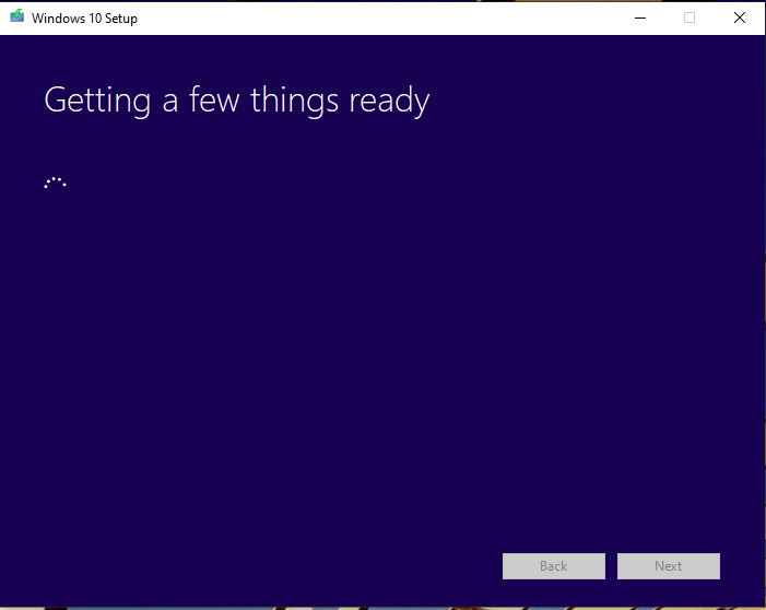

What the image you posted means is that the tool was unable to block the Windows Defender Update for some reason... It may have already been downloading at the time...
The "Feature Update to Windows 10, version 1809 amd64" is the name of the update that will appear in the Show-Hide tool...  Anything that mentions "Feature Update" is a version of windows 10... It appears as though it may have tried to install three times...
I'm not even sure why you are getting the "AMD64" version of this update... It was a updated build specifically to fix a AMD problem... Your machine is Intel based..
Hopefully the Windows Update DATA Base Error was the the cause, and has been fixed...
It also may be a factor in why you are having issues with the 1809 build... Or possibly the failed Upgrade caused the Data Base error in the first place...
The System Restore stuff works different now... I no longer use it..
For one thing, it is now turned off by default...
I found that creating a System Image with a bootable 3rd party tool works best for me...
An Image saves stuff that a System Restore may not... It is limited in what it actually saves for a Restore..
I personally prefer Acronis TrueImage... Unlike others, it does not need to be installed to create bootable media... The retail CD is bootable, and can be imaged to a flash drive fairly easily...
You need bootable media to restore an image anyway, and installing the program just clutters stuff up with a bunch of processes I don't like..
It is on special frequently for $10 after rebate... Otherwise it may be $40 for the basic single use version, which is what I use...

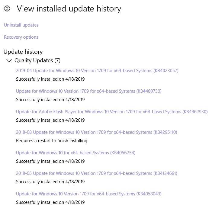

Those latest updates were rather "Major" updates... The one that failed is an upgrade to a completely new build released in October 2018... It has been problematic from the very start, to the point that Microsoft pulled it shortly after the release to the public...
You should be able to block\hide it with the Show-Hide tool... That is the primary reason I use it, to block new builds when I am testing an older one...
The "Manual (triggered)" for Windows Update is the default, and is "triggered" by processes in the
"Task Scheduler".... It's basically the same as "Auto" in the way it actually works...
I don't know if the damage can be undone from the update... Did you reload a backup image or something the last time ? If so, I would unhook your internet connection to buy time to deal with the update, before reloading it...
EDIT... The second link was bad as well... I don't know what is going on with that... It was in English when I saved the link... Anyway... I deleted it, and the direct link downloads in English...

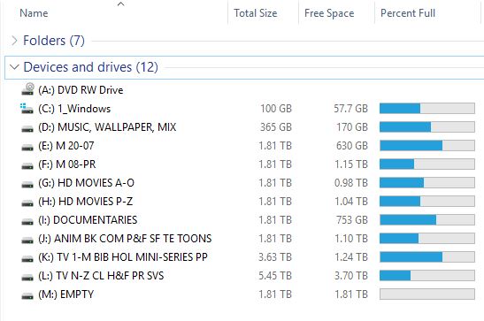

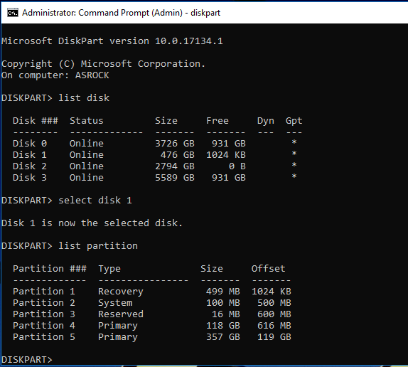

I'm glad your HDD is working... The reason you were told it would not support over 2TB may be because of XP\Vista\ Win 7 before SP1 may not have supported the GPT type partitioning..
That pretty much started with the introduction of UEFI Bios around 2010...
Our machines we have been discussing do not support UEFI Bios, but seem to support the GPT...
Windows 7 SP1 supports UEFI, but I don't know when that actually started...
I don't actually remember when I started seeing the "GPT (GUID)" option appear when initializing a drive...

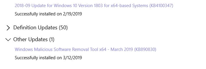

For your Windows Update... You can go to Windows Update and select "View Update History", but it doesn't give a definitive time... It does list the Updates in Order and states whether they were Successful or Failed...
If you go to "Programs and Features", you can also select "View Update History" there...
This has a different manner of listing... Like Windows 7...
Some updates can be uninstalled here, and some can not...
There is a tool that can be used to block\hide specific updates... It is not 100% effective, but works more than not... This doesn't install... Just runs from memory...
At the bottom of the provided link is a tool to "Show-Hide" Windows Updates...
You can use this to block most all Windows Updates and\or allow the ones you want...
When I use this I set Windows Updates to Disabled in Services, and stop the service to prevent anything from starting before I'm ready... At times I even resort to disabling my internet adapter in Device Manager...
Everything must be enabled to run the tool though... Just don't Start Windows Update in Services... The tool will do that..
When you run the tool, be sure to click on the Advanced at the bottom and uncheck the box to "Apply Repairs Automatically"...
Blocking the updates will allow you to easier diagnose the problem by allowing just one at a time to install...

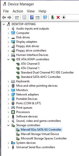

Take a look at the reviews at NewEgg for this card... Especially the first couple...
Also take a look at the Overview...
More info than the manufacturer's website...
https://www.newegg.com/Product/Product.aspx?Item=N82E16816124070
The reviews state NOT to use the included drivers, but to let Windows take care of it...
One person states that there is a specific sequence that needs to be followed when hooking up the drives to get all 8 to work...
The Overview states that 3-4TB GPT drives are the maximum size supported if I'm understanding that correctly...Max
And check out this specific review...
https://www.newegg.com/Product/SingleProductReview.aspx?reviewid=4399846

I can't guarantee it, but I can find no reason your motherboard would not be able to use over 2TB drives...
I'm also not sure what you mean by pciex adapter cards... It;s probably just the terminology... I simpy call them PCIe... I found a number of them with a quick search...
I would not worry about the Windows 10 Compatibility... I have not had problems with any of my add on cards running Windows 10...
2019-03-22T22:06:15+00:00
I suspect that maybe one of your SATA cards may be the problem, but it could be a memory stick you haven't tried yet...

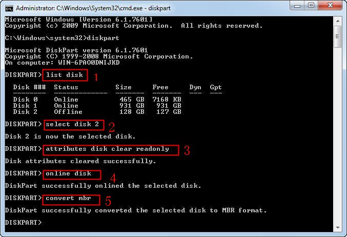

Most importantly concerning your HDD size... You should be able to run a HDD larger than 2TB...
I have a similar Gigabyte EP45-UD3R motherboard with the same Intel Chipsets...
I am currently running a 3TB and a 4TB drive on it, along with a 2TB and a 120GB SSD...
The trick is that the HDD over 2TB needs to be "Initialized" as a "GPT (GUID)\NTFS type drive, instead of the traditional MBR\NTFS...
I will check on your motherboard for any restrictions using a GPT drive, but I doubt that there is...
This is more of a Windows Issue than a motherboard issue...

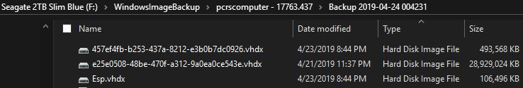

    2019-04-30T02:40:54+00:00
    Thanks for that & the other experiments you've been doing. I am overjoyed to hear it for my sake & all UEFI people. Is it too late to switch Denise to UEFI? I think she balked at a new clean install earlier in the thread, though. I think all else you have done in her case is phenomenal. I could never have done that hardware stuff. And I dread the day I must open this laptop of mine, although a while ago I did download & print my Inspiron 3542's Owners Manual.

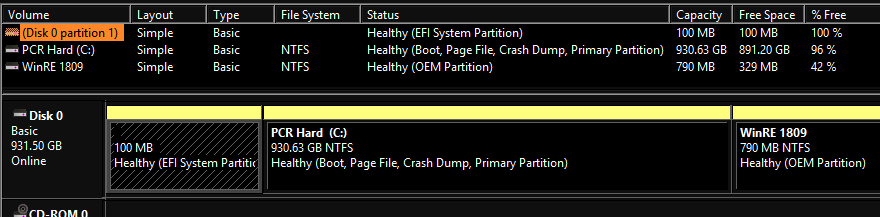

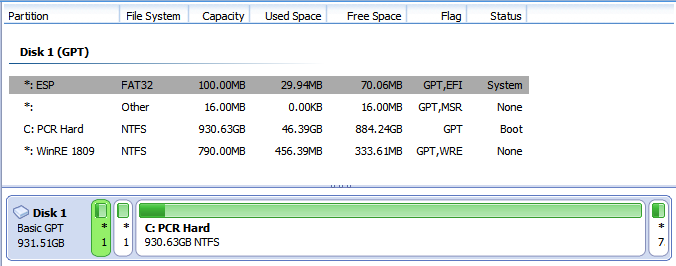

    I made a discovery about the matter where I see only 2 partitions offered for restore. Thanks for your response in that matter, it is what me look again. It offered EFI, & - you are right - the one named "\?\Volume(457ef4fb-b253-437a-8212-e3b067dc0926" is the Recovery partition. The one not offered is C: ...!...
    But it only happens when restoring (not that I complete the restore) from the copy I made of a WindowsImageBackup folder from one external drive to another. After making the copy...
    (a) I did make another image into it to see one last futile time whether it would cause two to be offered on restore. Only one was offered as usual. The imaging did complete very quickly, almost too quick to be real.
    (b) I then renamed the computer folder to "PCRsComputer - 17763.437" & made another image into WindowsImageBackup. This was the result...
    So -"PCRsComputer - 17763.437" is the copy plus one incremental, which explains differences in dates & some file sizes from the original which was...
    But the original & the copy both have identical sized .vhdx files (which actually are the 3 partitions)...
    Anyway, the original offers all three to restore. The 2nd image I made into the copy of WindowsImageBackup after renaming the computer folder also does offer all three. It's just the renamed one that offers only two.
    I'm going to...
    (a) Delete the copy of WindowsImageBackup from Slim Blue.
    (b) Copy "WindowsImageBackup - 17763.437" over to it again.
    (c) Maybe put an incremental into it (that's what happens when a 2nd image is made w/o renaming anything 1st)
    (d) Check how many partitions are offered - if less than 3, then copying must be forbidden.
    (e) Rename the computer folder, & make another image into the copy of WindowsImageBackup.
    (f) Check how many partitions are offered by the renamed one - if less than 3, then this method to have multiple images is no good.
