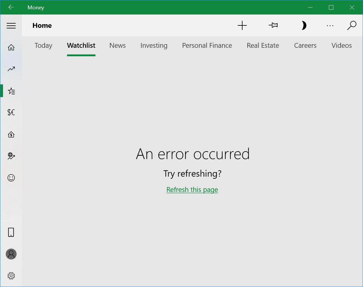

Also,
Downloading and updating Store apps issue also say
"We couldn't install, we would try shortly"
