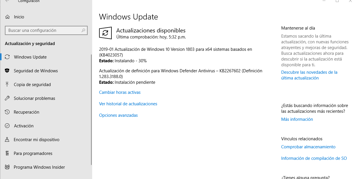

2018-11 Update for Windows 10 Version 1803 for x64-based Systems (KB4023057) - Error 0x80070643 - This just showed up today. (1/16/2019)  I have tried 4 times and each time it won't install.
However, when I looked at update history, I see the following:
2018-12 Update for Windows 10 Version 1803 for x64-based Systems (KB4023057)  - Successfully installed on 1/12/2019
So why is Windows Update trying to install an older version of the same file?  And if it should not be doing this, how do I make it stop trying?

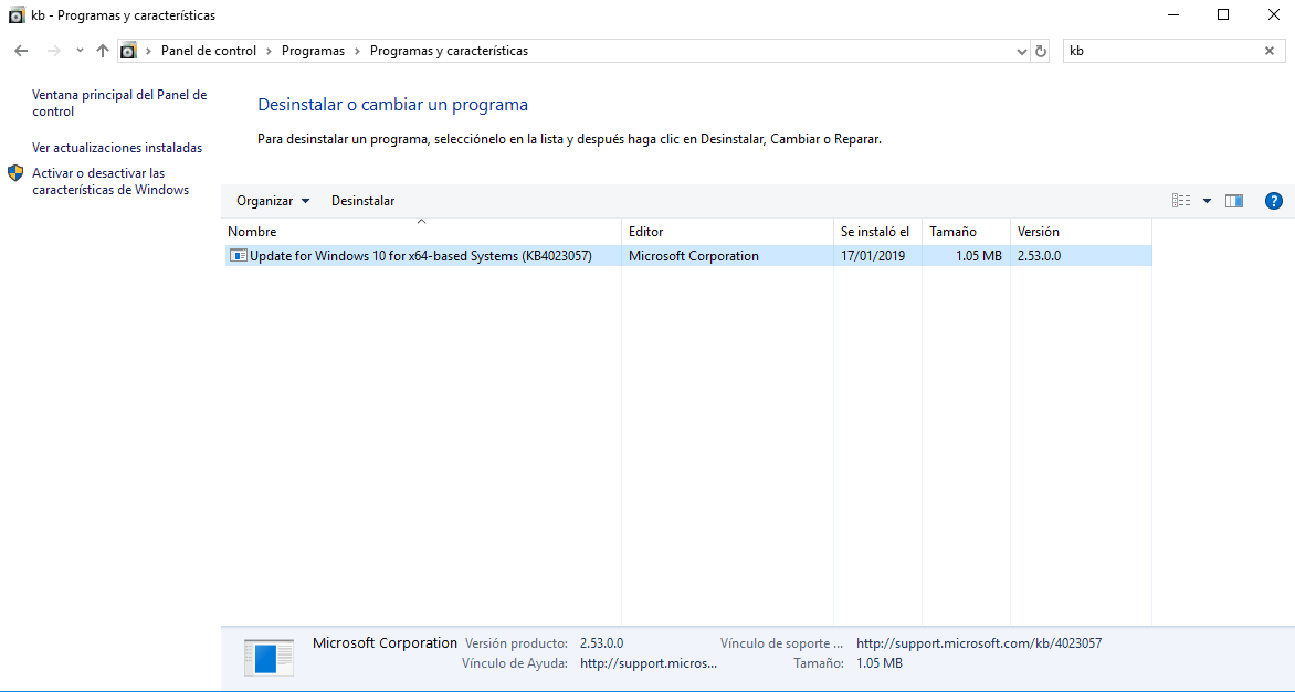

UPDATE (19/1/19): If you're getting 'System error 5 has occurred, Access is denied' while trying above mentioned steps, you need to first uninstall KB4023057 from Settings app > Apps > Apps & features and reboot the machine.
Then you can successfully install the update KB4023057 again, using Windows Update feature. This worked out for many users, so you can give it a try!

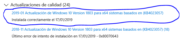

I would say, the marked answers aren't catching the issue. Error 0x80070643 raises due to the fact, that an older version of KB4023057 has been installed already.
Solution: Uninstall  KB4023057 via the App list, reboot and then it should install. See also the remarks within my blog post:
Windows 10: Update KB4023057 re-released (1/16/2019)
2019-01-19T04:27:13+00:00
Well, after I thought it was fixed, it came back again.  So I did the uninstall thing in Apps and Features, rebooted, told Windows to see if there were any updates, and it found the new 1809 update.  After that, it seems, so far, to be fixed.
