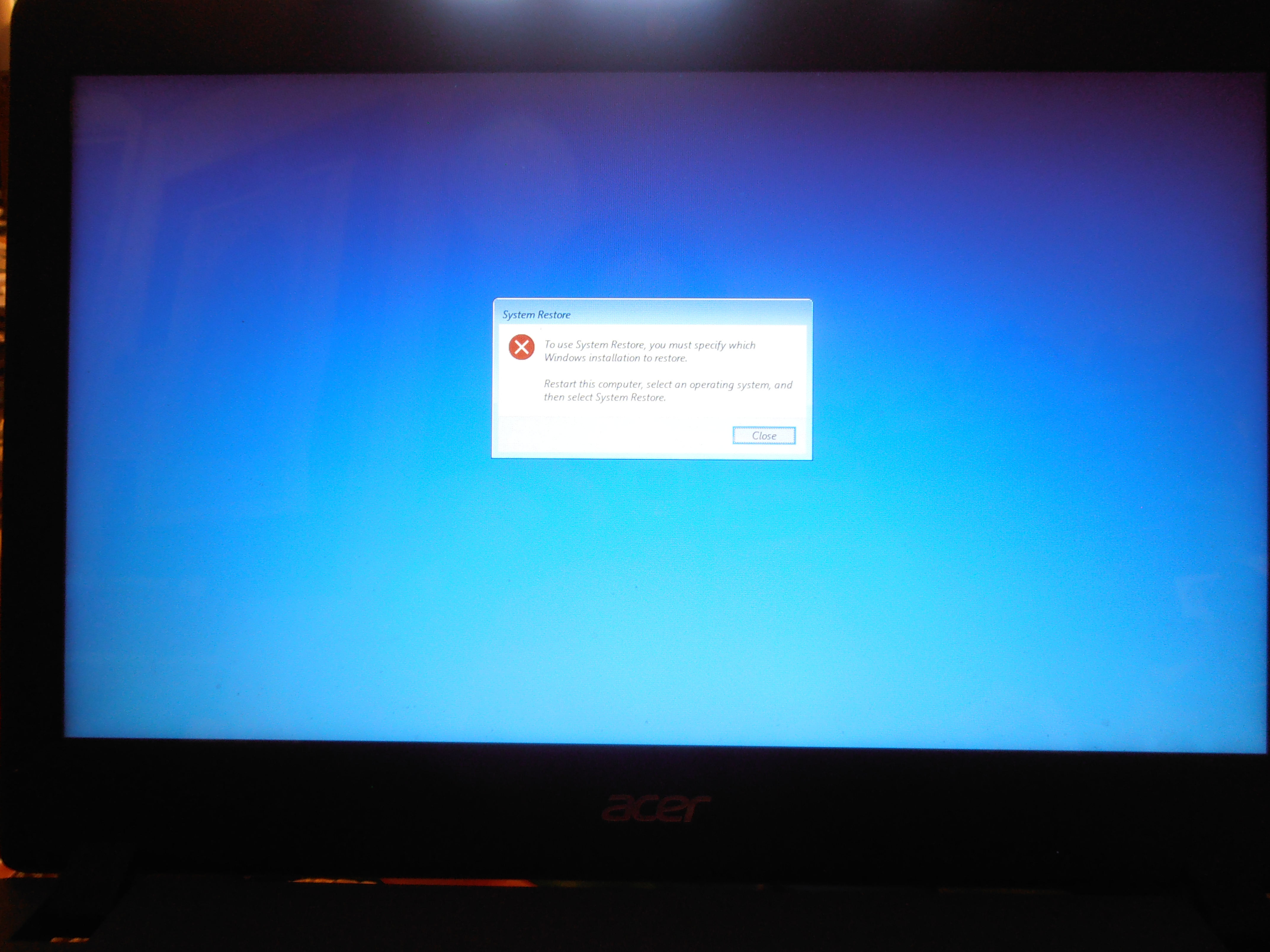

    I did try the above but I got this:

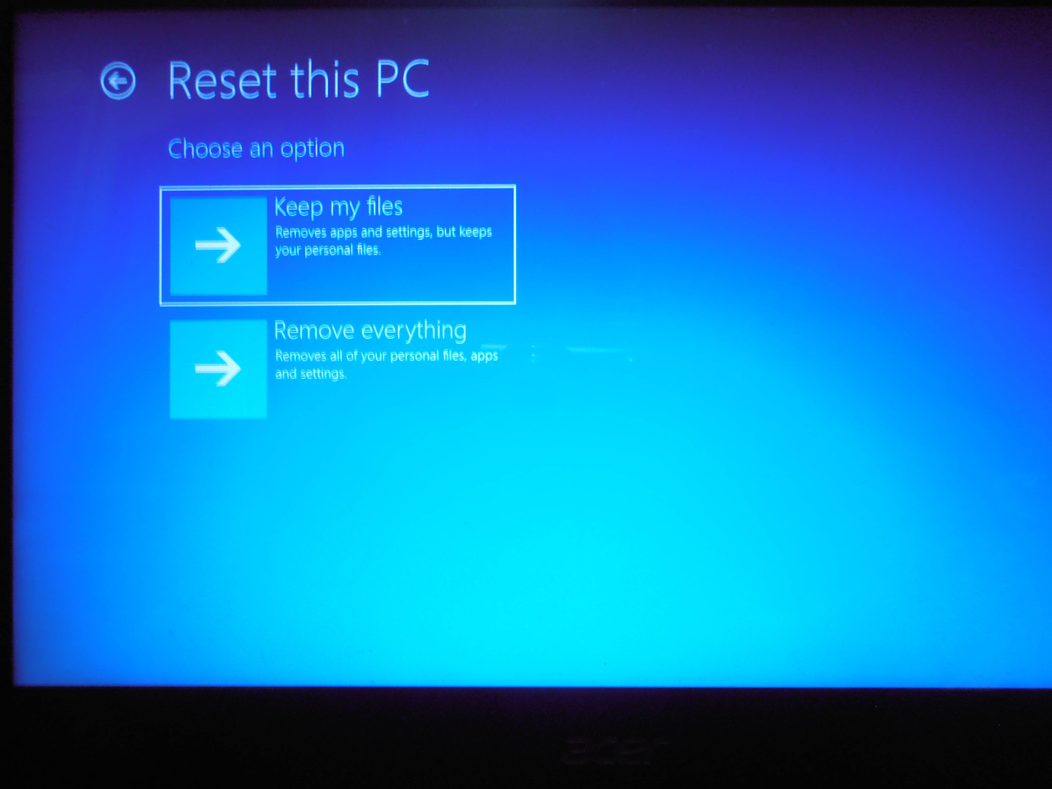

    Then I tried this:
    2018-12-07T12:39:23+00:00

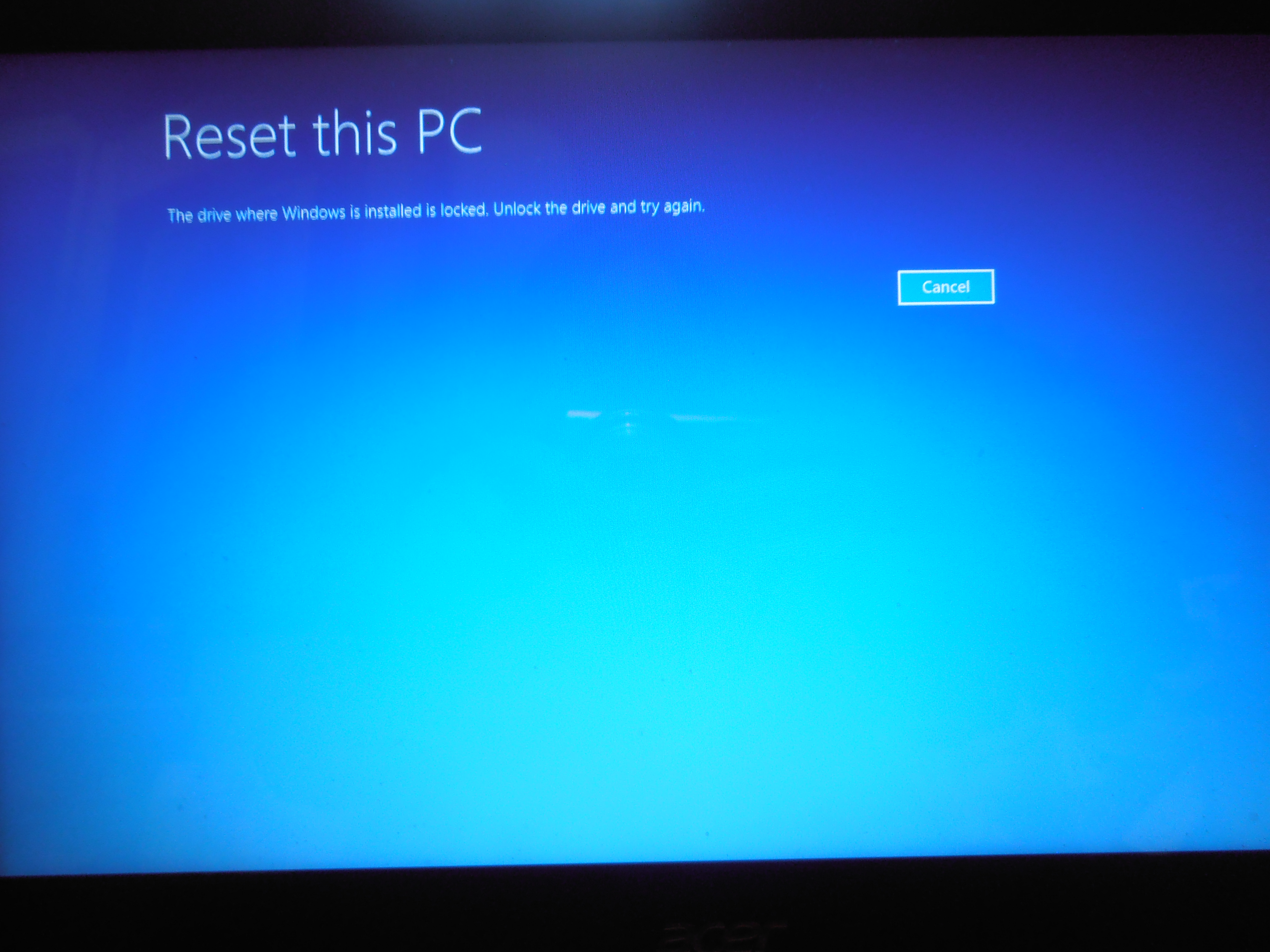

    and got this:
    2018-12-07T22:12:01+00:00
    Do you have BitLocker turned on or something ? I am not sure why it would be locked...
    As far as copying your data... Just select the Command Prompt appearing in the Advanced Options of the first image you posted with the System Restore selection you tried...
    Enter Notepad and hit enter...  When Notepad opens click on the "File" tab, then open... You will see a somewhat normal Windows Explorer screen from which you can copy\paste just like from within windows...
    Like what is showing in the very first image you posted...
    If the drive is still locked this may not still work... If that happens try creating a bootable Flash Drive with Parted Magic...
    Here is a link to the one of the newest ISO downloads.... I am trying it now...
    If it has a problem I will let you know...
    A free tool called RUFUS will put it on a flash drive...
    2018-12-08T02:04:32+00:00
    I see that I forgot to post the link... Good thing... it would not boot...
    Here is a link to an older version that will work...
    https://www.majorgeeks.com/files/details/parted_magic.html
    If you want to try and repair your current installation there are a couple of commands that might work...
    Regardless as to how you end up using the installation media, make sure you are booting from it in "UEFI Mode"... "UEFI Flash Drive" as opposed to simply "Flash Drive"... You can make this selection in Boot Options...
    This would normally require hitting something like F9, F11, F12, or whatever your machine uses... at the manufacturer's screen when you first boot...
    My Tablet requires that I push and hold the Volume - while then pushing and holding the power button... This actually generates an error, but gets you the screen where you can select the boot device...
    Not choosing the correct "UEFI Mode" MIGHT trigger the "Locked Drive" error message you are getting...
    Once you do this, open the command prompt in Advanced Options and enter these commands...
    BOOTREC /FIXMBR, and then press ENTER.
    BOOTREC /FIXBOOT, and then press ENTER.
    BOOTREC /REBUILDBCD, and then press ENTER.
