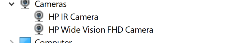

    I had this same issue. The root of the problem seems to be your (by your I mean you the reader in general and not just the O.P.) system having multiple devices that fall under camera/microphone. For example someone here mentioned having a bluetooth device with a microphone that they removed as having solved the issue for them.
    In my case, under device manager I have two devices under cameras: the regular camera and an IR camera/sensor. After disabling the IR camera I stopped receiving the error.
    So with that being said the solution I would suggest if none of the other suggested solutions worked for you is to check to see if you have more than one camera and/or mic sensor, then try disabling whichever ones you don't need.

    2019-05-28T05:37:06+00:00
    Thank you so much! Disabling the IR camera didn't immediately solve the problem - but it led me to notice that Messenger was auto selecting a certain camera from the options within Chrome itself. The camera and microphone drop down menu within the Messenger call was unselectable, so I couldn't change the camera Messenger was attempting to access - so I looked in the Chrome settings, and, alas, a camera option by the same name was there. By activating that camera option (instead of the normal camera that was selected previously) and restarting the browser, everything is working now!
    Interestingly, now, in the Chrome settings, there is only one camera option, just the normal camera (which was selected before...). So I don't have any record of what I changed it to to fix the problem, unfortunately.

    2019-06-28T13:21:18+00:00
    I am having this same issue. My FB comes up with two devices, one is the HP camera and the other is AV Stream Media Device.  I don't know how to get rid of that!

    2019-07-15T22:31:18+00:00
