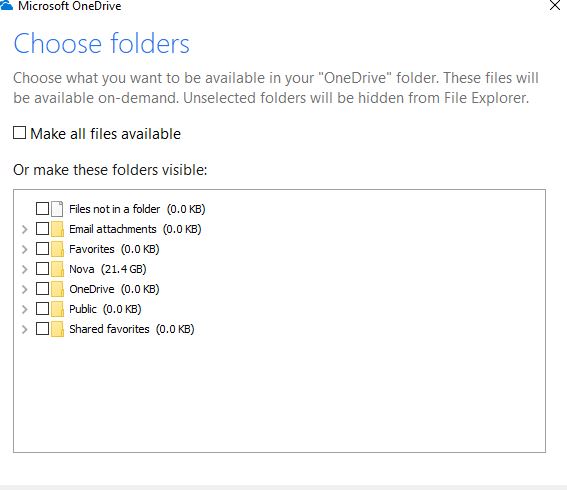

    The one drive on both machines are set like this:
    I did some more testing:
    All Cloud Settings where set to not visible and this worked.
    1 Set target Desktop Cloud Settings to all folders visible and it worked.
    1. Set source Laptop to Cloud Setting to all folders visible and backup failed.
    2. Set source Laptop to Cloud Setting to all folders not visible and backup completed.
    Time for Microsoft to fix this issue whatever it is.

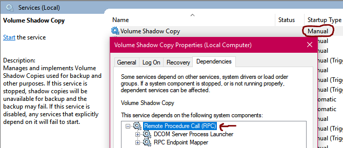

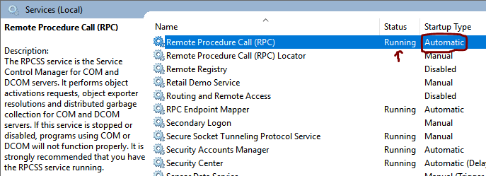

    5 Yes volume shadow copy is set to manual. RPC is running and automatic

    I tried to run the backup with the boxes shown above unchecked and the results were the same, same error code. No change.

    The Volume Shadow Copy and Remote Procedure Call is that same as your views.

    (6) I think it is a problem with the making of that shadow copy that is thwarting Backup & Restore for you. But your Services settings seem OK. More study is required.
