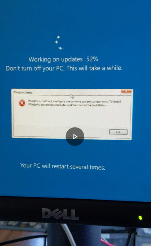

When the update was downloaded and prepared , it called me to restart the computer to install 1809 update . However, until 52%, it said that "Windows could not configure one or more system components. to install windows restart the computer." After it restore the system, i check out the update record and find that the error code is 0xc1900101-0x30018. What should i do?
P.S. I have fix windows update errors by using the dism and system update readiness before.
