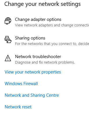

    In settings at the bottom of the network Status screen, use the Network reset. (click network icon in tray and click on Network & Internet settings)
    Just make sure to save your work because Windows will restart.
