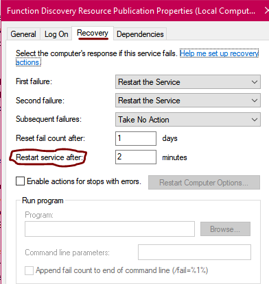

    (7) I do think you & Plarini have proven the problem is with that Function Discovery Resource Publication (FDResPub) service. We'd need to figure out why yours isn't restarting on its own. But I don't think the fix you do is so bad, really. Here is the setting at its Recovery tab...
    The question why does it need a restart, when I look at FDResPub it is up and running after a reboot.
