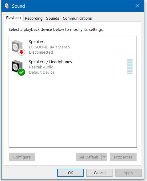

    2018-11-25T21:05:31+00:00
    I am having the EXACT same issue. My LG Sound Bar used to work just fine with my Dell laptop although I am uncertain when this fallout has occurred as I use the LG Sound Bar only infrequently with my Dell laptop, but I would like the option for future uses.
    Now, it says "Paired" on both speaker and Windows 10 and yet sound doesn't come from it, still laptop speakers. I have disabled MS Enumerator and LE Enumerator as other troubleshooting forums have suggested (since been re-enabled as they didn't help). I have uninstalled Bluetooth driver and rebooted for a fresh install of native driver. I even had high hopes when I went to Dell and obtained Bluetooth driver dated 11/06/2018. And yet, under "Sound" properties, and under the "Playback" tab, my "LG SOUND BAR" is listed and yet shows "disconnected" with NO OPTION to attempt to connect it. I tried using the "Sound Troubleshooter" and it says the device looks to be unplugged, which obviously is untrue as it shows "paired" on the speaker, and "connected" under Bluetooth properties Windows 10
